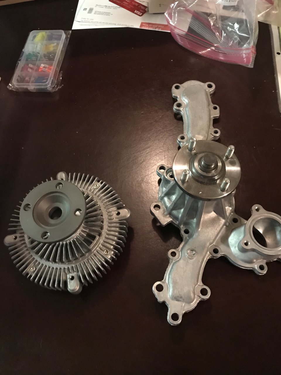

    Scored a brand new aisin pump for 60 on Amazon. Going to be tackling this next week
