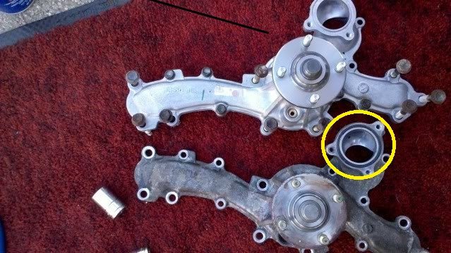

    Does anyone have the part number for the front water pump gasket circled in yellow? is this the fel pro 35654 that has been mentioned in this thread?

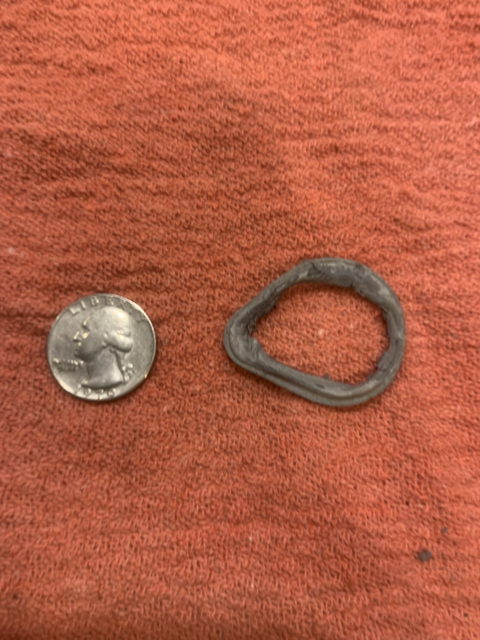

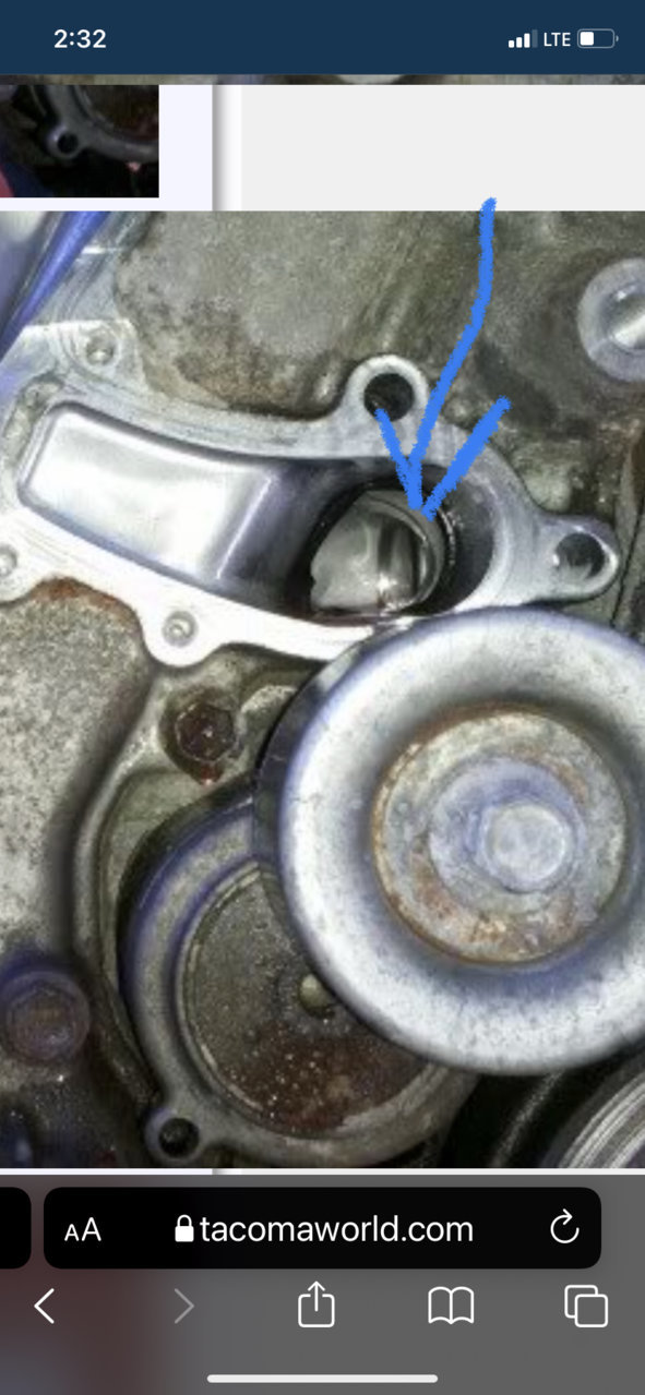

    Hello all. Just finding the forum. I’m in process of replacing the original water pump in my 2008 v6, 303k miles:). Thank you to 05sctaco for starting thread almost 10 years ago, as well as all of the replies- very helpful! I wiped out the right side of pump last before starting reinstall of new pump and an odd shaped off white rubbery gasket came out on my rag… looks like the edge of it in 05 s taco’s pic (trying to upload) Question is, what is it and does it need to be there or need to be replaced? I’m at work now so don’t have pic of what came out but will try to take pic of it tonight…thanks in advance!

    I would wait for it to leak on a trail

    10B4A917-3352-4D9F-8232-3492B8566ED4.jpg Thanks guys. Here is the pic of what came out. I haven’t started to install new pump yet as I’m not sure whether this should be stuck back in there or just left out…..can’t see that it’s serving any purpose but ‍♂️

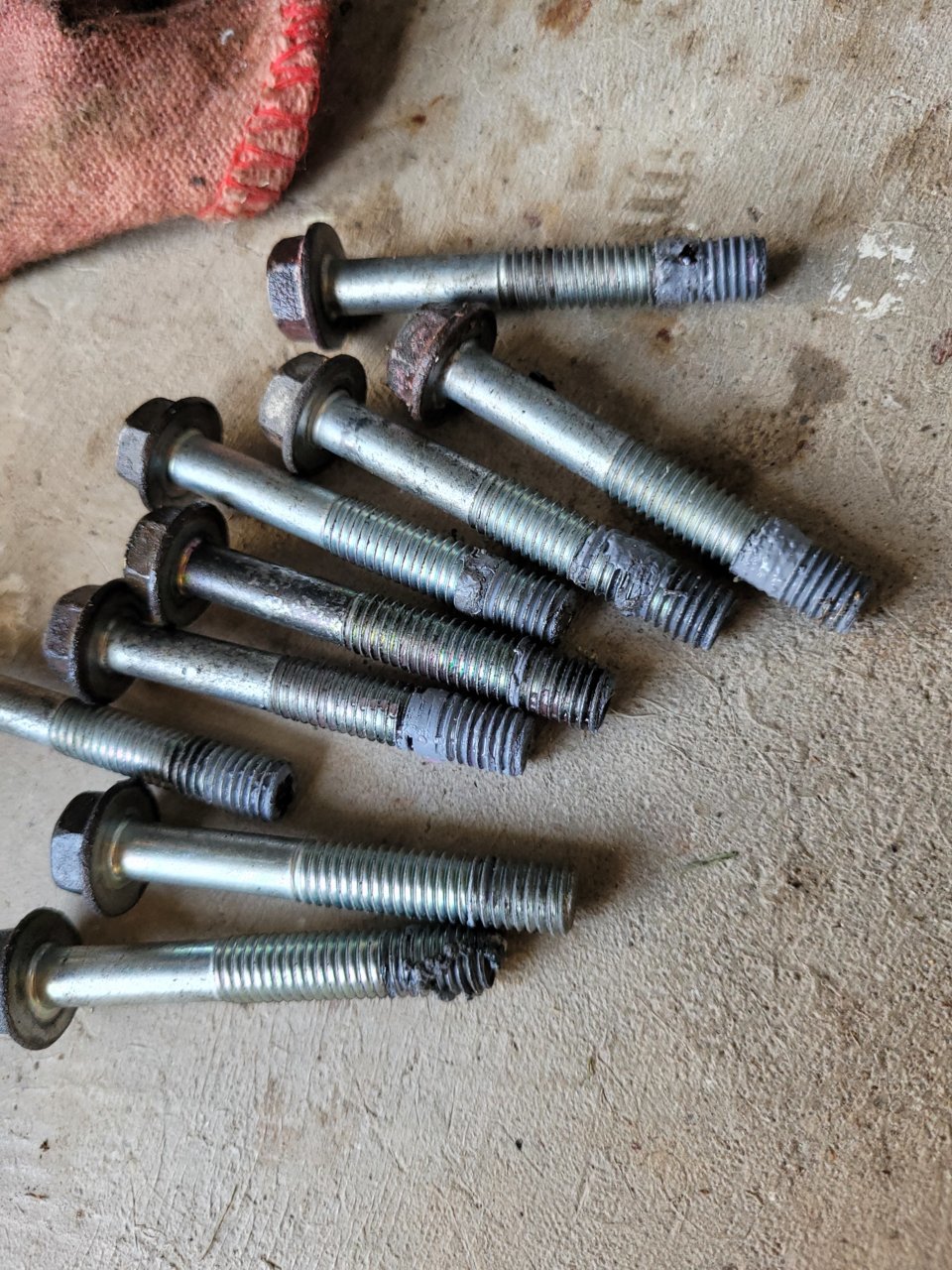

    All of my 12mm bolts for the water pump have a sealant on them. Do I need to clean them and put thread sealant on them?
