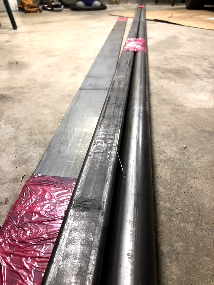

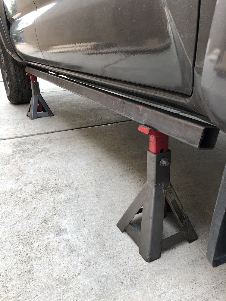

    160 bucks all in. I had a lot of rem tubes from previous projects so that will help. I just got 20 feet of 2”x0.120” round and 20 feet of 2”x0.120” square. The 2” seems more aesthetically pleasing on a Tacoma. 1yBdAalCZN6J1R95sD_UCxkU6bj6TFyGvF0QMwrM_e7fb72b00a866ac4cc7c99b1eaf71fa27474eb3c.jpg CSZT6eSIjyuvja9UfU1pOK3EC69v4rqtKiHRFBwF_4a41b5316ea5f5a330668e77e637f41da014f8e1.jpg vVP3g1nyH1xYRWXAYxvKVWI_xnNrJFb8bgNAJ5XZ_cdbc734f8700879a7913ec689ece66870dca1d1f.jpgCGricD58owIRLoRo14YA1QksJgwBHH4fInplI6kx_9d6a57eccd11cd4c7c0af96ae342e79174bc82c9.jpg

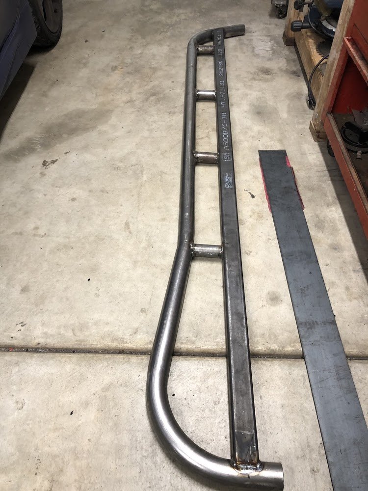

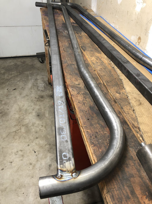

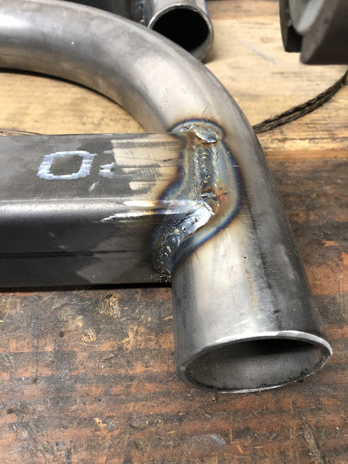

    Added the main tube to the square subframe tube. At this rate I will be done with these sliders in the same amount of time it takes CBI to build them and ship...lol
    Well, a long wait time wasn't the only reason I decided to fab my own. I love the aesthetics of 2" tube vs the 1.5 or 1.75" that most others offer. I also like the aesthetics of one continuous outer tube (three bends total across its continuous length) vs what other shops do for the kick out. Another thing i wanted was for the main tube to "wrap around" the subframe square tube. I think it looks way sleeker vs just having it land against the square tube and then welding a cap at the ends of the square tube. Also maybe it won't get snagged on things as easily (total length is over 80" so it gets closer to the tires, end to end).
    Welds are ok I guess for not doing it in so long
    LMkE0wvhY8WaXM2KGO1dX8r8dxLFILsXNPhtkq8F_4665c3e3fc8bb611c61a1971c6f25b08feadd05d.jpg
    shape:
    xk4Fzm5cLeY0DiOrYjphLXOkhKa4MNVZtTy1N0EJ_bd2a91ce33dd7ef53db4b941ae42a0784de1de30.jpg
    1hAl6lnctyuYzZzTZma2DP9smLdM3NYc27lvnhBb_90e7a5b84730ab5f9fd8410eac7b0d24709d6889.jpg
    Still need to trim off the "slack at the ends / add cross supports / make frame plates bold on ...so a lot more work :)

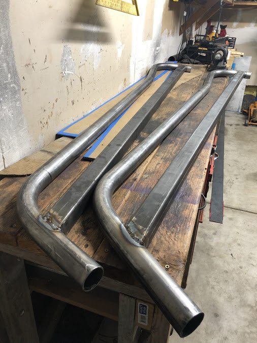

    This is the longest project ever. Been busy with installing CBI bumpers and suspension. At least I added side supports. Final step is getting plate to make these bad boys bolt on:

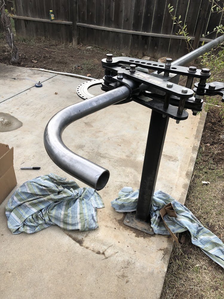

    Yeah , I actually purchased a 2" radius bender Di for my ProTools 105 bender, just because 2" tube looked more aesthetic on a taco vs 1.5" and 1.75"
