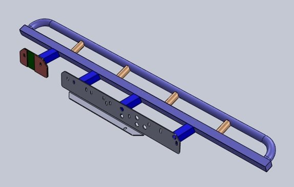

    Which file did you try to open? The solidworks file will not open unless you have solidworks or another compatible 3D cad such as a commercial copy of fusion360. The DWG is open able by most programs that can handle DXF files. I can't think of any lite programs off the top of my head that can handle them but they are out there. I think free cad is one? The tech school should be able to open that one as that is a standard format to receive for laser/plasma/waterjet cutting.

    Many thanks to @1Bored Clerk and @Simpleton for the CAD files on Taco Gen 2 & 3 frame plates. The files have been converted to IGES, so anyone can use FreeCAD (https://www.freecadweb.org/) to design their own sliders. FreeCAD can import IGS files but not Solidworks, and the software if free. Also included a sketch of a Gen 2 slider.
    Disclaimer: Same as 1Bored Clerk and Simpleton.

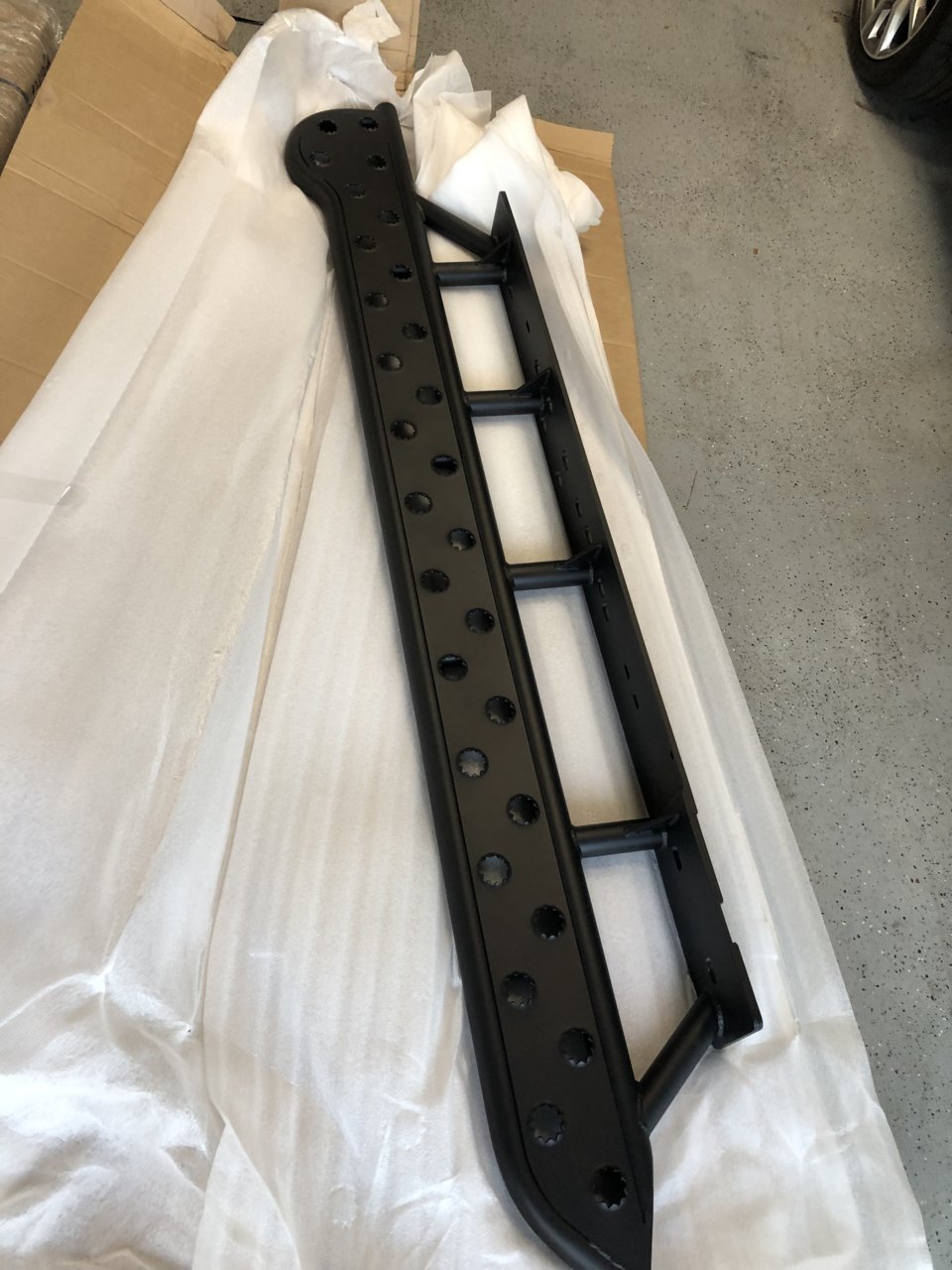

    Agreed, probably way more than I’ll ever need.... but you never know right?
    I just checked with a caliper... 3/8th for the plate. 0.120 for rails. 2” and 1.75”.
    There’s an embarrassing back story to this. My FJ has factory rails on it. Once, backing out of a sonic for a 3 point turn around (because I knew there was a landscape divider) I made a hard left when finally moving forward. I tapped up against the curb. Rather than hold up traffic to make it a 5 point exit, ‘right foot = go, right?’ So I hit the gas enough to get up over the curb. Well, turns out it was a landscape boulder and before I knew it I was up and over. Dtopped really hard on the frame/rails when the front tire fell off the near vertical 2’ drop on the backside of the boulder. Had to drop to 4 hi to peel myself off that rock. I snuck off snacking on my fries. :)
    A week or so later I notice a pretty big dimple on the passenger wheel well. Apparently the jar was so hard it torqued they front end enough to flex and dimple the sheet metal.
    Lesson learned: You don’t have to be off road to need protection, and watch out for those damned landscape boulders.

    Hahah that's an awesome story! What brand are those sliders?

    The FJ was factory, or GST option. These are Budbuilt out of NC.

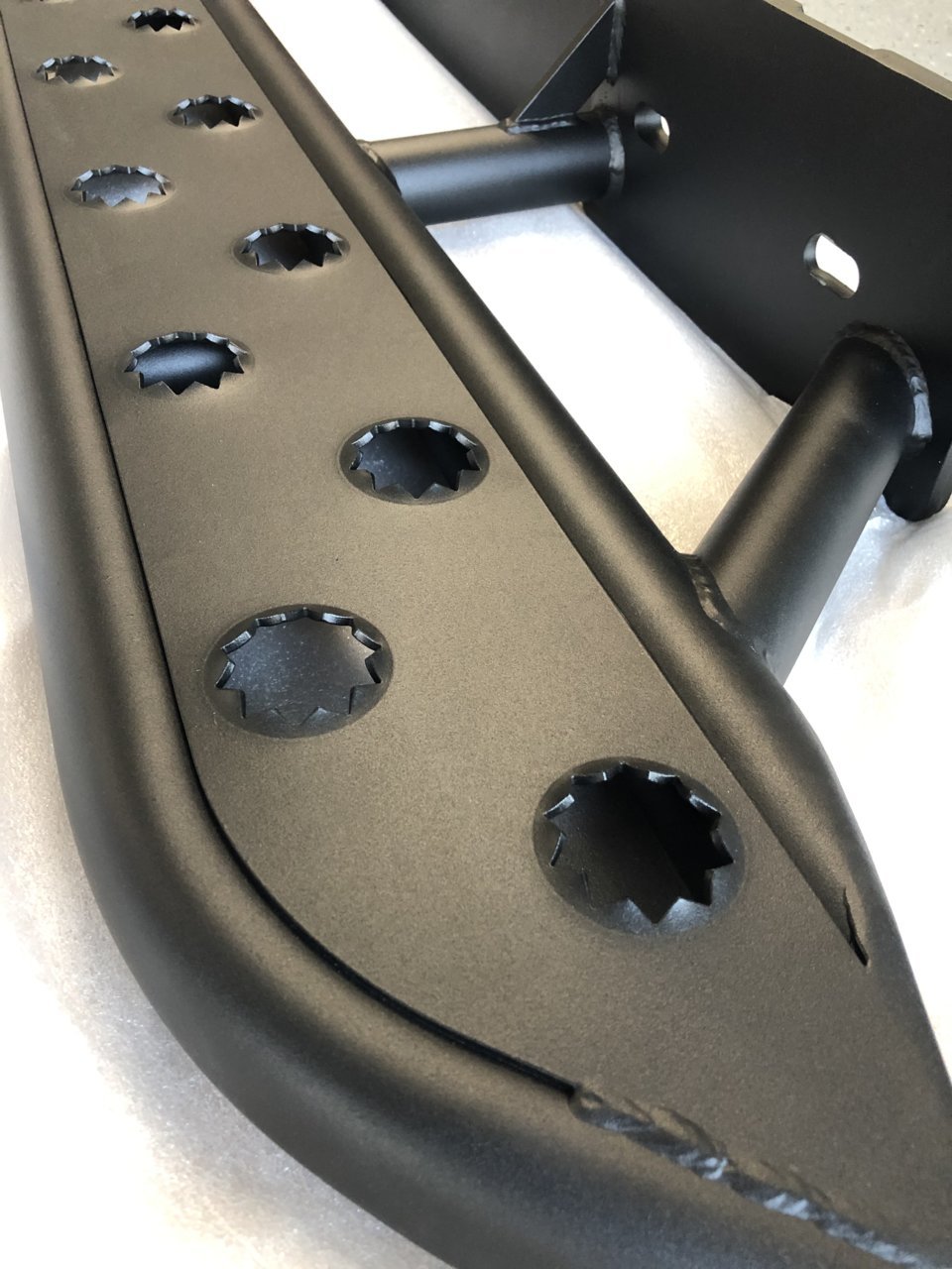

    Best part is a little custom work.

    Those look very very well built. I like the way the main tube tapers. The reverse dimples were custom?
