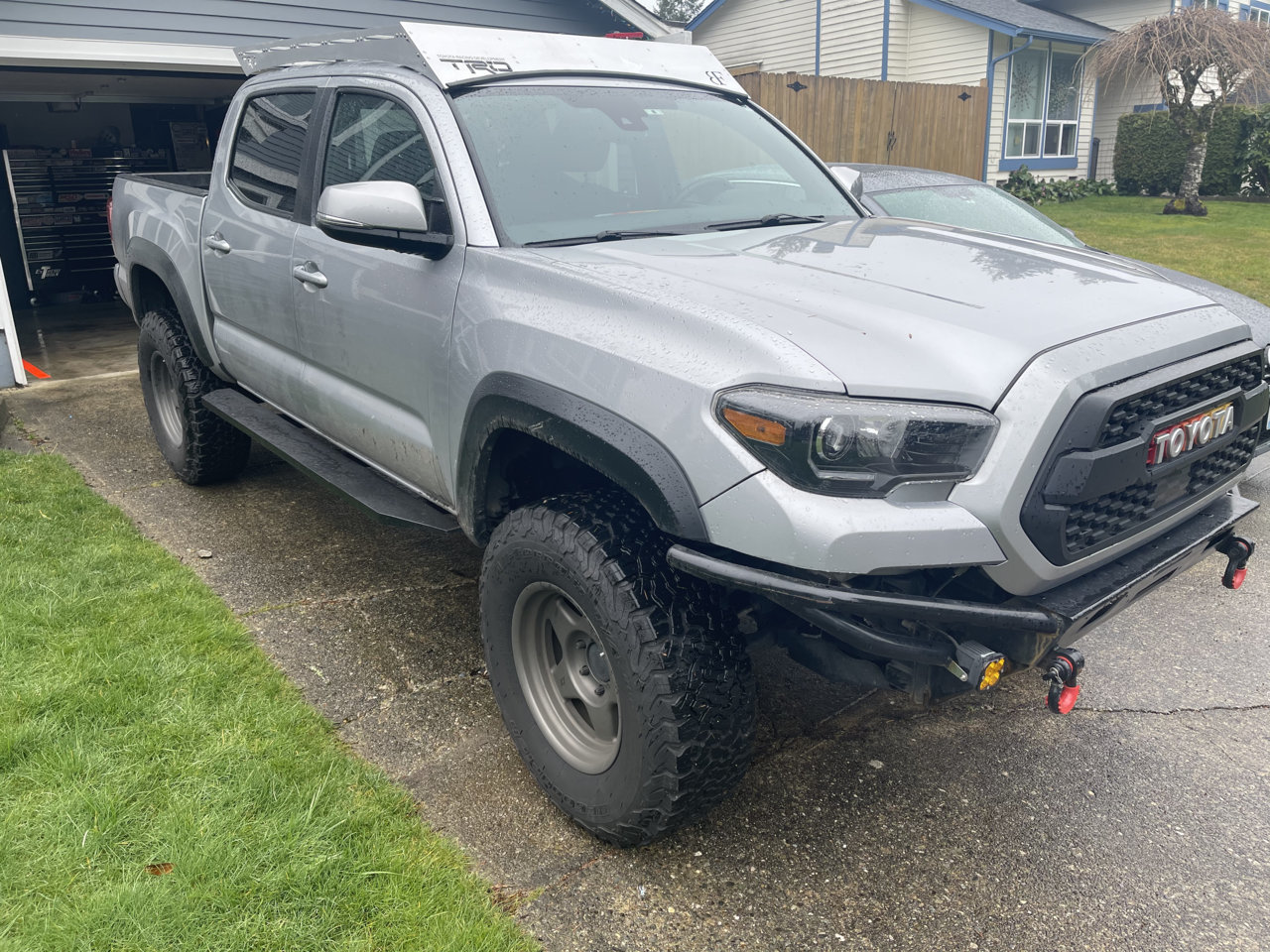

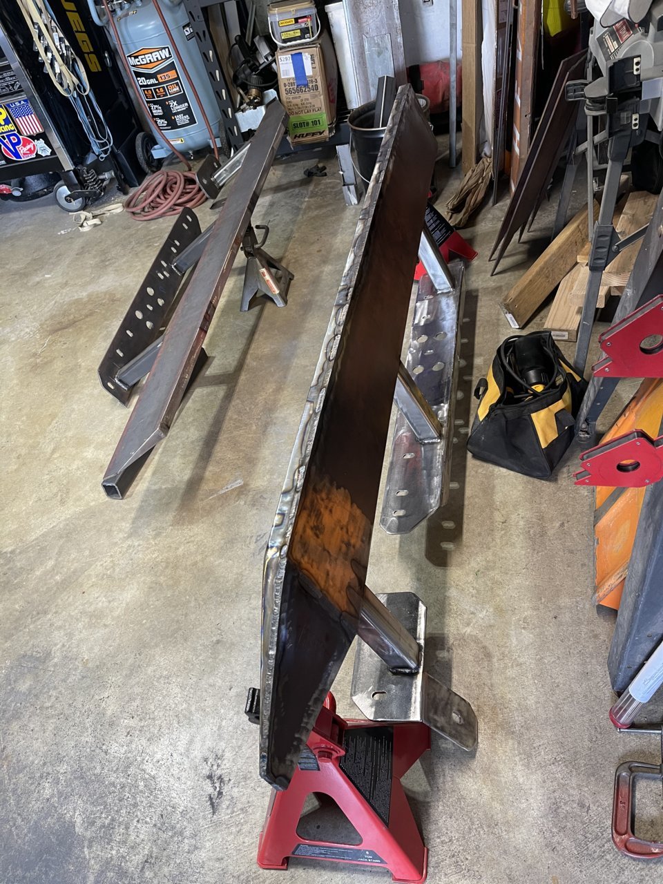

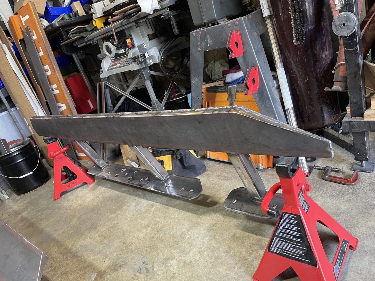

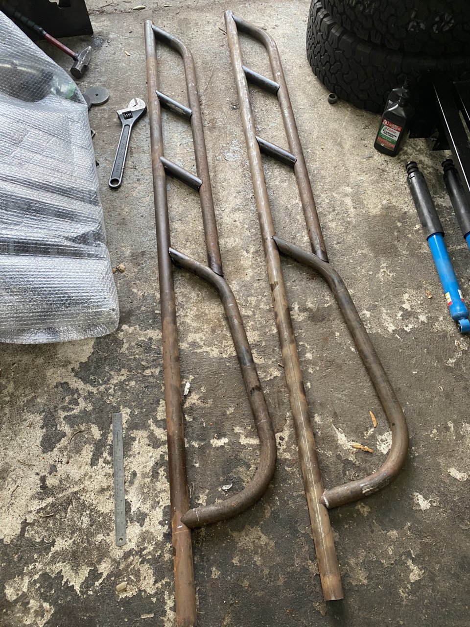

    7D79BD7B-0BB4-4EBB-AD5A-C59F83DDC16B.jpg 0A3DC5B5-748F-495A-940B-72BB65463B68.jpg I finished welding up mine. Hopefully sand/grind and paint tomorrow.

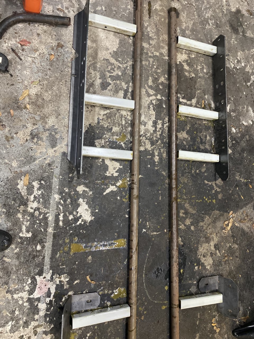

    And now I have some truck skies to install. C9E13BFD-B22D-4D18-8594-C763373FE6EE.jpgB038E4E0-F4B1-47DF-92F2-7C1EFB22D309.jpg

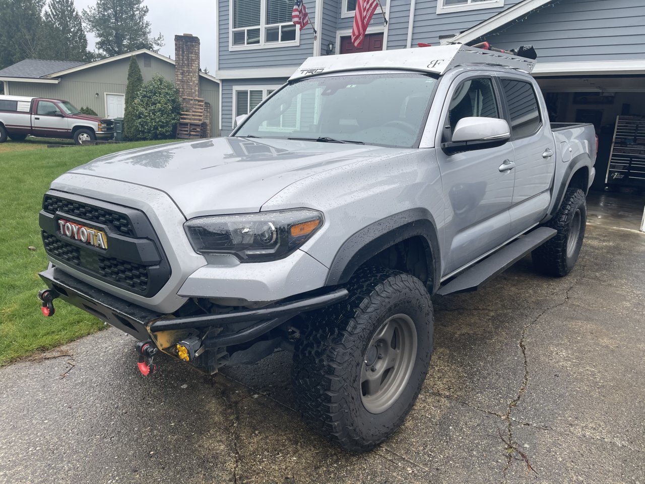

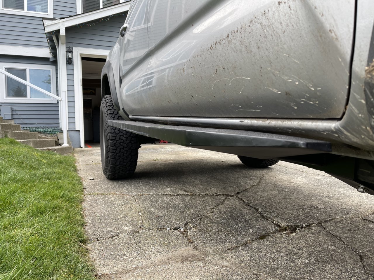

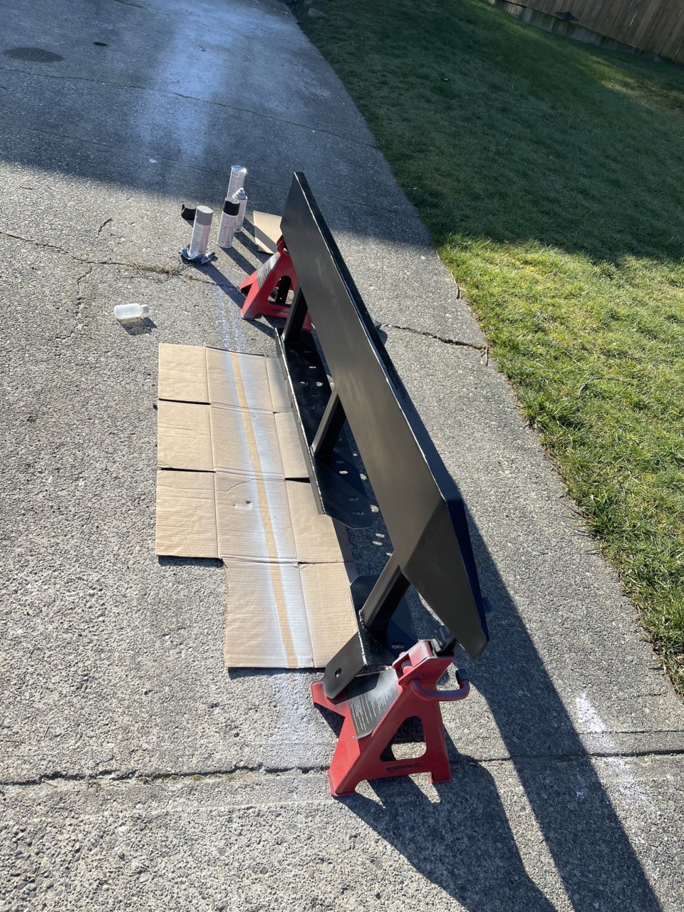

    Finally done and all mounted up. I still want to add a few more bolts to the frame plates. 089A3C12-FFD0-4234-A974-4FBC336B91E8.jpgC198A574-5FEB-44B3-8566-19AC2A0E7A7F.jpgDEB80AFF-FD50-4101-880E-1B44E8B4ADC1.jpg
