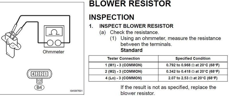

    111
    Hey guys,
    I had an alternative idea based on the blower motor resistor test diagram.
    Why not replace the resistor plug with soldered in, high-wattage resistors?
