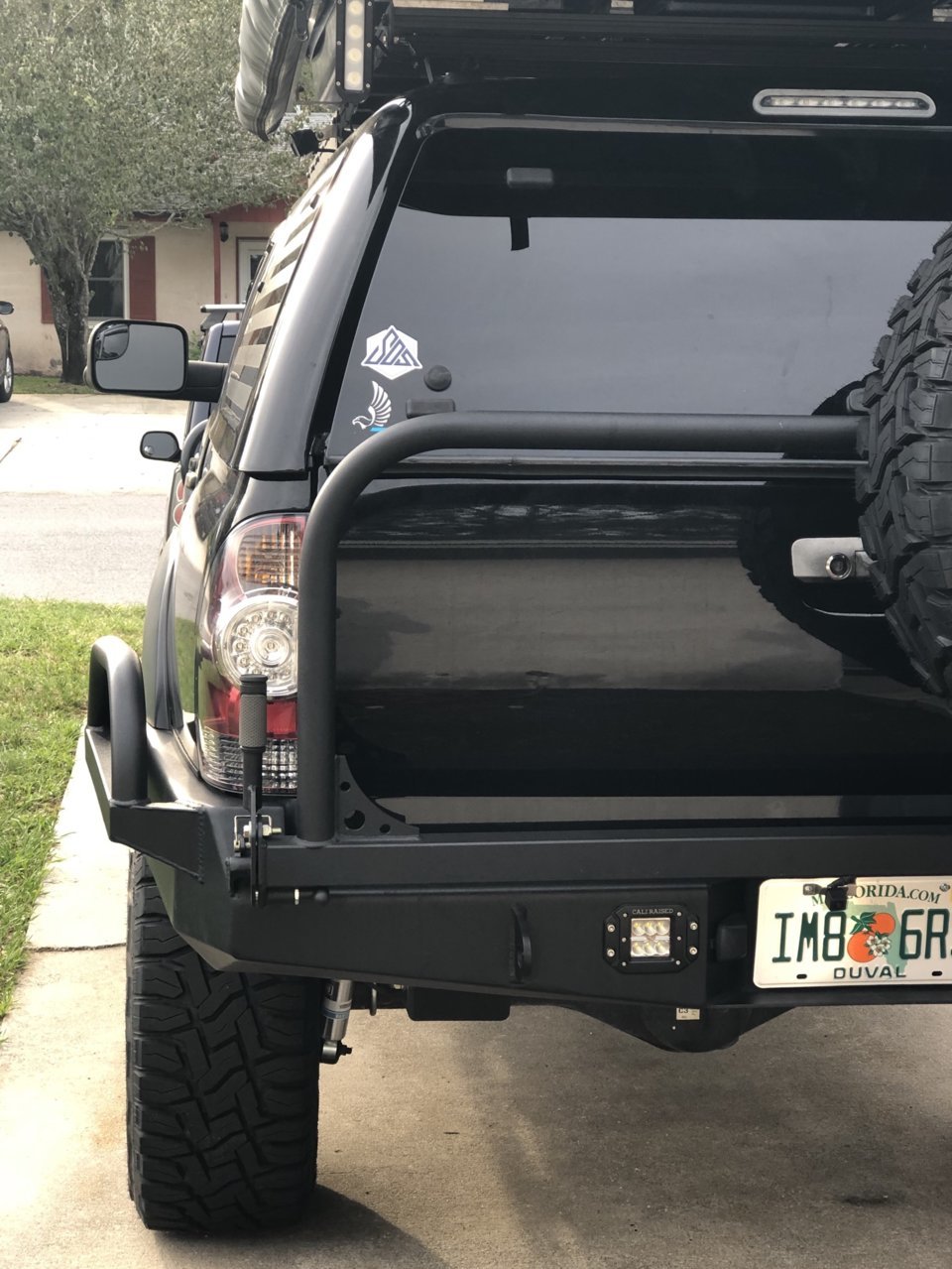

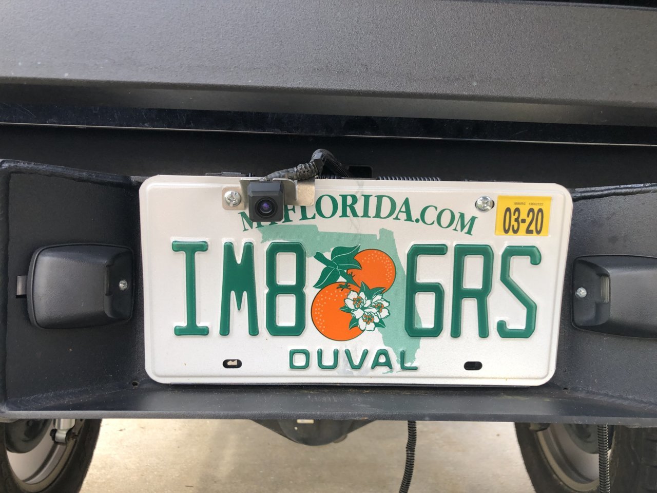

    Relocated backup camera tonight without cutting anything. Just took it out of tailgate and ran back under truck and ran up by rear passenger light and mounted to license plate bracket on the rigd ultraswing. Worked perfectly.
    Read through all the threads and was like wait a minute so when i got Home i took It all apart and rerouted it and bam works better then the original mount in tailgate. Rear tire carrier is within 1-2 inches of red line. Time for a beer.

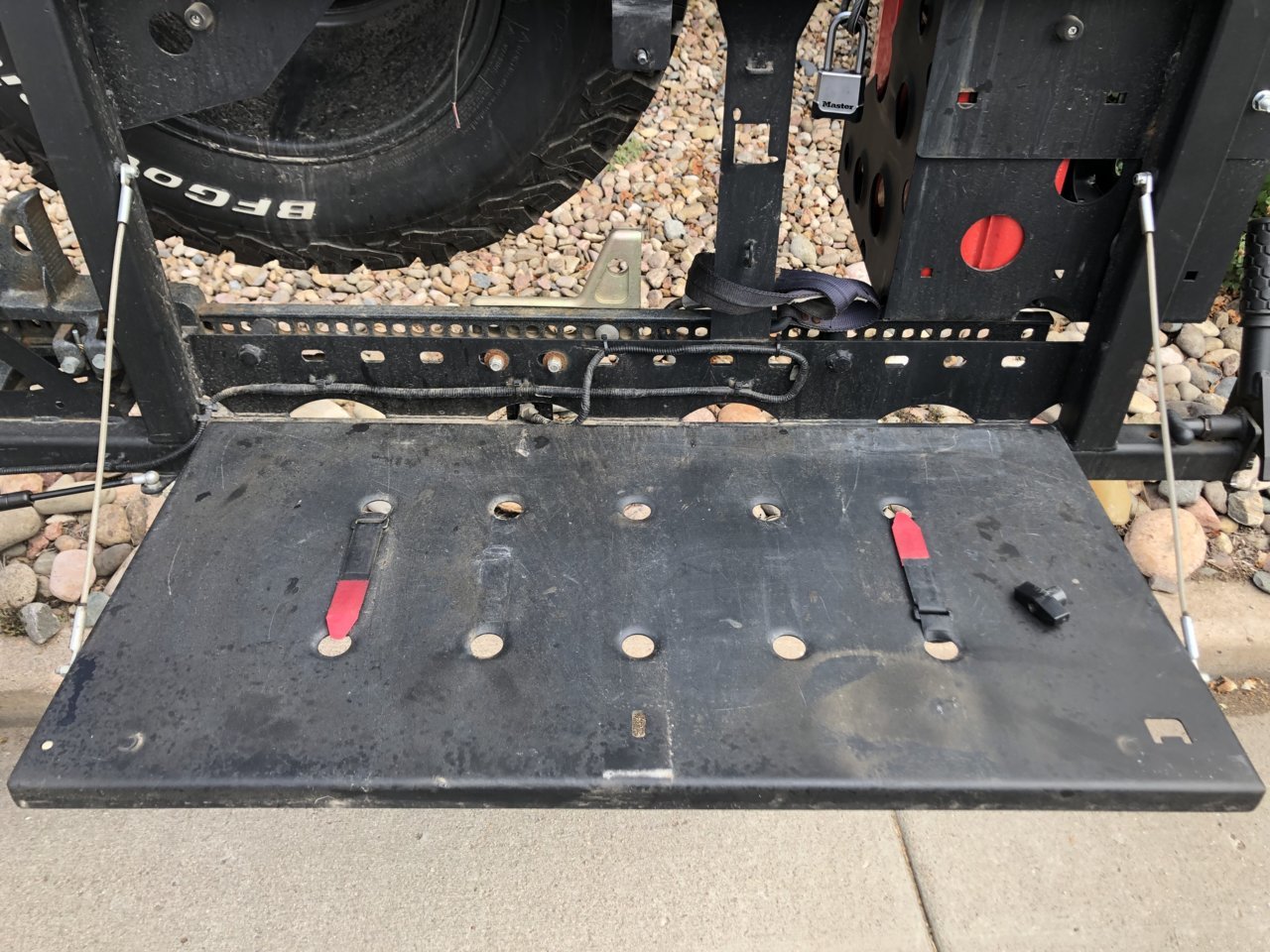

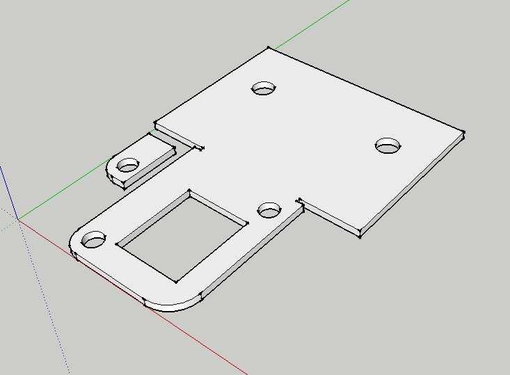

    Had the same problem with my rear tire on my C4 HC swing out, so I made a simple bracket in Sketchup and had it laser cut out of ABS for about $12.00.
    I can have more made or simply share the file. Hit me up if you'd like it.
    AZTaco2sDay and ready6delta like this.

    Have any more pictures from different angles or exactly how you attached it? I’m interested, just wondering where I’d attach it to my sos bumper.

    It has three simple bolt holes so it will attach wherever your bumper will take it - the C4 has a line of holes along the table hinge.
    I can always remove the holes from the 3D file and you can print it without and drill your own for custom mounting.

    The file is made to be cut out of flat stock (metal/plastic), so a hood would require hand-bending a piece of flat stock to cover the camera. My camera has been uncovered for close to two years and underwater a few times - still doing great. Let me know if you want to explore it though - I' always down for trying something new.

    Same. I have a base model so a while back I had changed out my stock handle with a pop-n-lock locking tailgate handle with a back up camera. Id assume the camera mounting is about the same internally. But I mounted mine to the license plate bolt as well.
