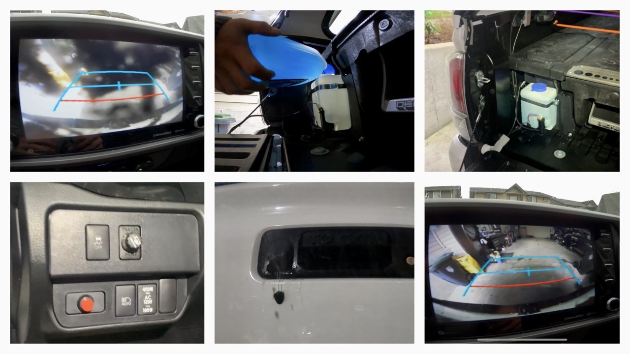

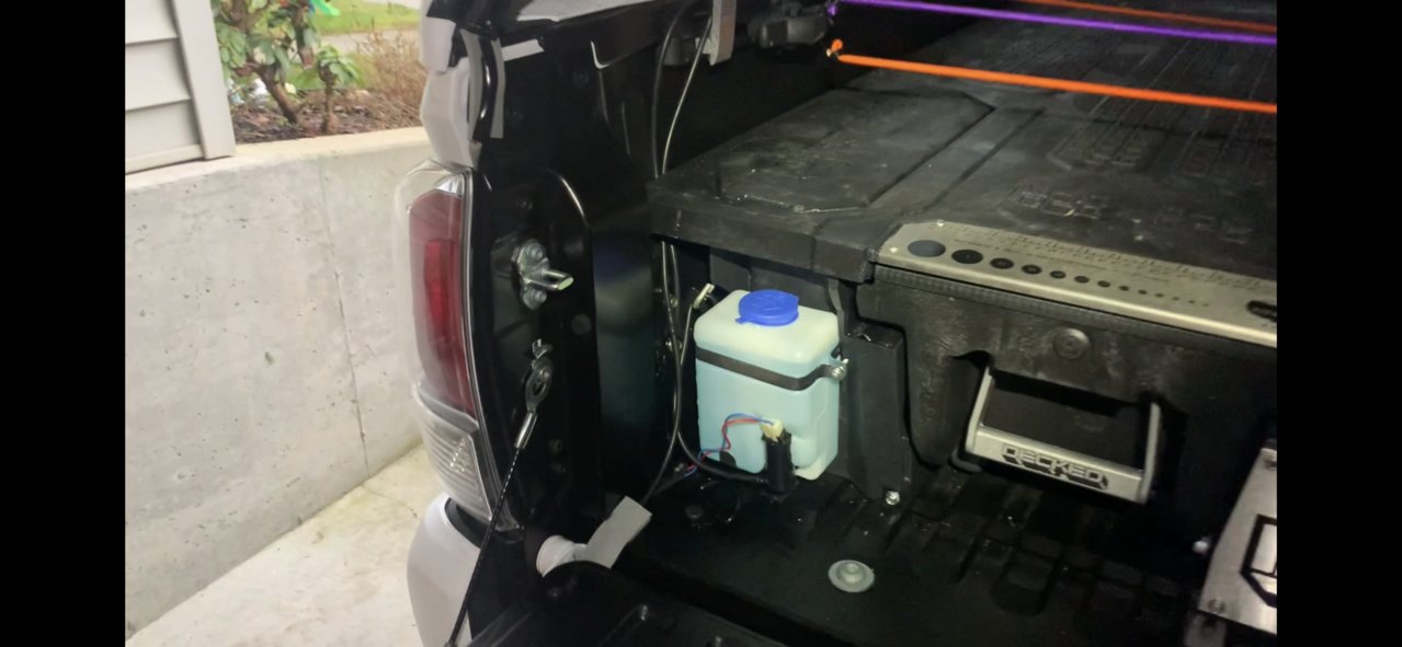

    DIY cam washer nozzle
    It's definitely not a must have mod for everyone, but on muddy narrow trails, with tons of equipments on board block sight, may help for backup without a spotter. Just like why we buy LED bars, also not for daily in city use.
    *Before the final setup, I tested only use T connector /4m long tube direct connect to front windshield washer tube, due to tube was too long , have water inside, but pressure of small OE pump not enough to run. And if the rear nozzle position lower than res, water will dripping out.
    Parts cost around $50, just share the idea, if someone need this modification, here is the key points :
    1. when open tailgate , nozzle start dripping water , that's why the route of tube in the bed higher than the pump.
    2. Positive + wire route:
    Pump+ to switch(on dash /port 1)
    Switch(port 2)to backup light+
    When in Reverse, backup light+ supply 12v to switch, press switch , then added nozzle works.
    When Not in reverse, press switch no power.
    3. - wire direct to body behind taillight.
    4. For suv /minivan , may be only need T connectors/ short tube / nozzle, connect to rear window wash tube. No pump or res needed.
    5. same idea can be use to DIY headlight wash or anytime front camera wash, like OE jeep gladiator front camera wash nozzle.
    Direct connect in engine bay, tube may have enough pressure, not tested. Also can be DIY on any automobiles even RV as needed.
    6. This setup can be hide into decked cubby. Thanks u guys for great advice.but I would like to see the level and fill up easier, and I don't mind how it looks.
    7. drill a hole for the tube go through from tailgate to bed is not needed. But for nozzle installation, yes.
    8. Brought extra 4 meter black tube , didn't use clear tube in package. 4 meter should long enough for even full size pickup to DIY.
    9.if put the nozzle more sideways, might also clean the tailgate handle at the same time.
    For a weekend cheap project, why not? :)
    If u DIY, and made a better setup, hope u can post here!
    Thanks advanced for all reply and advice! Wish all have a great day :)

    I wonder if you could mount this 3-way solenoid off of the factory tubing and then just run hose from the pump to the tailgate. Then add a new momentary dash button that activates the solenoid and washer pump.
