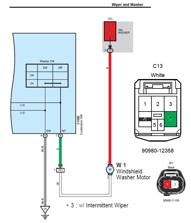

    Why even add an extra switch? Wire the secondary pump to the stock one. Every time you spray your windshield it will spray the camera too.

    Good idea, was thinking about that but due to I need use a lot in logging road some times, so don't want carry much. Another switch can save some.
