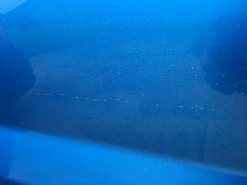

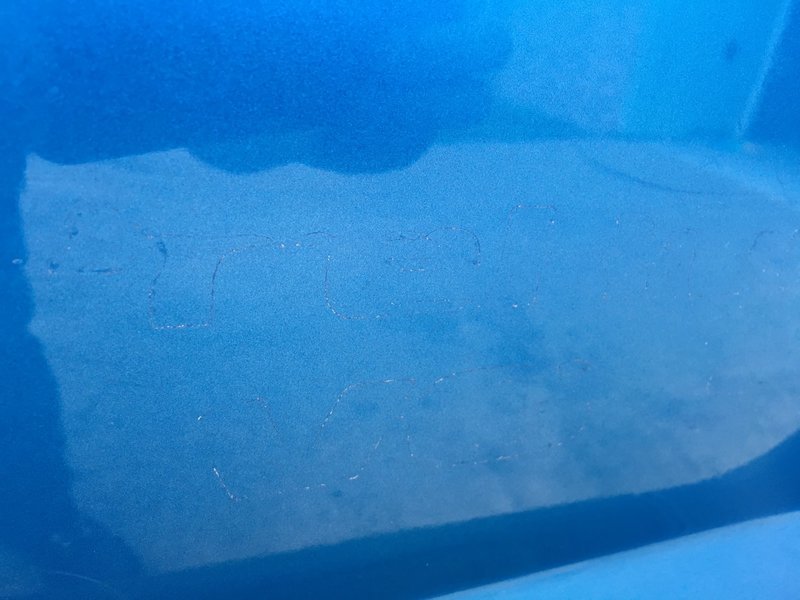

    I'm in the process of debadging my 2010, but not replacing them back on, just leaving off for a clean look right now.
    After wash, I used the clay, but I still can see the outline. Is this something I just need to wax/polish out? IMG_0937.jpgIMG_0938.jpg

    Try Mcguires cleaner/wax. Has a real mild compound in it along with wax. Always worked out good for removing that kind of stuff for me. And it leaves the area waxed as well. 2 birds....
    Also. I like to put a little on and let it sit first and take it off. Kinda like an initial coat to help prevent scratches and let it saturate the stuff on the paint. Use a micro fiber or softer.

    ^ what he said
    And just FYI: I do not have any residue or ridges between the paint on the edge of the former badge and what's underneath it but I still have a tiny bit of "ghost writing" with the "SR5" badges. You can only see it close up at the right angle in the right light. Otherwise it's invisible.
    And by ghost writing I mean the difference in paint shade/color under the badge vs the rest of the oxidized paint.
    What you have it adhesive residue leftover.

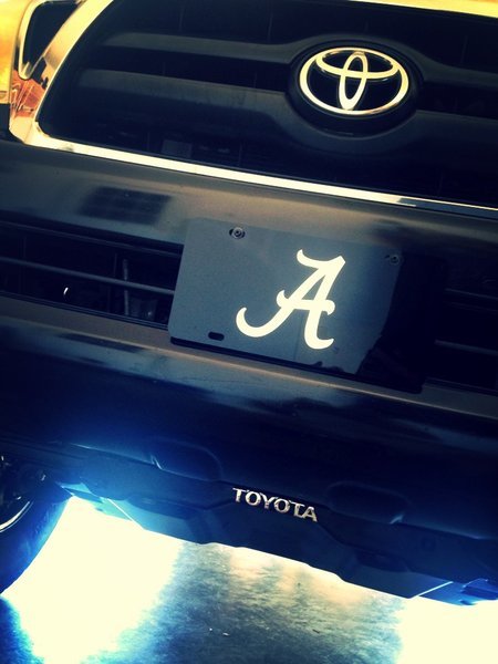

    2006 black
    I debadged then added the small 'toyota' to my skid board. Fit perfect
