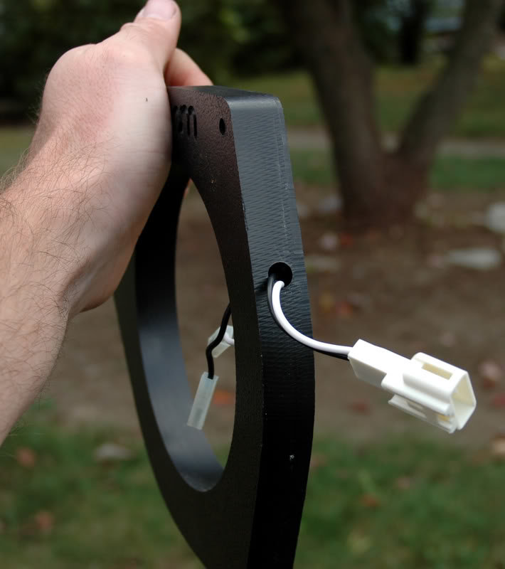

    OK, needed materials:
    • (2) 6 1/2" speakers for the rear doors
    • (2) 6 x 9 or 6 1/2" speakers for the front doors
    • (1) *********.com access cab speaker mounting kit.
    • (1) box 3M Strip-Calk part number 051135-08578 (available from your local automotive paint supply store) (more on this later)
    Step one. Choose your speakers. I personally have had Pioneer TS-a series 3-way speakers in everything I have ever owned, I like the way they sound and I happened to have 4 of them wanting to go into my truck anyway. I'm not going to try to convince you that I am right on this, the best thing for you to do is to go to your local Best Buy (middle of the afternoon on a weekday is best if you can pull it off) or whatever, and listen to all the options in the sizes you need. Then write down the model numbers of the one(s) you liked and go home and look for them on-line, Amazon, Ebay, Crutchfield, whatever. Then order your chosen speakers.
    *NOTE* I believe that Crutchfield may include speaker adapter brackets when you buy speakers from them, so if that is the case, then go ahead and dis-regard step two.
    Step two. Now that you have chosen your speakers and know what sizes you'll be using go to https://shop.*********.com/splashPage.hg;jsessionid=51B40BE32B047B0F38851284080620E9.qscweb19, click on your cab configuration, and choose your product.
    I went with the Access Cab Kit - 2005 2006 2007 Heavy Duty Plastic Mount Kit - 6.5 Inch. The kit came with front and rear mounts for 6 1/2" speakers, wiring adapters (so that your new speakers plug rightinto your factory wiring harness), and enough screws to mount the speakers to the mounts and bolts to secure the mounts to the truck. I also chose the heavy duty plastic instead of the MDF as I plan on keeping this truck for a long time, and prefer to only ever do things once, and as I understand it the MDF material deteriorates over time, and the price difference was only about $20.00.
    *Note about the hardware kit* The speaker wiring adapters are available on Ebay for slightly cheeper than ********* sells them, but I liked the convenience of getting everything in one box. Also, the bolts that they send to secure the mounts to the rear doors are not correct. You actually need a fairly long and beefy sheet metal screw, instead of the bolt that they include. So at your discresion you could opt for just getting the mounts through *********, and get the wiring adapters from Ebay and hit your local hardware store for the screws and bolts, and possibly save a couple of bucks.
    That said, I got everything from ********* for $116.40 including shipping. Here is a picture of the complete kit from *********.

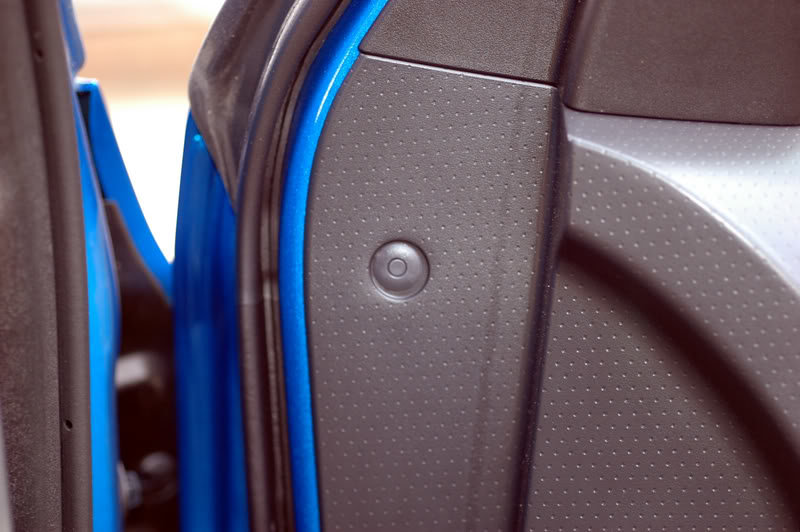

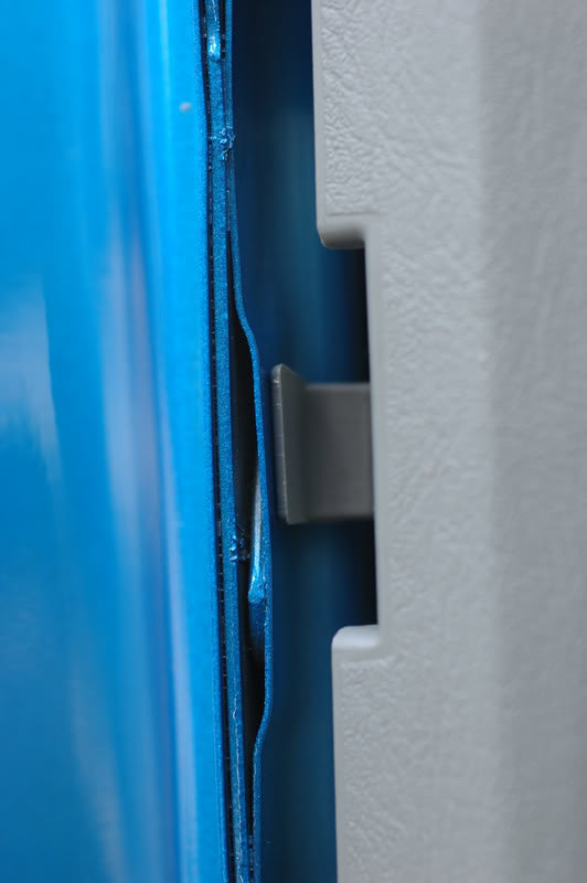

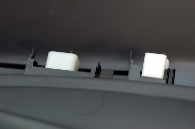

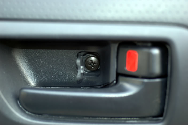

    Step one. Open your front door, and remove the small black plastic triangle on the inside of your door that covers the mirror mounting hardware. Grasp it from the edges and gently pull away from the door. It is only heald on by three plastic clips, and while they seem fairly sturdy you want to take care not to break them.
    Step two. Take your small phillips screwdriver and gently (it only needs to move a little bit) press in on the center of the plastic pin on the door panel near the top hinge. Then you can get your finger nail or small flat blade screwdriver under it and lift it out. Set it asside as you will need to re-use it to put the door back together.
    Step three. Take your small flat blade screwdriver and gently lift up on the tabs shown in the next two pictures. They are hinged, so only one side lifts and they remain attached to the door panel. Be careful to not scratch the plastic on your door panel with your screwdriver while you are doing this. Then remove both screws using your #2 phillips screwdriver.

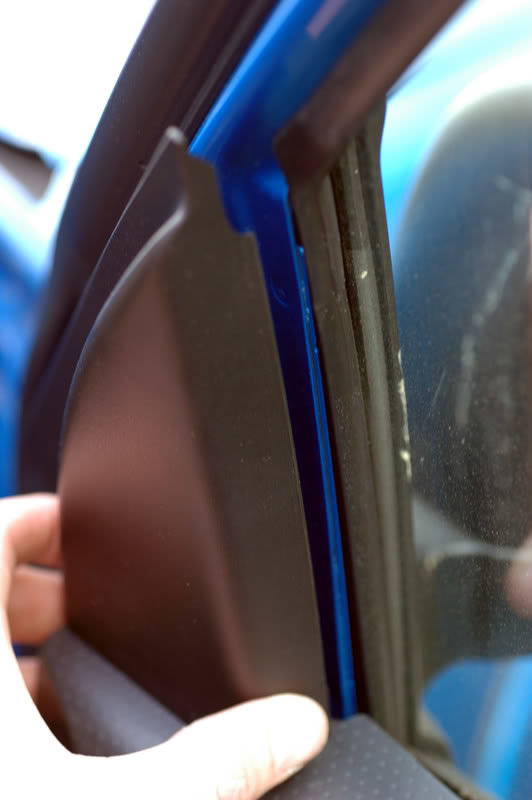

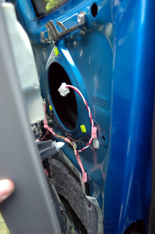

    Step four. Get your fingers under the lip of the door panel and gently begin to pull outward. These are the sturdiest plastic clips I have ever seen, but they ARE still plastic, so be carefull. Once you have freed the pannel from all of it's clips you can then simply lift the pannel upwards. However, at this point you will not get very far untill you un-plug both the power window and power lock harnesses, from the door panel. It takes a little time and patience as there is almost no extra wiring on the passenger door, so you have to feel around down there blindly, squeeze the locking pin, and out the come. You can now set the door pannel aside.
    I did the best I could with pictures of the wiring in question, but there was really no room to get the camera in there while it was all still connected.

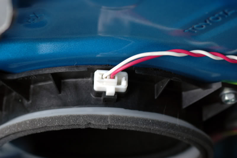

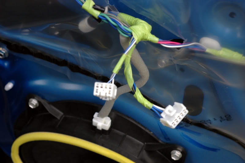

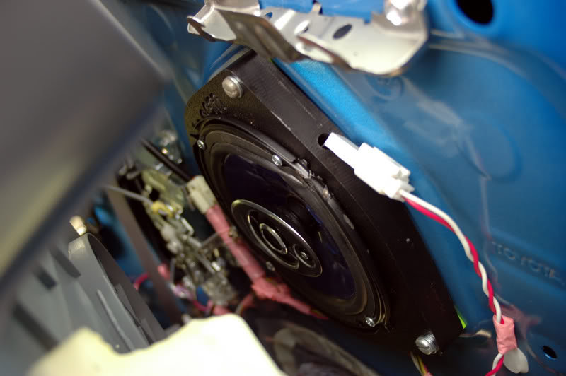

    Step five. You can now see the front speaker. Un-plug the wiring harness from the top of the speaker, and use your ratchet and 10mm socket to remove the four bolts holding the speaker to the door.
    You then have to pull on the speaker housing a little bit to get it to come out of the door as it was sealed to the door to prevent water leaks.

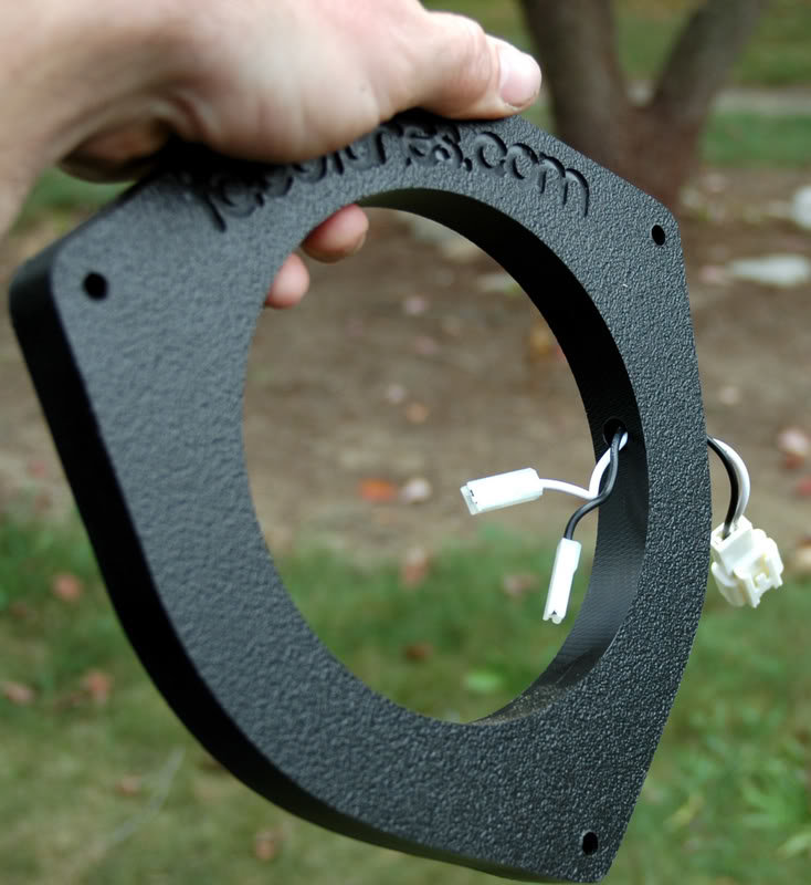

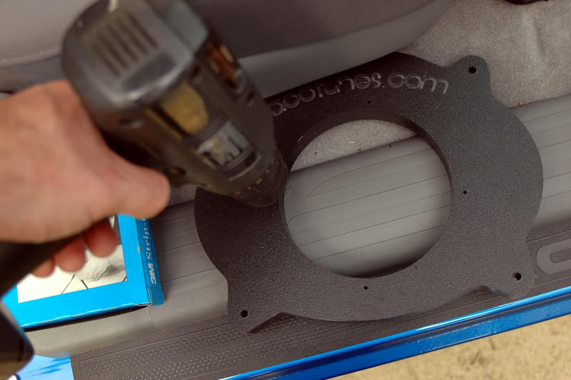

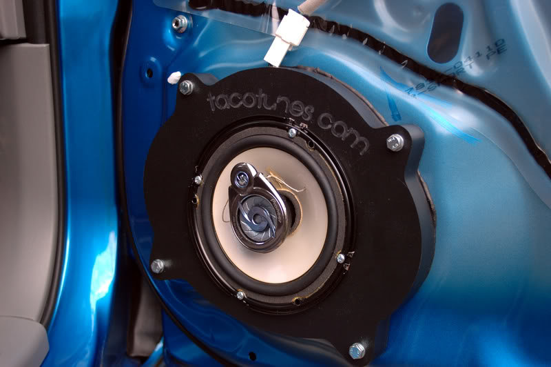

    Step six. Now hold your ********* mounting spacer up to the opening in the door to determine the correct way to mount it. (It only mounts one way, in my case the ********* logo was right side up, but I do not know if that will be true for every kit). Take note of where the wiring harness from the truck intersects the speaker mount and mark it's location on the edge. Take your drill with the 21/64 bit and MAKING SURE YOU ARE CENTERED drill a hole to run your wiring through. (note the photo is of a rear speaker mount as I only documented the drilling of the mounts one time)
    Step seven. Determine the correct orientation of your chosen speakers so that the wires still reach the terminals, mark the holes, and pre-drill your holes using the 3/32 drillbit, then screw your speaker to the mount with the screws supplied with the kit, and connect the terminals on the back of the speaker to the leads on your new harness.
    (No I did not drill the holes with the mount sitting on my truck like that, I just put it there for the sake of taking a picture)
    Continued in next post...

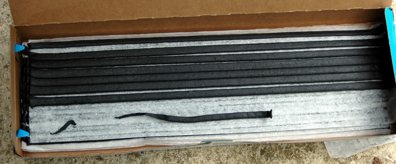

    Step eight. Remember way back in the first post I mentioned that you would need "3M Strip-Calk part number 051135-08578." Here is what that is, and where it comes in. This is what it looks like.
    And this is what you are going to do with it.
    I ran two beads of the strip calk around the speaker opening. All doors let a little water in when it rains (that is why there is a plastic sheet on the inside), and you want to seal up the speaker opening just as it was when you removed the factory speaker. I suppose that you could use any type of household calk, but this product seals tightly, yet stays soft, so you won't kill yourself tring to get it off if you ever want to change speakers, or revert back to the factory ones before you trade it in or whatever.
    Step nine. Now grab 4 bolts and washers from the kit, insert them through the holes in the speaker mount, line them up, and tighten them down using your 10mm socket again. Use caution not to overtighten and strip out the plasting inserts that the bolts are going into. From there plug in the factory harness to your newly created harness, and turn key to acc. and test.

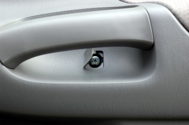

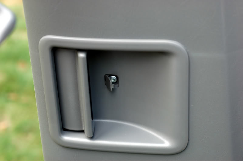

    Step one. Open your rear door. There is another plastic clip on the top of the door panel near the latch. Again press GENTLY with you small phillips screwdriver and then get your fingernail under it and lift it out.

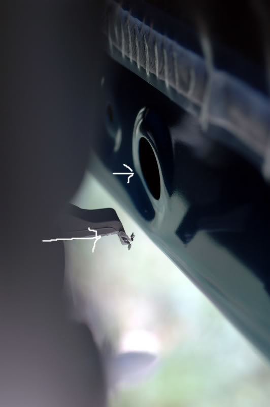

    Step two. Locate another of those hinged screw covers in the rear door handle, and again carefully pop it open with your small flat blade screwdriver, and remove the screw inside with your T-25 torx driver.

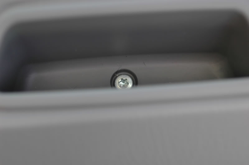

    Step three. The final screw is in the "pocket" (for lack of a better term) which is right under the window. This one is also T-25 torx.

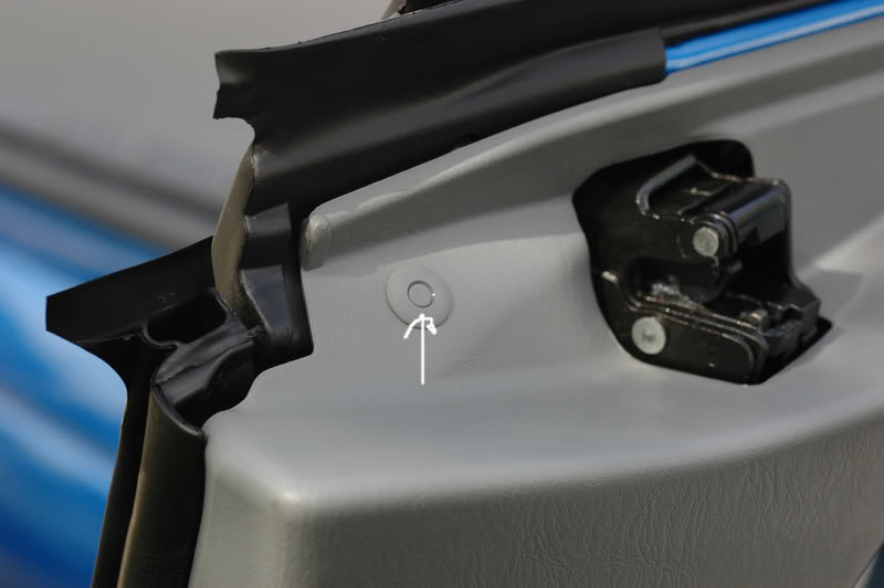

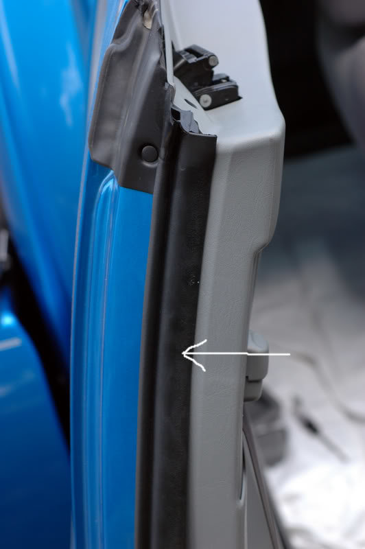

    Step four. Now remove the weather stripping from the inner edge of the rear door. (where it seals against the front door) There is no real trick to this, just grab it at the top and slowly pull it away from the door working your way down to the bottom.
    Note the plastic tabs that were revealed when you removed the weather stripping. There is nothing to do with them right now, but I'll re-visit them later.

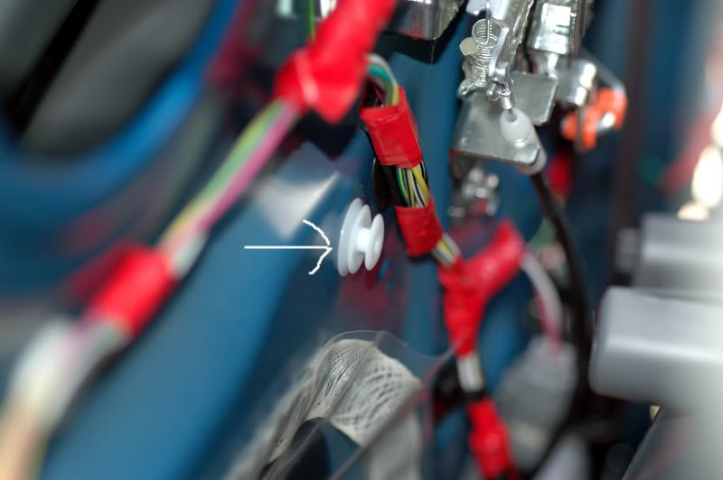

    Step five. Now that you have all that done, again get your fingers under the edge of the pannel somewhere of your choosing and begin to gently pull outward, working your way all around the door. *NOTE* I could not see an easy way to remove the panel from the bottom seatbelt mount complately, so I left it attached to the door at that point, and worked in the space that gave me. Take note of the amount of space it gives you.
    It is also worth noting here that on both of my rear doors two of the little plastic clips remained with the door instead of the panel, so if that happen to you as well, you'll need to get your small flat blade screwdriver in there and get them out and put them back in the panel before you put everything back together.

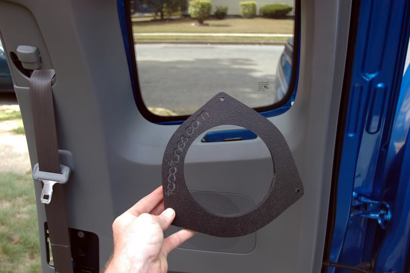

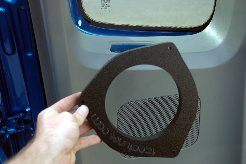

    Step seven. Now again, as with the fronts, hold your new mount up to the opening and line it up so that the holes all match up, and mark the location of the wiring harness and drill your hole in the edge. (refer to post 3 step six for this procedure). Just as a reference, this is how mine lined up.
    Passenger's side
    Driver's side
