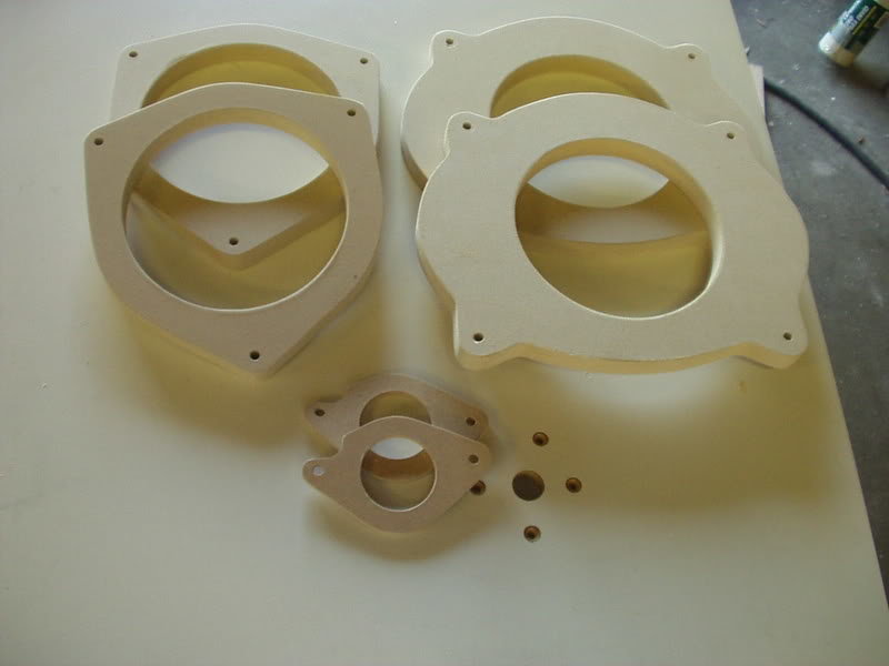

    Baffles look like this. They are rings that go around the speakers to act as mounting brackets.

    They get a lot of bad press due to their complete lack of response to emails, but for something simple that can't be fucked up like speaker adapters, I went with *********.
    They sell a complete kit with adapters that will work for both the mids and tweeters with all hardware for under $50.
    Just be sure that you give them the information they need to do it properly, which is the make and model of your new speakers, and the diameter hole needed... both manufacturer's recommended size hole, and an actual measurement from the tweeter.
    When I ordered the set for my Polk speakers, I had my ********* adapters in 3 days.
