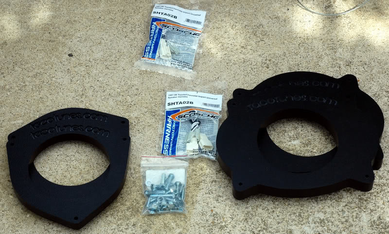

    Thank you guys for your quick response.
    I was able to install the back door 6.5's (Infinity Kappa 62.11i) with Metra speaker mounts, no issues. Everything was plug and play. For the replacement tweeters (Infinity Reference 075TX), I ended up making my own brackets out of reinforced stainless steel. I think they turned out really nice looking and are solid, no wiggle.
    For the front door 6x9's (Infinity Kappa 693.11I), I can't get the 4 speaker holes to align with the Metra 6x9 bracket, only two holes line up?! Anyone else come across a similiar issue?
    **EDIT** I've ordered these brackets from Amazon and they worked well for front doors. They did not have pre-cut holes, so I was able to mark my own.
    Merry Christmas!

    Front door speakers
    The Tacoma's front door houses a 6"x9" speaker molded to a mounting bracket, so an aftermarket 6"x9" speaker will not fit unless you build a new mounting bracket.
    bingobango. thanks bud.
