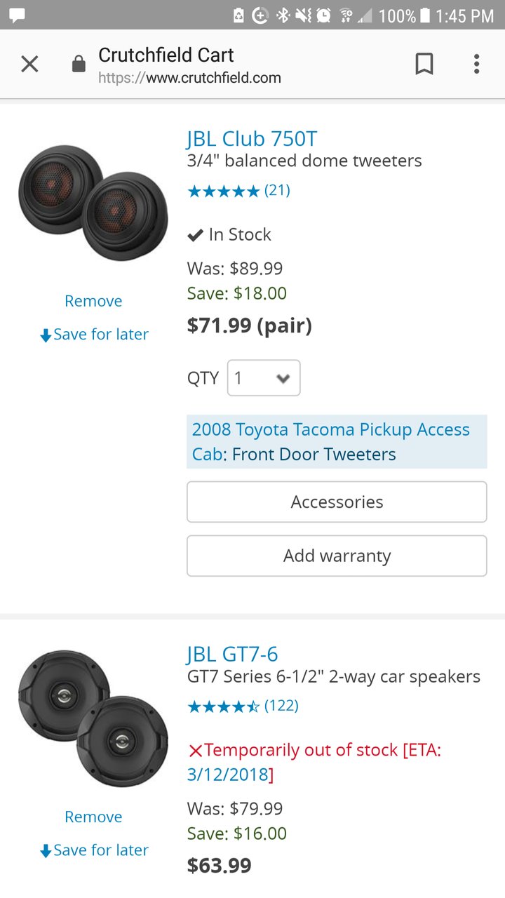

    I'm getting these speakers Screenshot_20180306-134520.jpg Screenshot_20180306-134346.jpg Screenshot_20180306-134520.jpg

    Ended up not doing the tweeters. Wasnt planning on doing an amp so I pretty much wasted the tweeters might re order them and see what I can do.

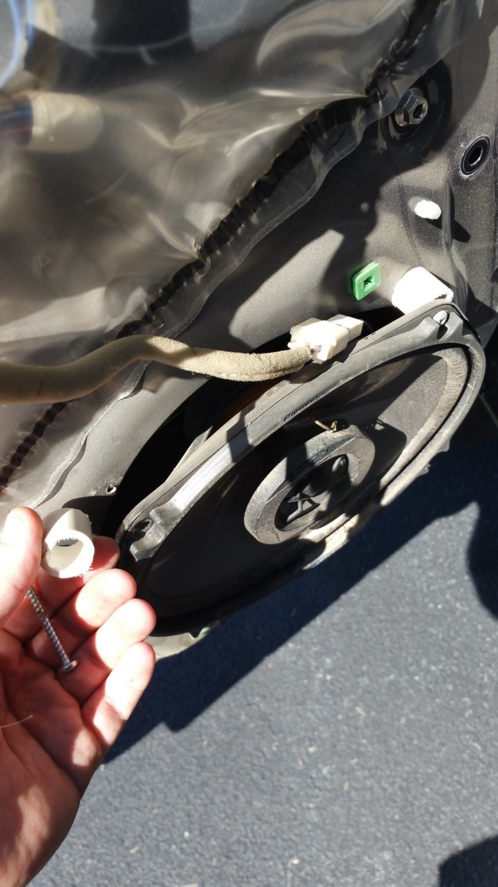

    I just got my speakers in the mail and started taking apart my door to find this hack installation, no wonder my doors vibrate. Pvc pipe spacers and 3 mounting points with 2inch long bolts. 200 watt pioneers 2 way speakers I had no idea were already there. Replacing with 420watt 3 way pioneers20180804_144348.jpg 20180804_144348.jpg 20180804_151330.jpg

    Took me about an hour from start to finish to change out the front door speakers with the taco tunes mounts

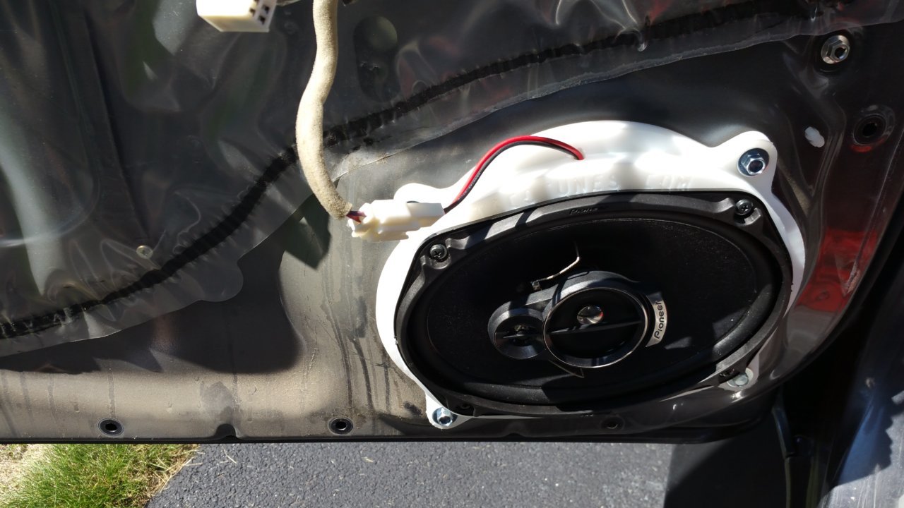

    FYI- Pioneer TS series 6x9 comes with a bracket which IMG_2036.jpg fits perfectly in the stock location. No need to buy brackets.
    TS-900M $64.95 comes with:
    • Multi-fit 6" x 9" adapters included for simple and easy installation

    How do the Pioneers sound? Are you replacing a basic system or JBL in the doors? Thanks in advance.
