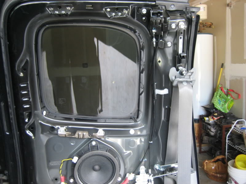

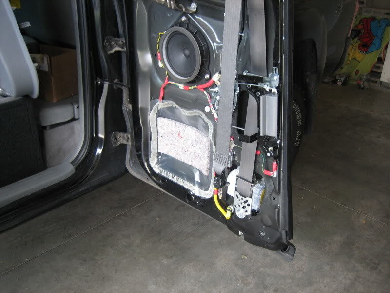

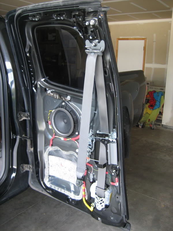

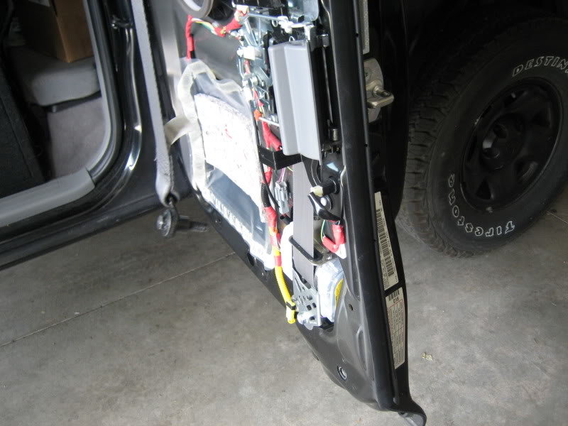

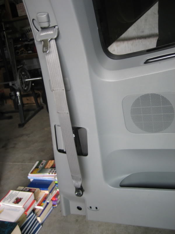

    Additionally, here are some key points for the rear doors on an Access Cab:
    There are really three things that one needs to keep in mind with the rear doors that hasn't been expounded on enough yet:
    First, is the seat belt ratchet adjustment assembly up top. You need to make SURE it is hooked in completely when you put the door back in. Otherwise, your seat belt adjuster will not move up and down correctly. Also, take care NOT to damage or scratch the plastic around the seat belt adjuster with the door panel when you remove it (the panel).
    Also, to remove the seat belt for complete removal of the rear door panel, as mentioned before, simply remove the bolt at the bottom - . Yes, the plastic cover at the bottom comes off, and yes, it is a bit of a pain to get on and off. It takes some finagling, as does the door when you re-mount the door panel back on.
    The third and last point is the little grab handle, change cup up top. If the door panel isn't seated correctly all around, it will not sit flush when you go and try to screw it back in with one of the torx bolts.
    Hope this helps make this already very nice DIY even better. :)

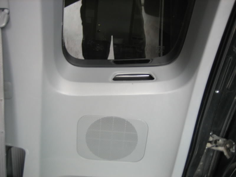

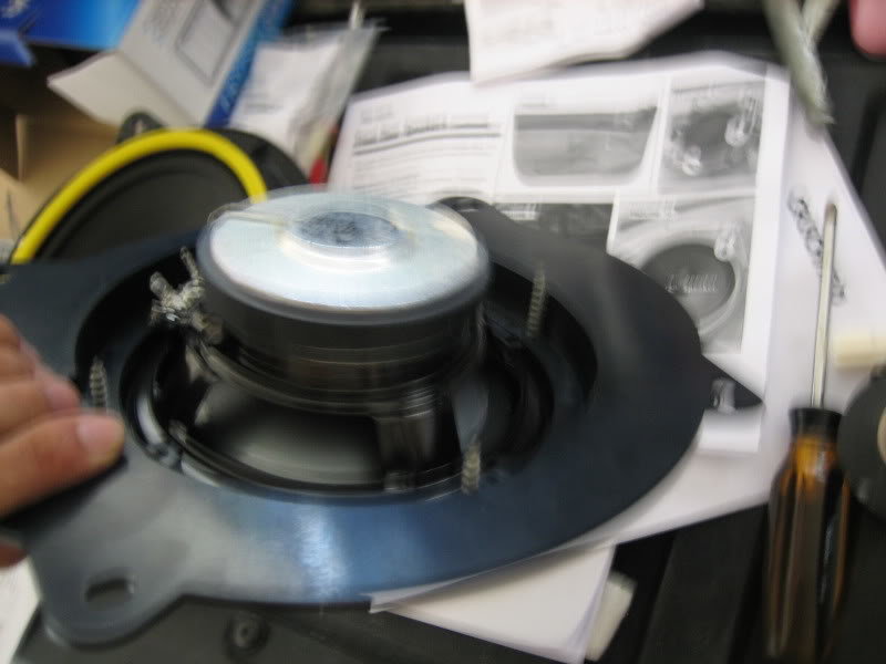

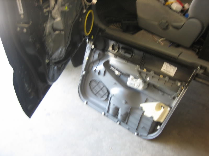

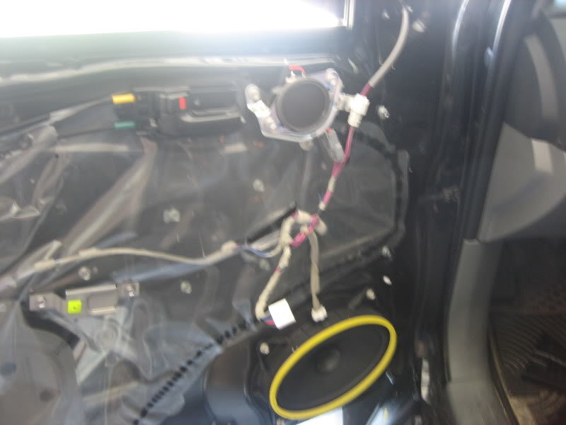

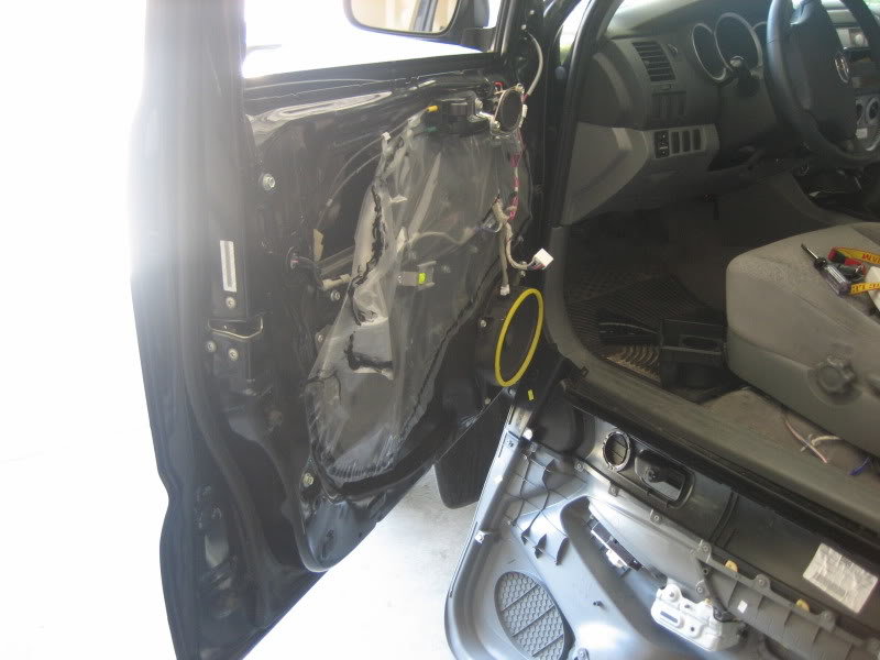

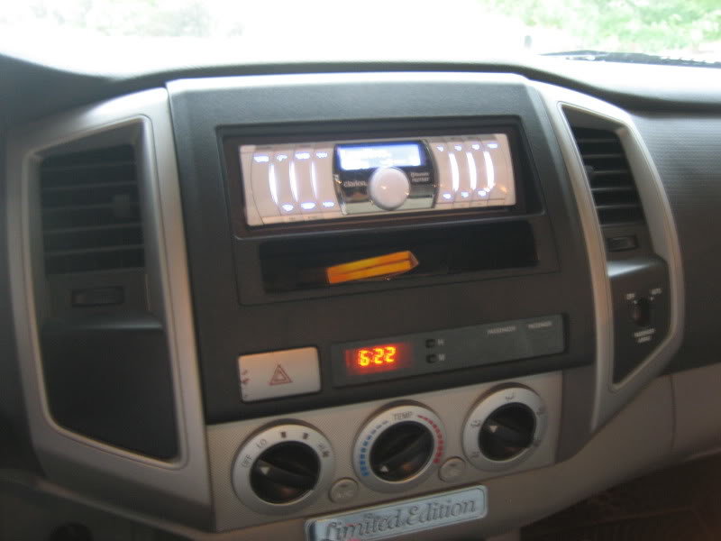

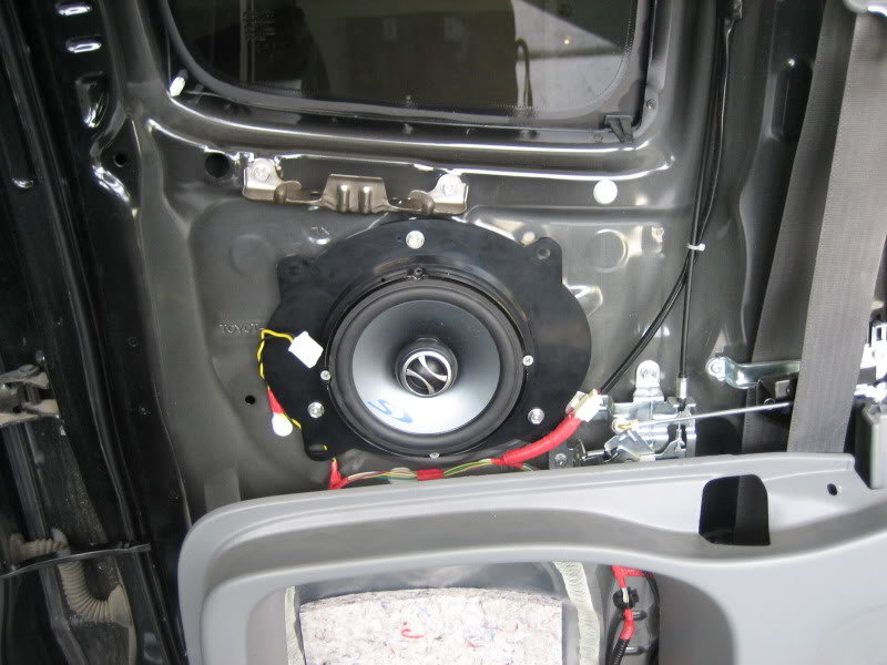

    maverick491 Thanks for your initial post and Crutch field guide, I manage to install all 4 speakers. Should had done it a year a go, but I was waiting for free time. Anyhow I'll post some pics.
    Did you guys know the factory tweeter still works after replacing deck?... I thought they died after I change my deck. I been deceived for a entire year now... :]
    ~I didn't remove the weather strip, didn't really had to.
    Make sure to have a T-25 socket handy
    By crutchfield had all the speaker slot for me =]. The rear I had to make some adjustment that kill like 2 hours compare to the front.

    Soul,
    Thanks for providing the photos. The rear speakers mouning brackets were a bit strange though. What happened, wrong ones sent to you?

    On crutch field website (if I can recall a year ago) they say the 6.5" Alpine S won't fit the rear end so if i chose that route I wouldn't get any rear slots. I decided just buy for the front, twice. (the speaker wasn't sitting there for a year, i just had it on another vehicle, until it died. But i got the slots for the taco)
    They fit, a little snug (I was getting ready to drill some holes just for the tweeter) but nope, no problem.
    If you going to buy off of crutchfield just be ready to extend wires on the right (passenger) side of the car, or you can drill through the slot. Both the rear/front passenger side comes short. It's a faulty design on crutchfield part, the wires (coming out of the slot) always come out on the left. Fine for the driver side, but the passenger side can't reach.
    WARNING Don't connect the wires to the speaker till the VERY END. Those little connectors don't come off easily, and if you use too much force you'll end needing new speakers.

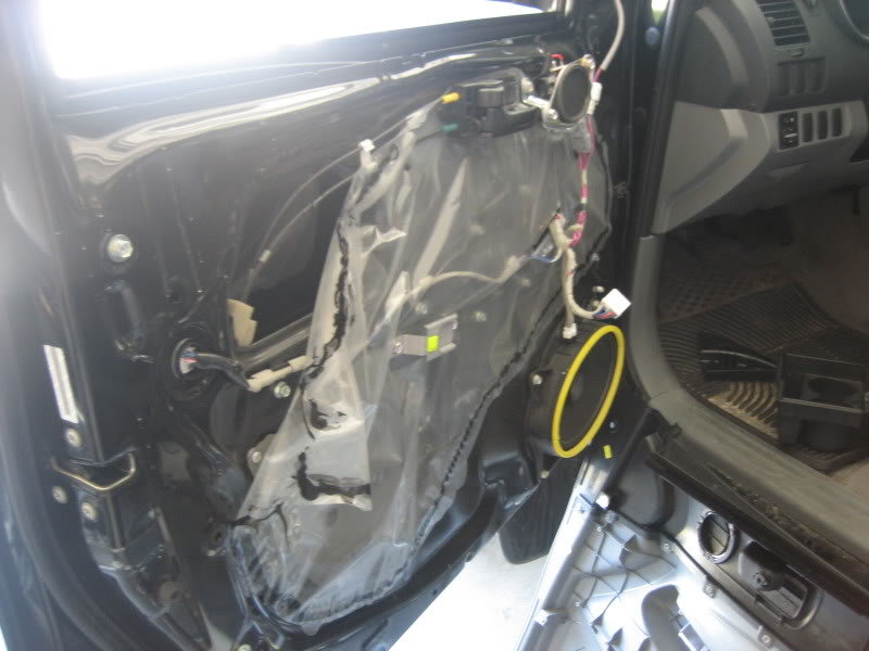

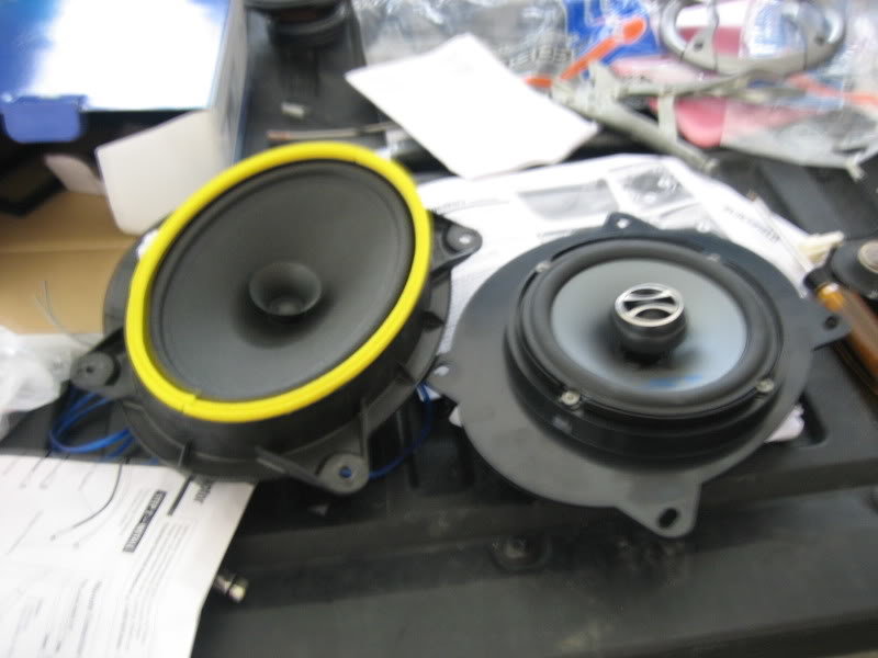

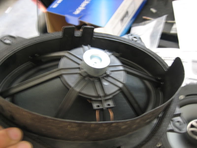

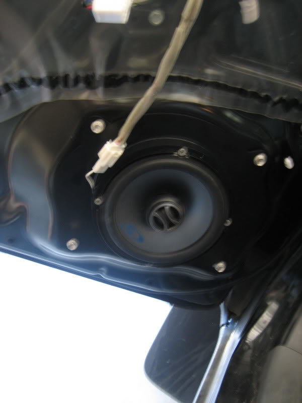

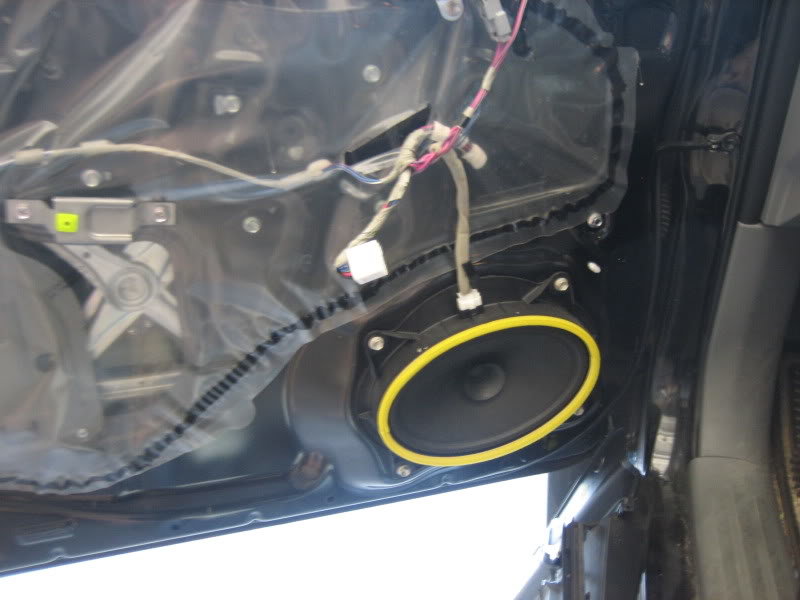

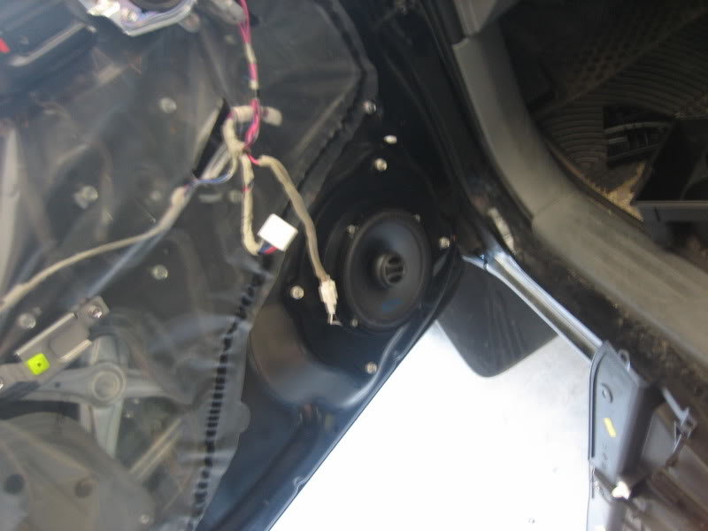

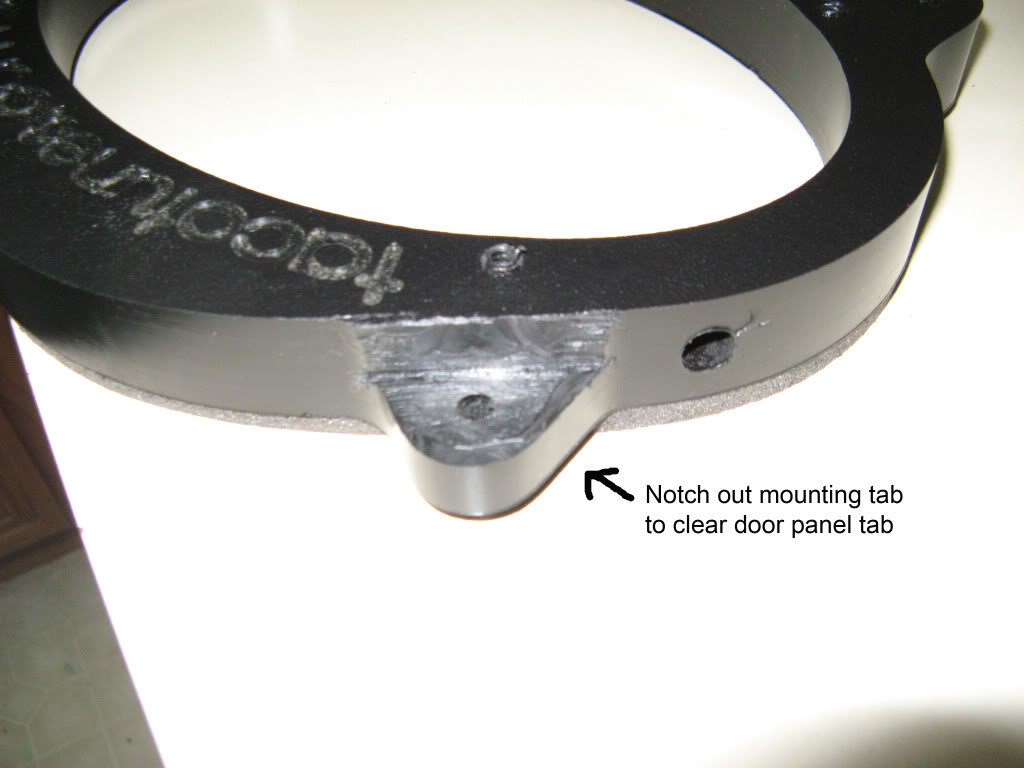

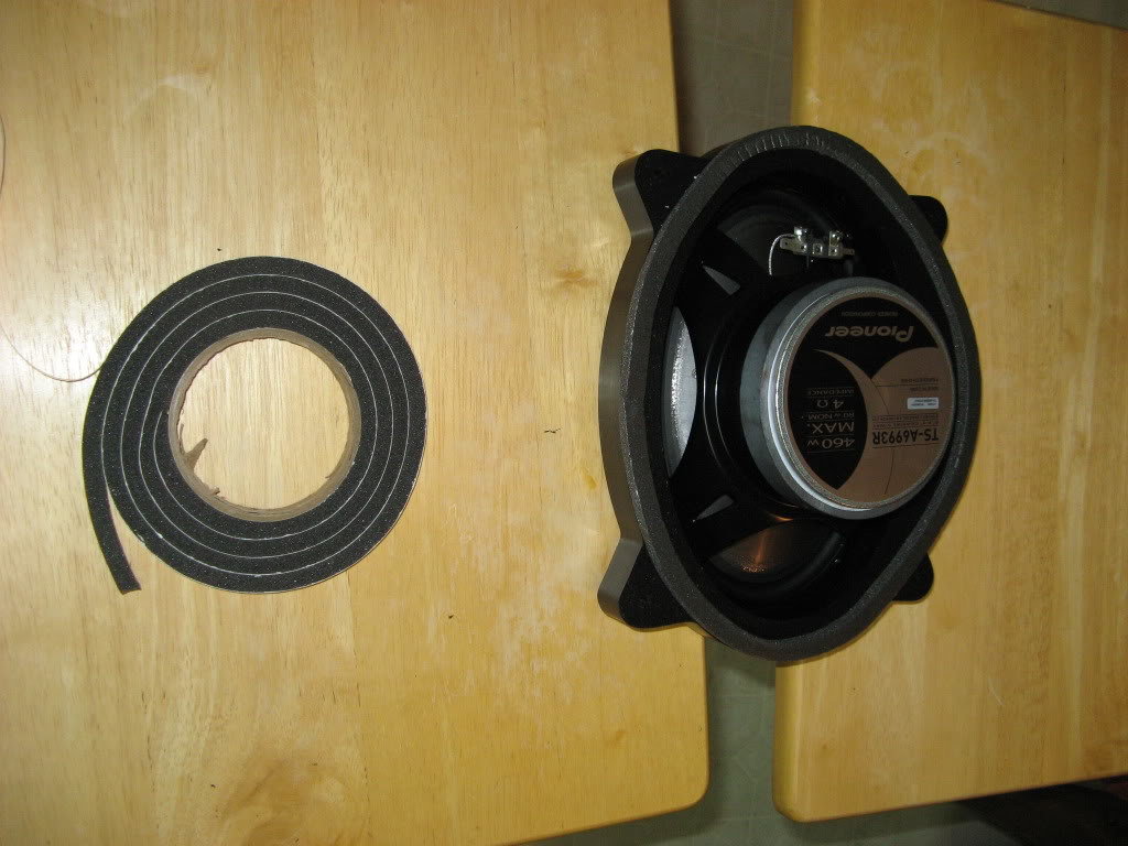

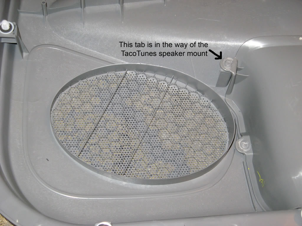

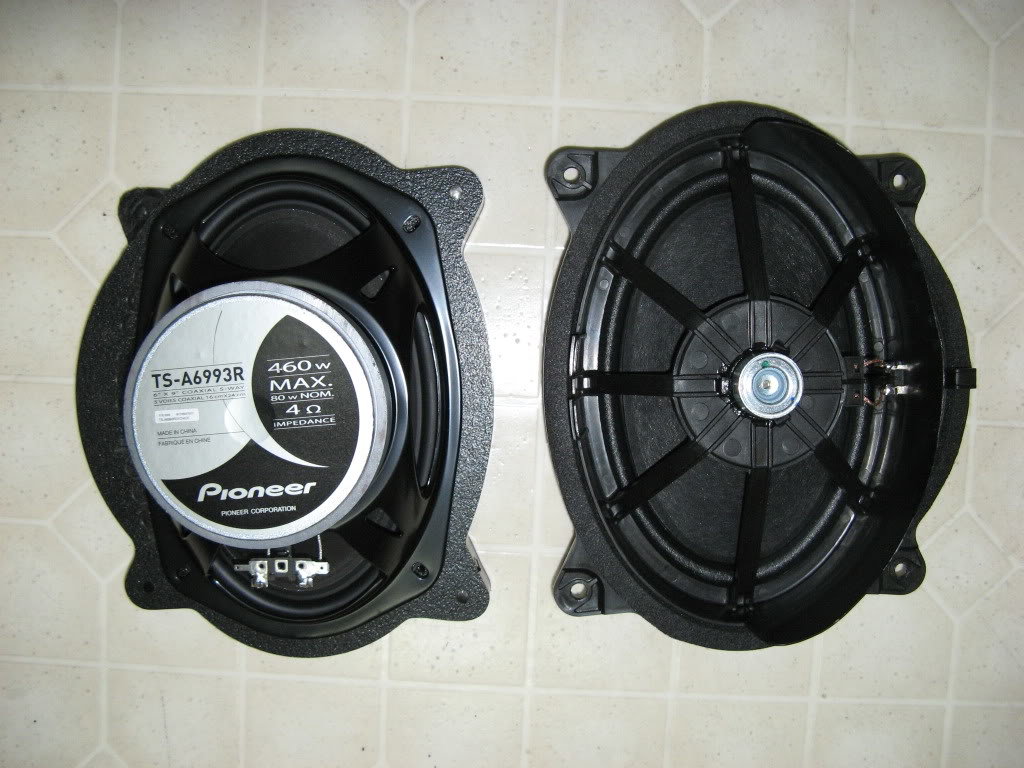

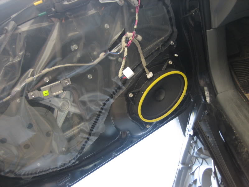

    Great write up Maverick! Here's my 2 cents for a problem I ran into while installing speakers in my 2009 Double cab :
    The front door panels have a tab where the cup holder mounts to the panel that hits on the Taco Tunes mounting adapter.
    I had to cut away half of the corner mount so it would clear the tab on the door panel.
    Now the adapter will clear the door panel tab.

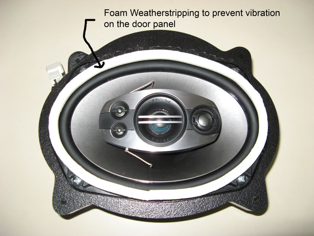

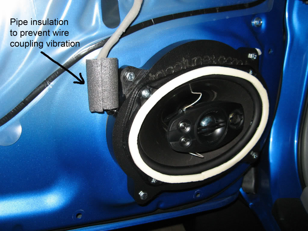

    I used self adhesive foam to provide a seal between the speaker adapter & the door, & to prevent the door panel from vibrating on the speaker. The stock speakers had similar foam trim around them.
    I used foam pipe insulation to prevent the speaker wire coupling from rattling inside the door.
    Notice the difference between the factory speaker on the right, & the Pioneer on the left. The factory speaker basket is entirely plastic & the magnet is about the size of a quarter! The factory speaker weighs a few ounces where the Pioneer is several pounds!
    This is what the weatherstripping looks like. I got it at Home Depot for about $3.
