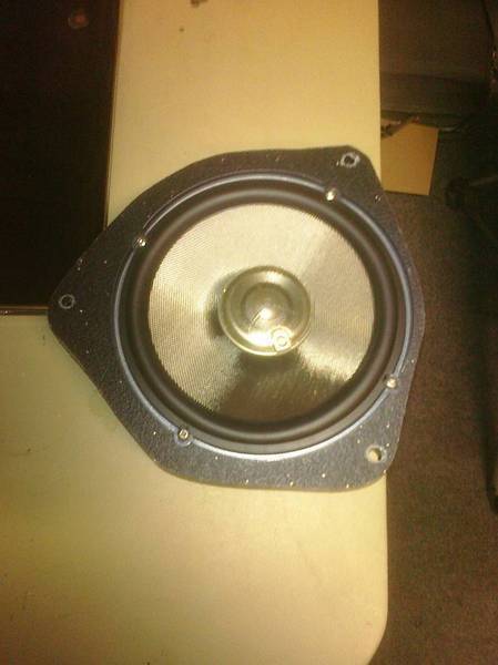

    Good write up. I made my own speaker adapters out of plastic cutting boards I bought at Target. Saved quite a bit of dough that way.
    Rear door DIY speaker adapter.

    NICE!!!! what isle in Target?
