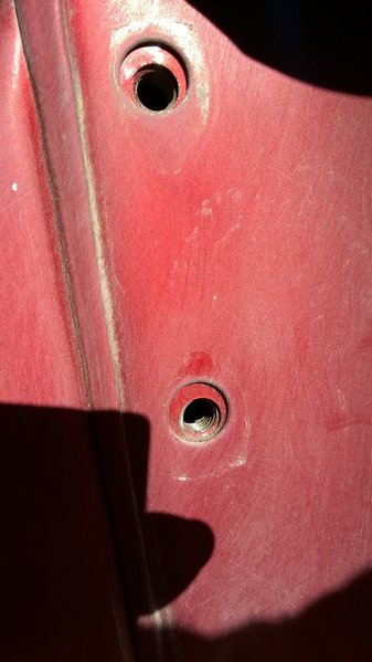

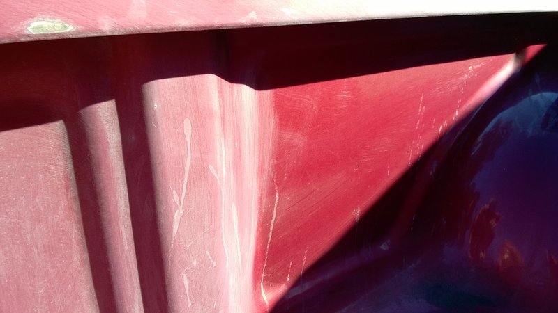

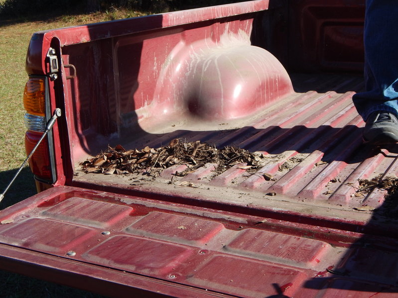

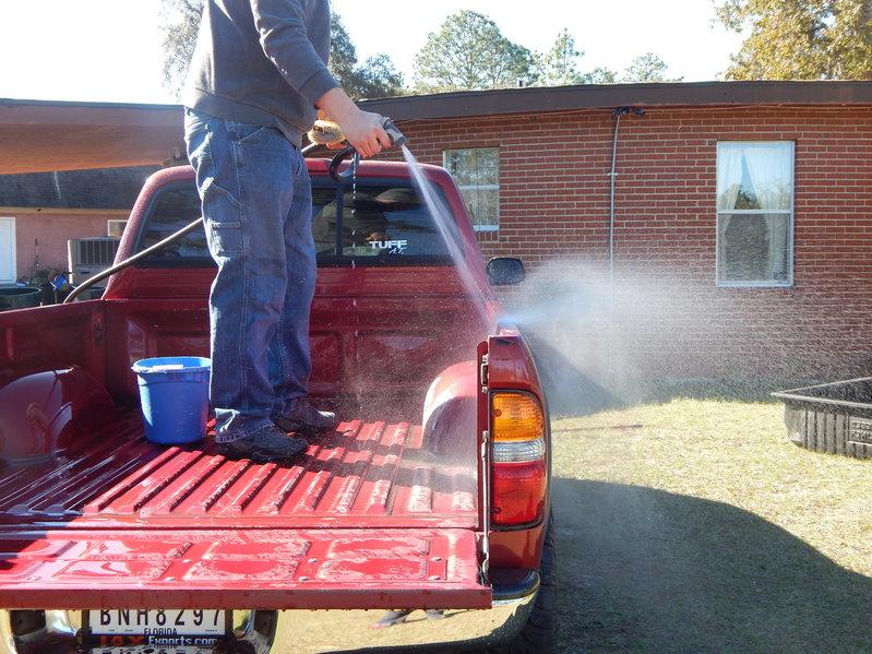

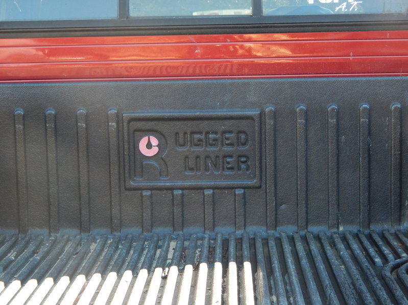

    I have been wanting to remove this old plastic bed liner from my truck ever since I bought it.
    Well I'm on vacation now and it's time. We thought we would try and use a product we saw online called Herculiner. I will post some pics for each process. Today we will clean the bed and sand any rust spots. Its amazing what gets stuck under these bed liners causing rust. I had some help :rasta:

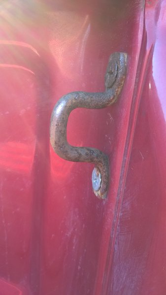

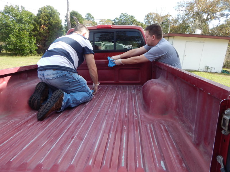

    Yep about 20 quarter size spots right where the old plastic liner was rubbing away the paint. Just some surface rust it all sanded out pretty easy. All of the bed hooks are rusted along with the bolts. I tried cleaning one off and I wouldn't say they are rusted all the way through but holy crap not worth the effort. I will pick up some new ones on Monday at the dealership. Just finished scouring the whole bed and sanding the rusted spots.
    out. Took about an hour only because of the rust spots.

    I'm not sure how long its been in there. I'm pretty sure the original owner put it in in 2003. He lived in Virginia for about a year then moved to Jacksonville florida where I bought it. It pretty much sat in the navy yard and only has 65k miles on it. There was a ton of crap under it though. Leaves pine needles sand and mud dobber homes. I actually expected it to be much worse than it was. The plastic liner looks like almost no one has ever even used the bed for anything. Not a scratch on it. I'm going to put it out by the street and hope someone steals it haha. My buddy is coming in from Afghanistan tomorrow so the rest of the project will have to wait until wed. or so. I will post more pics when we clean the bed with Acetone and start brushing on the Herculiner.

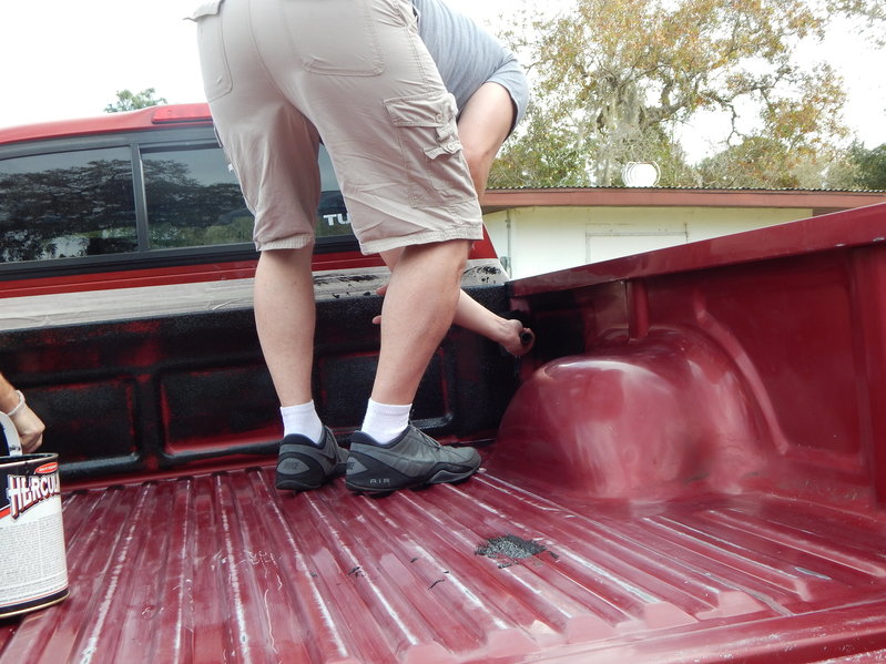

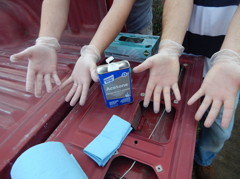

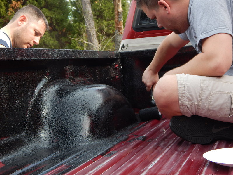

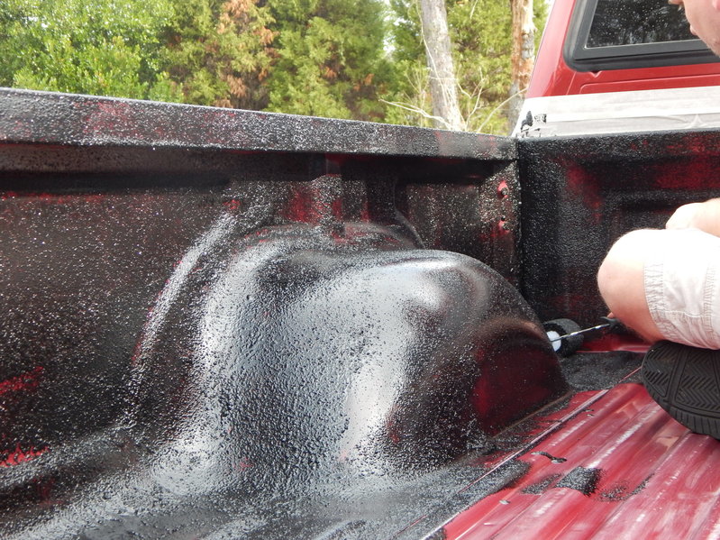

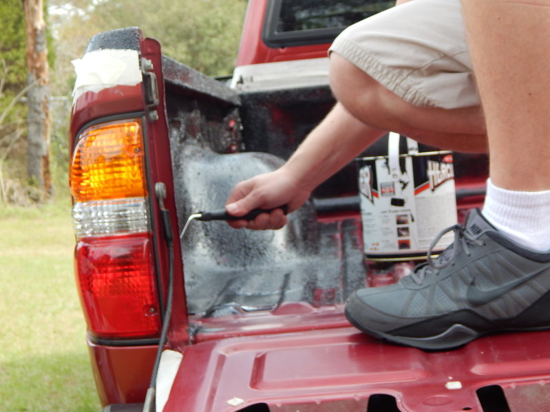

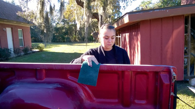

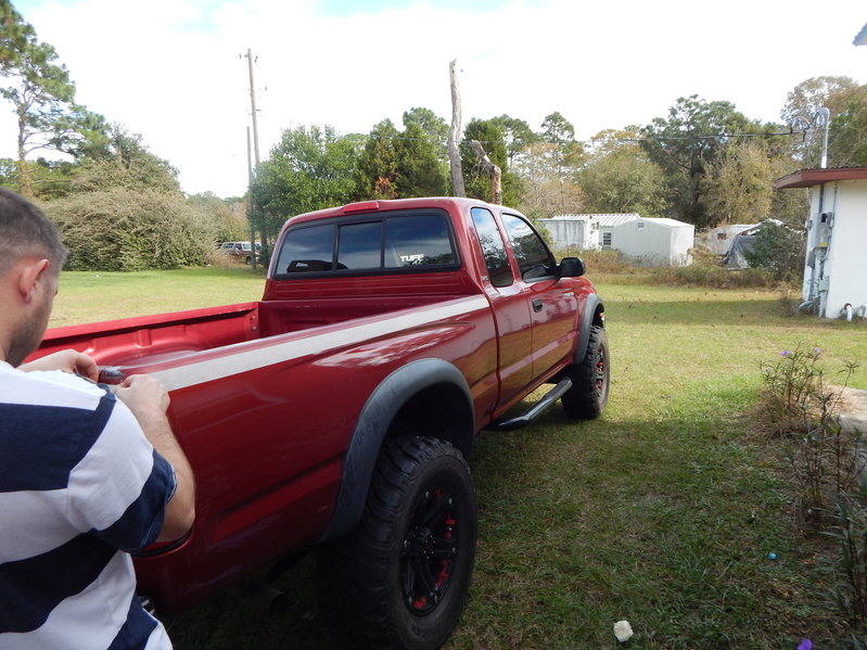

    So we started pretty early in the day. Picked up some new washers for the tailgate and a box of Herculiner after our morning coffee.
  19. Dec 21, 2015 at 5:55 PM
    #19
    JKO1998
    JKO1998 Well-Known Member
    Jun 2, 2015
    #156578
    52,889
    Utah
    Did you scuff up the bed or am I just getting ahead of myself?
  20. Dec 21, 2015 at 5:59 PM
    #20
    TuffTaco03
    TuffTaco03 [OP] Well-Known Member
    Nov 30, 2015
    #171068
    113
    Steven
    Citrus County Florida
    2003 Tacoma SR5
    Does new Wheels count as a mod? lmfao

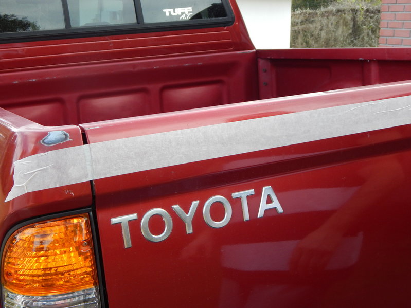

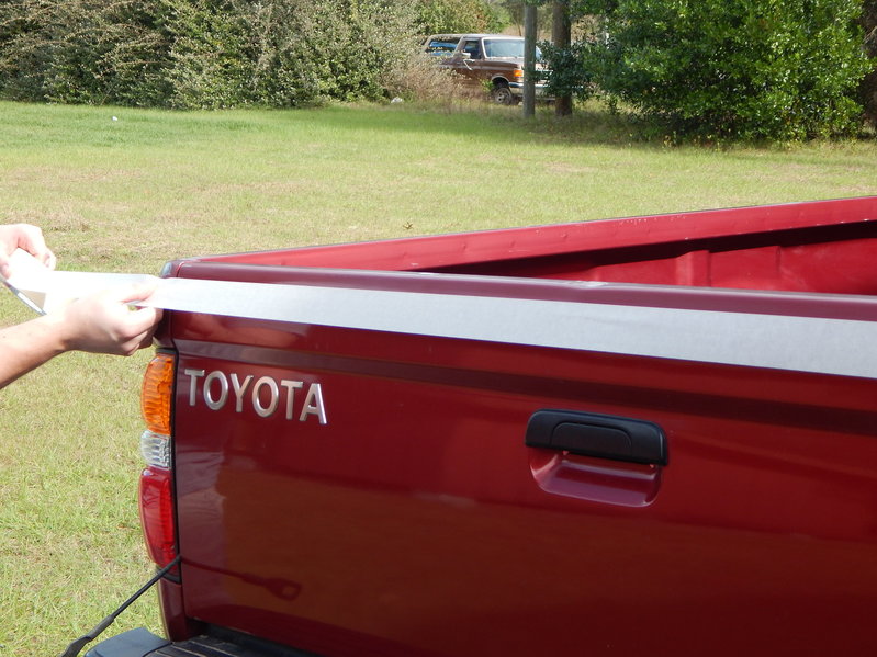

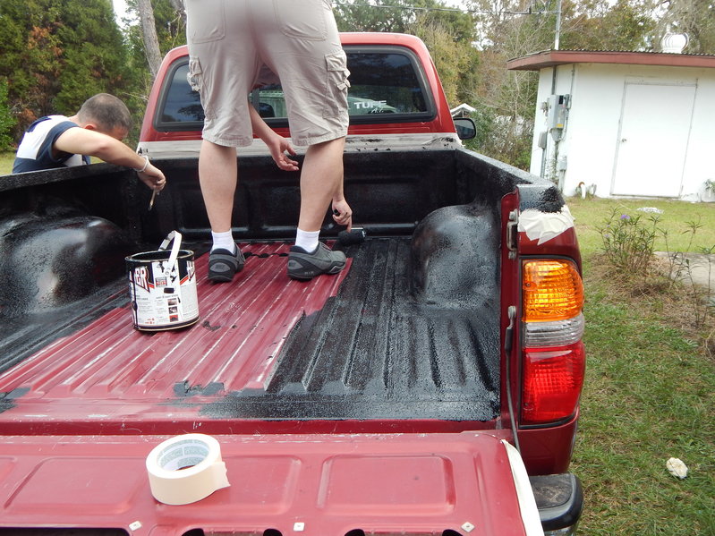

    Taped off the bed and cab so we wouldn't make too much of a mess.

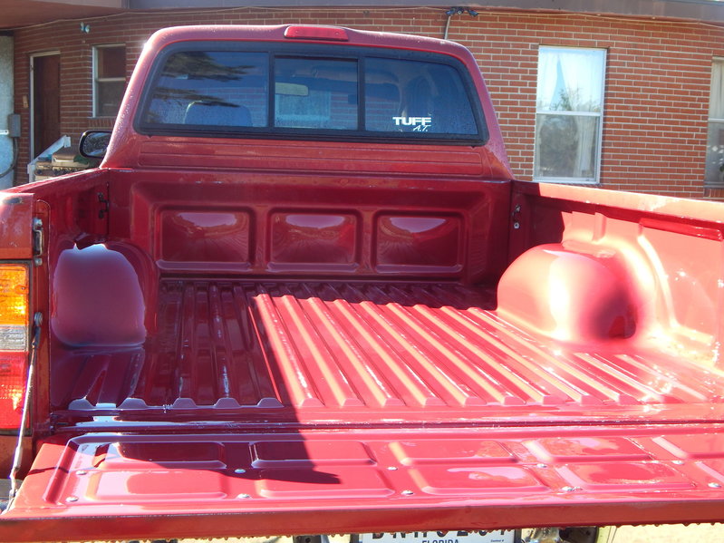

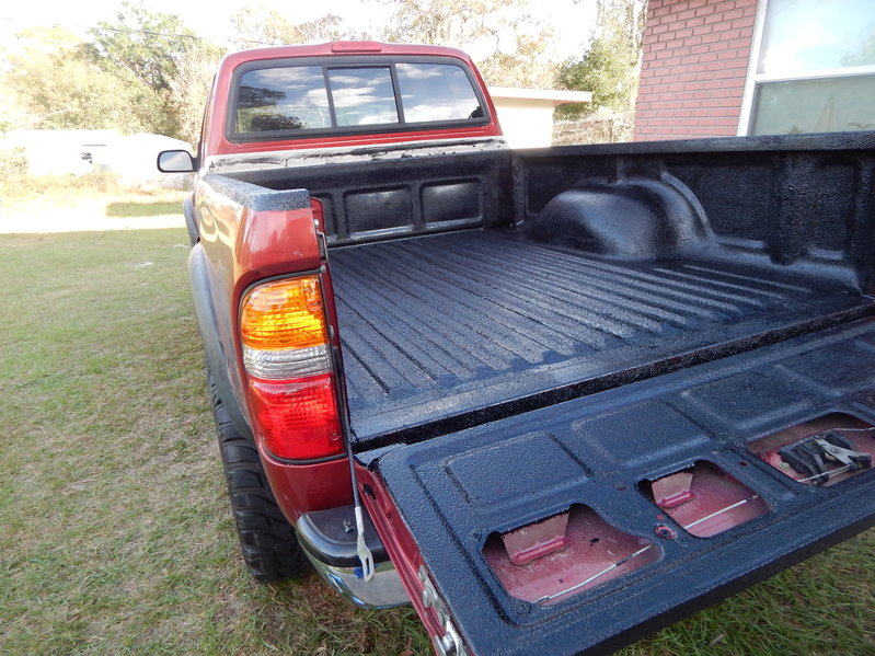

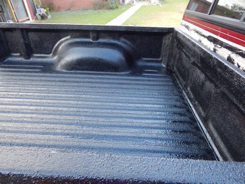

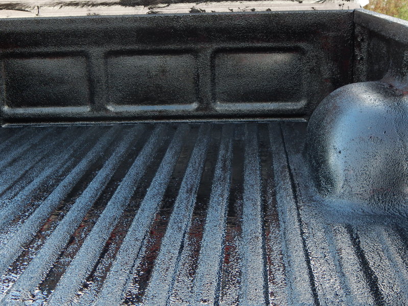

    Then we got to painting.
    DSCN2054.jpg DSCN2055.jpg DSCN2056.jpg DSCN2057.jpg DSCN2065.jpg DSCN2068.jpg DSCN2075.jpg DSCN2103.jpg DSCN2111.jpg DSCN2119.jpg DSCN2123.jpg DSCN2124.jpg DSCN2129.jpg

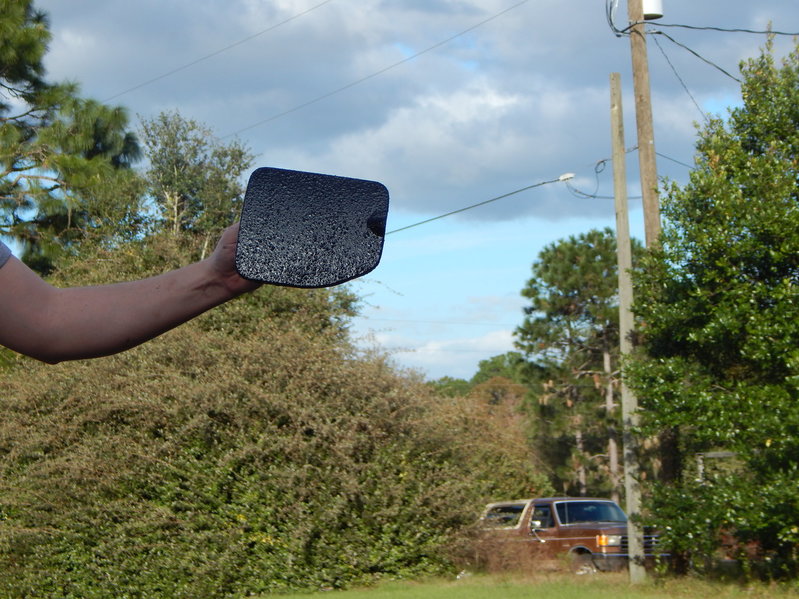

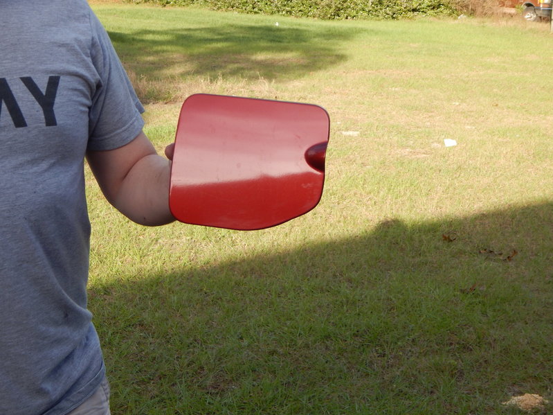

    Yep I did the fuel door... I'm not sure why I couldn't help myself. Lord I apologize please send me with the pigmy's in new.....
    A couple hours between coats and a lot of video games and its done. If it's not raining tomorrow ill take some finished pics.
