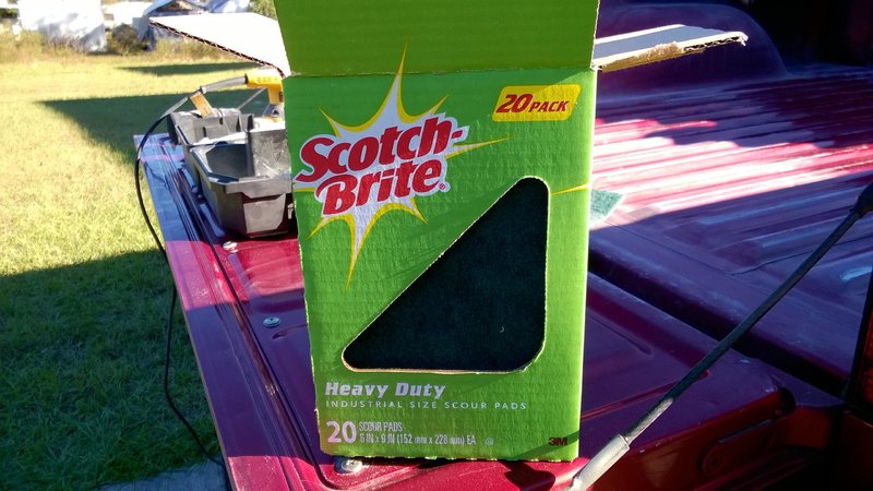

    yep we did that a couple days ago we used the scotchbrite pads my wife just happened to have a sams club box full of them lmfao. She is like a human swiss army knife :duel:

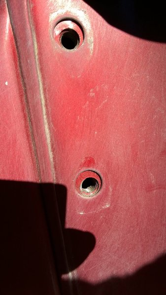

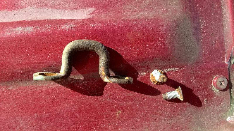

    I forgot this step in the thread lol. This one is important. We spent about an hour scuffing the bed with these pads. We tried to sand and clean the bed hooks but they were the only big loss in this one. Went to the dealer and picked up some new ones. They were cheap no biggie.

    we scratched until the shiny of the clear was gone. We also sanded all the surface rust spots completely to the metal. With 2 1/2 people it went really fast. Ok she isn't half a person just little :lalala: It really just need some ruff clean spot to attach to.

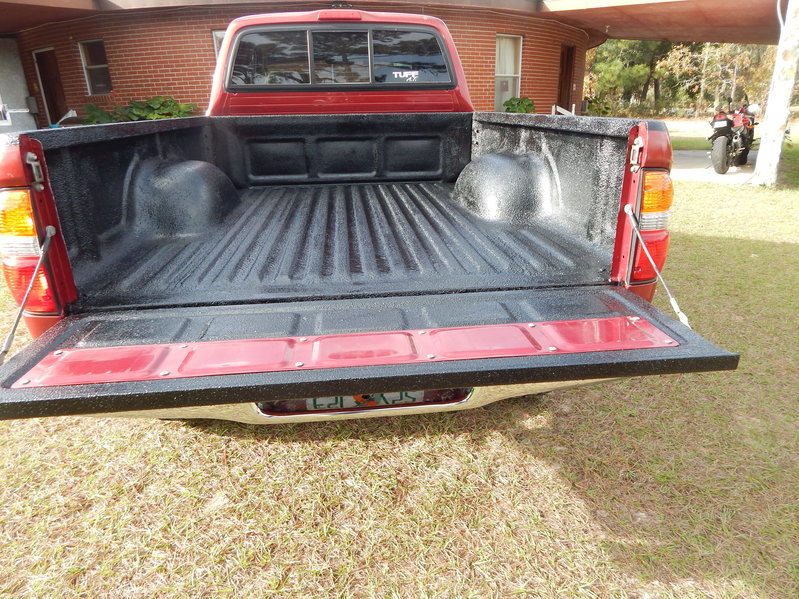

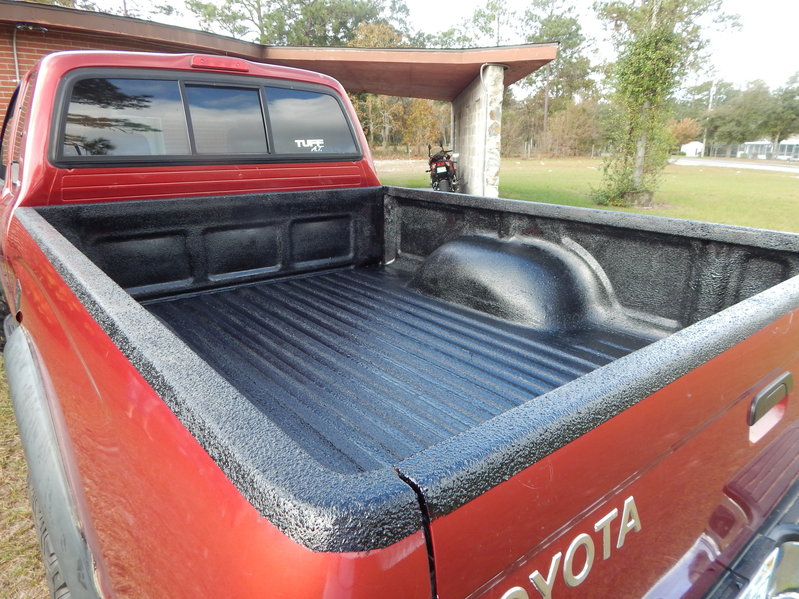

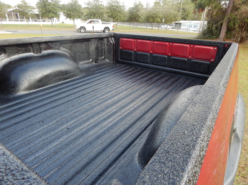

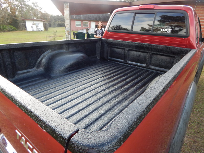

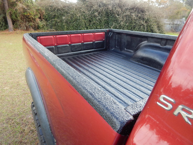

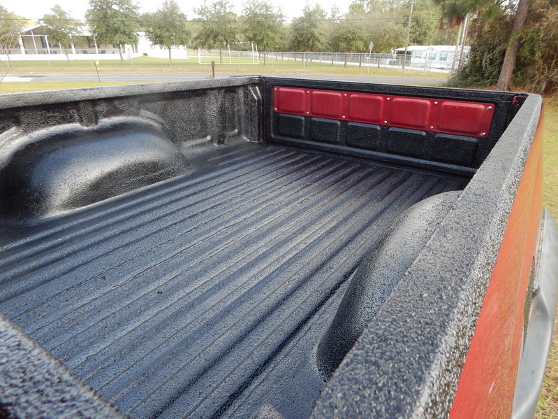

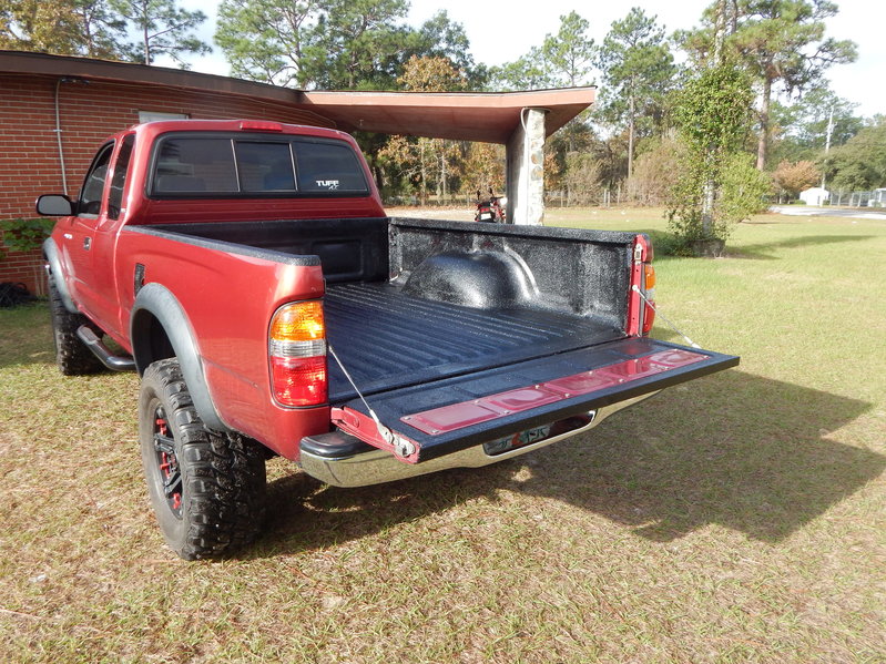

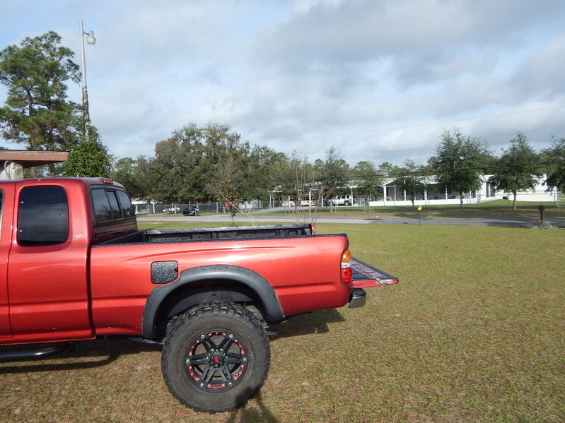

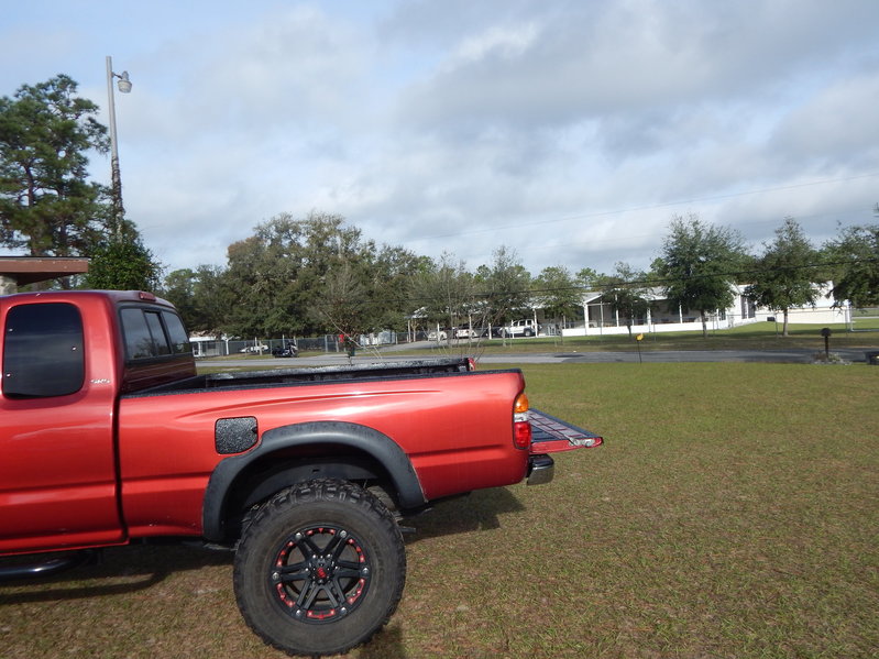

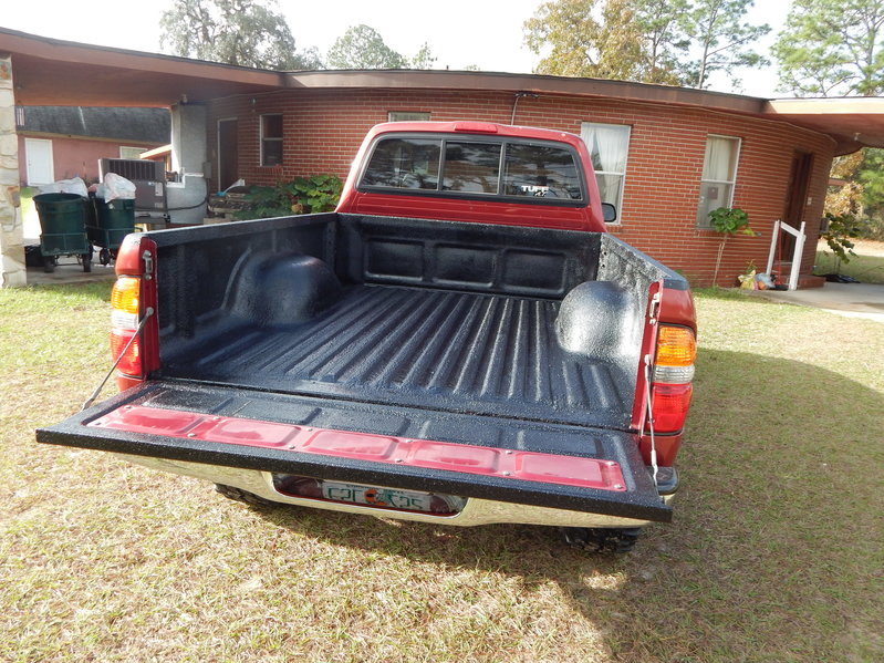

    Final Product. It came out pretty good I think. Still waiting on the new bed hooks but application is done and dry. It still looks wet but its not.

    looks great, that shine will probably take a good 3 months to go away.
    how many coats did you put on and how much paint did you end up using?
    and why didn't you do the tailgate inspection cover? I understand you may have been going for a "look" but that's the #1 spot that gets all the abuse and needs the coating the most. you could always repaint it red after coating it.
