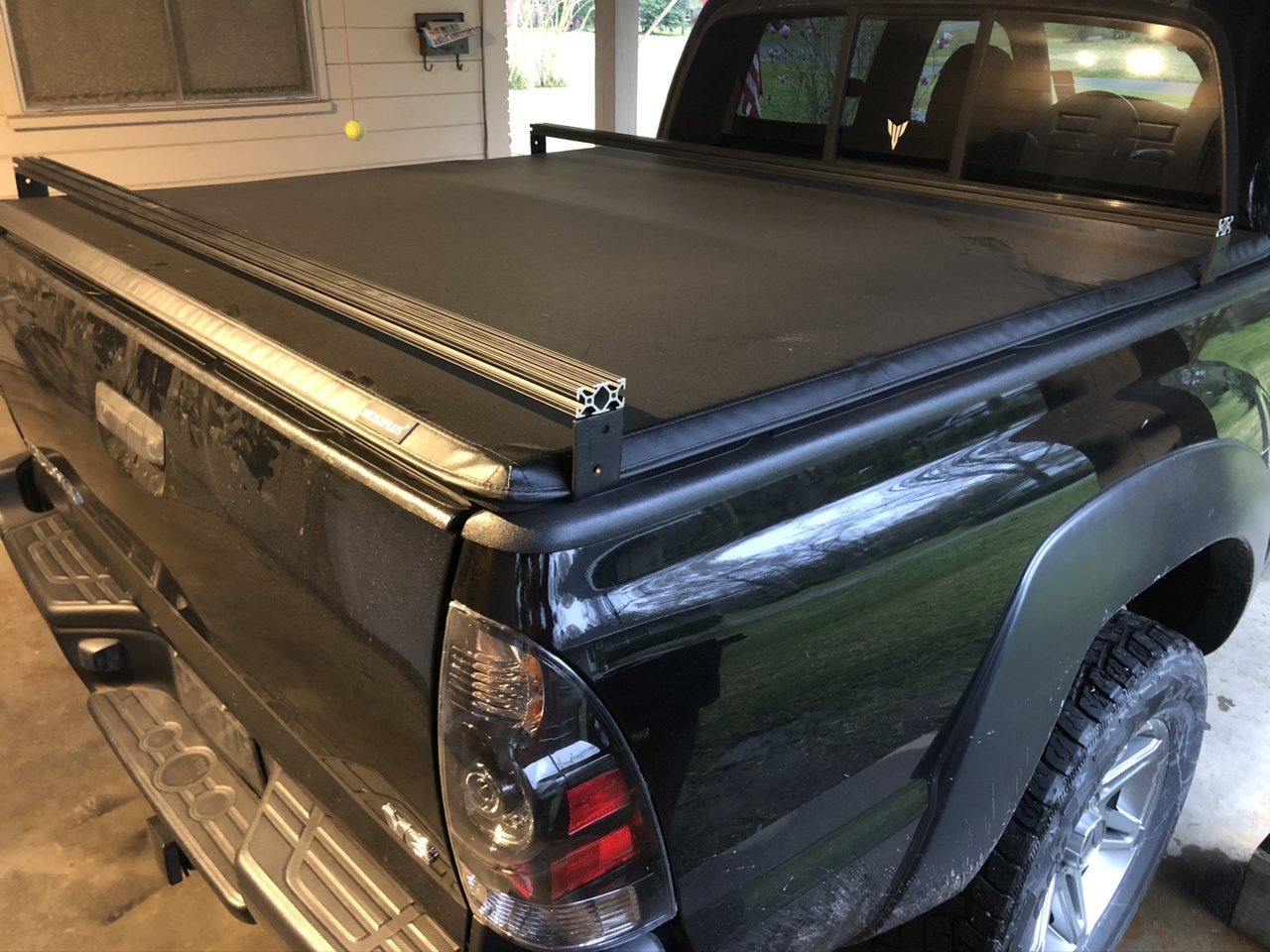

    Sweet. I used the same extrusion and a series of L-brackets to get mine to work with a tonneau. I use mine for kayaks, bikes, and with a basket to haul hoses for work. Power to the DIY people! Also, 1/4” carriage bolts from any hardware store work great, too! Lol

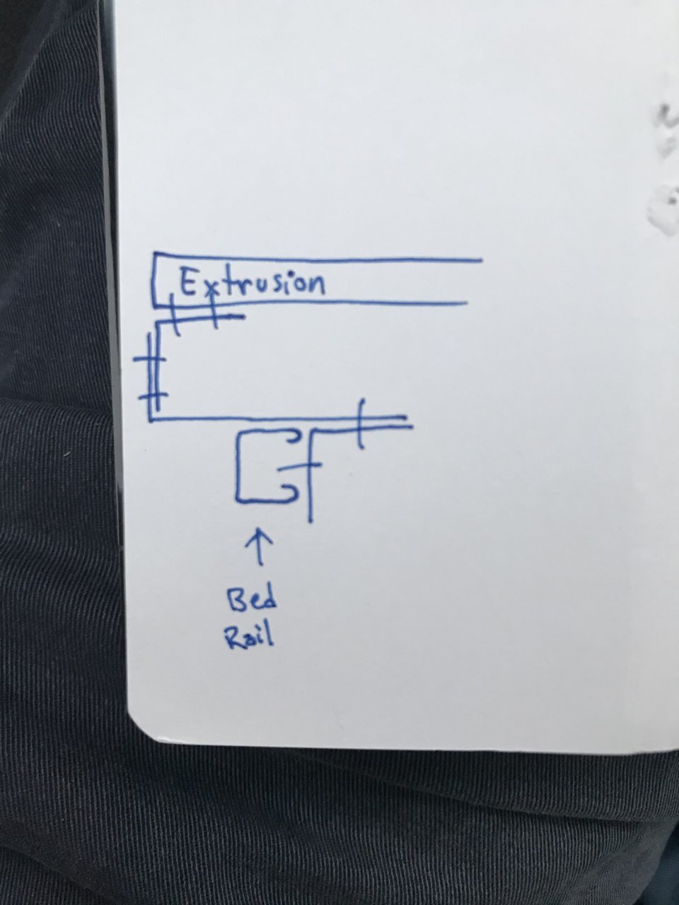

    Mind sharing your L-bracket setup/parts list or some up close pictures?
    I want to be able to carry some bikes over my cover - kb voodo and similar options are overkill and over priced for what I need.

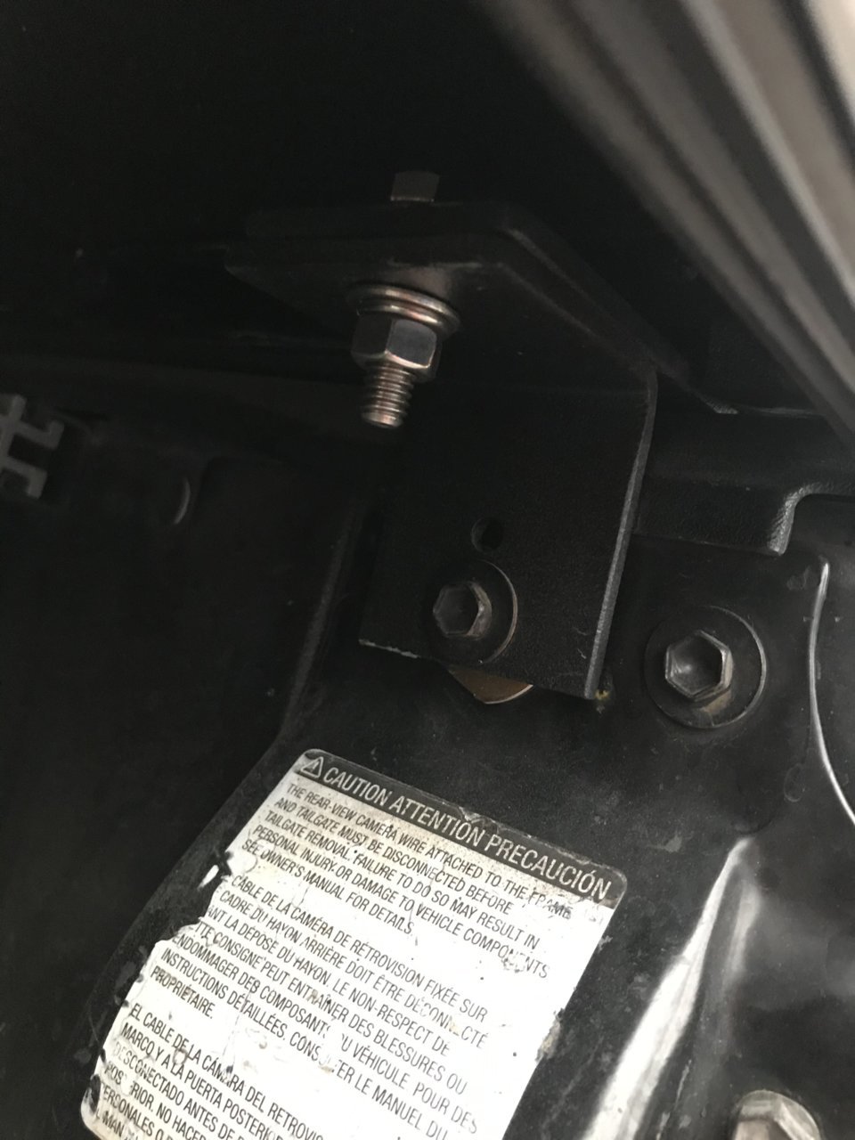

    I got the extrusions from McMaster Carr which were about $100 for both of them. The hardware all came from Lowe’s which will be about another $40. I got the L-brackets from work and cut/drilled them as needed, so you will need to find something similar. A series of 3 L-brackets is not as clean as the S-systems from KB voodoo, but you can customize this however you see fit. It also sits pretty low to the tonneau which is what I wanted.
    Also, I mounted the front rails to the bed rail system, but the rear-most rails are mounted to one of the bolts closest to the tailgate on the part of the bed where people usually mount bed stiffeners (see picture). This provides more of a gap for stability with kayaks and such.
    Then, there is a 5’ piece of strut for each bike across these bed rails (around $20 at Lowes’s). BTW, 1/4” carriage bolts slide in the extrusions decently well if you want to save some money from buying the hardware from McMaster Carr.
    Feel free to PM me if you want to talk about it more.
