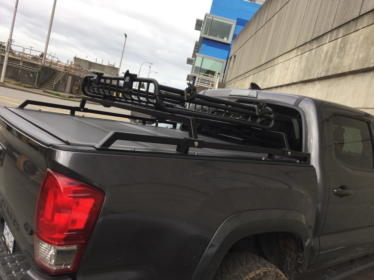

    I had trouble finding something that worked with the backflip mx4 tonneau and allowed me to utilize full bed if needed.I made rails to bed sides and some cross bars to mount RTT or Basket.

    Looks amazing!!!! You could sell those. What kind f bolts did you use?

    3/8 316 tainless Steel mounting hardware, rack was 1-1/4” aluminum

    I removed the plastic bed caps to find the voids on the top to make sure I hit metal. then drilled out the bare metal bedside and installed RIVNUTS and used epoxy an let it set for 24 hrs. the bed material is actually decently thick and the RIVNUT grabbed really well. then I drilled out the plastic cap and re assembled. I used double sided sticky 3M tape before putting the plastic bed cap on so it didn't shift around. worst part is getting over the fear your gonna mess up your new truck haha.

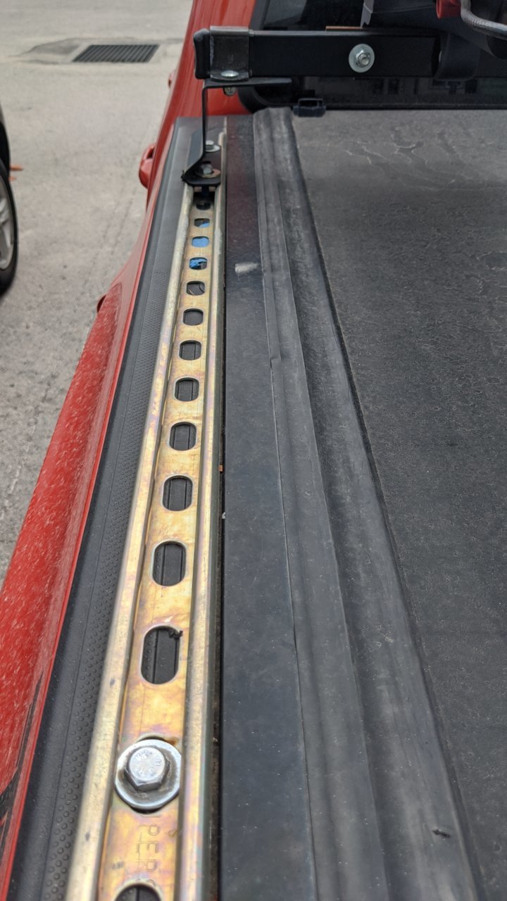

    Curious on the details to bolting through the bed rails specifically the access. I’m interested in bolting my shell down to eliminate the clamps. I like how your setup turned out. Unistrut is great.
