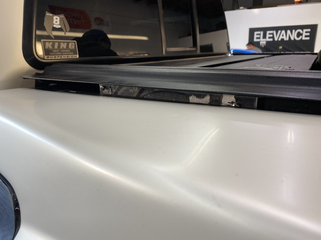

    There should be a fiberglass lip around the tail light area where it hangs over the bedside channel. That lip at the top near the tail lights, where two bolts go through, should be fit on the inside of the bedside sheet metal channel. That should close up the 1/2" gap that you're having. Hope this makes sense

    Thanks! I’ll give that a shot tomorrow

    with fiberglass its hit or miss. ive seen some glass line up real nice and others have really bad fitment. i happened to get a poor fitting pair. got a gap in the same spot around the tailights

    Bedsides are on and looking pretty good! Gap cleaned up a lot with some minor trimming.
    Next question: I have a gatortrax bed cover but it’s also not fitting well. Anyone else have similar issues?

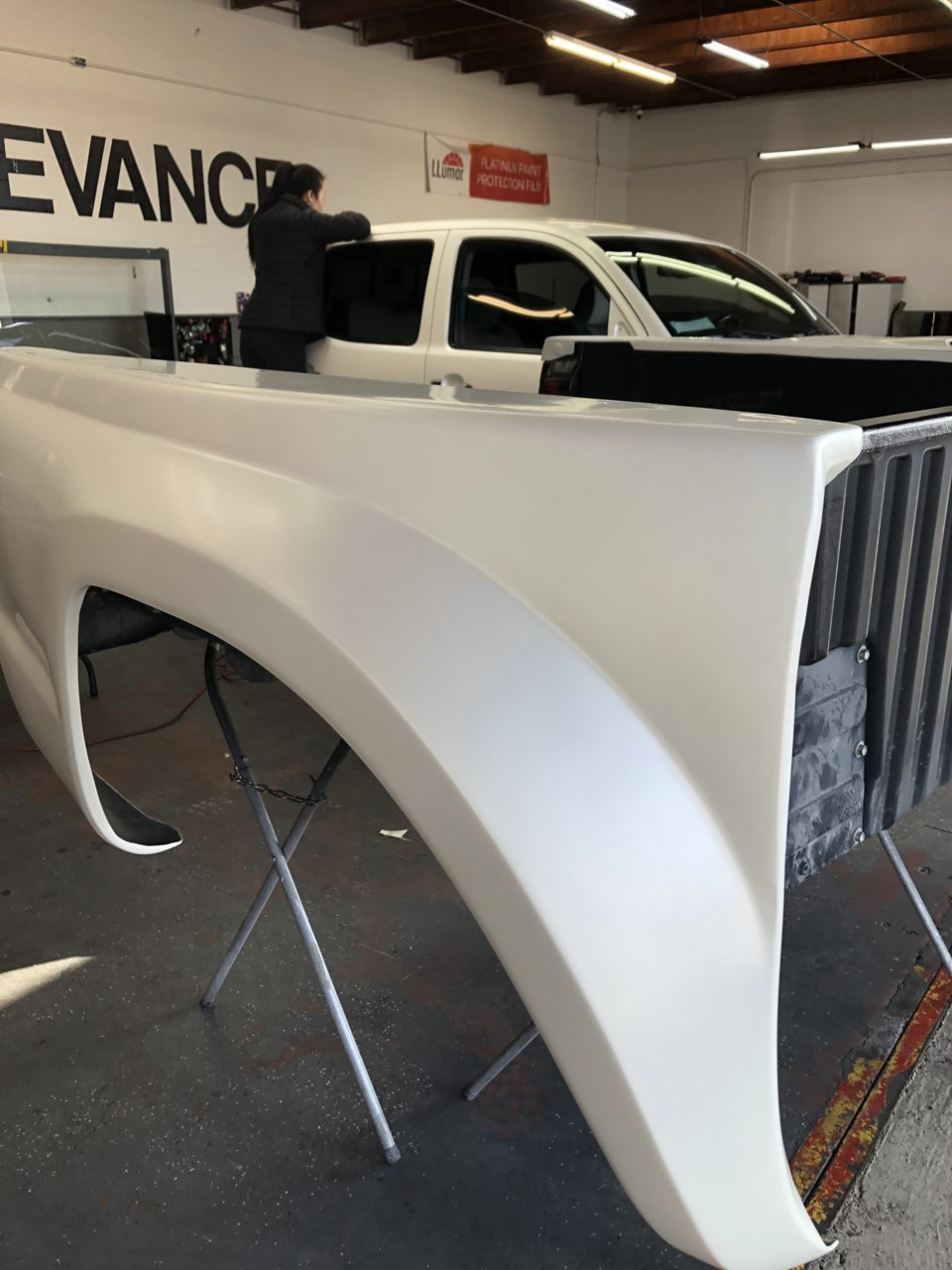

    And just an update of where we are! Should be getting it home in a few days!

    13Taco, what color and brand of vinyl did you go with?

    3M 2080 Satin Pearl White

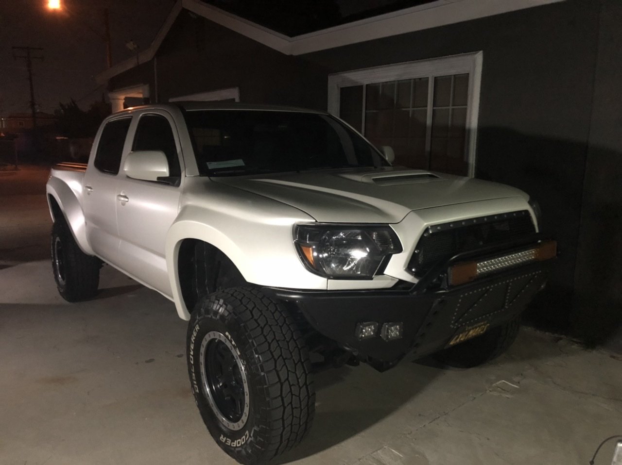

  9. Dec 18, 2020 at 9:36 PM
    #69
    13Taco
    13Taco Well-Known Member
    Jul 9, 2012
    #82214
    133
    Alex
    Long Beach, CA
    2013 DCSB OFF-ROAD
    King shocks front and rear

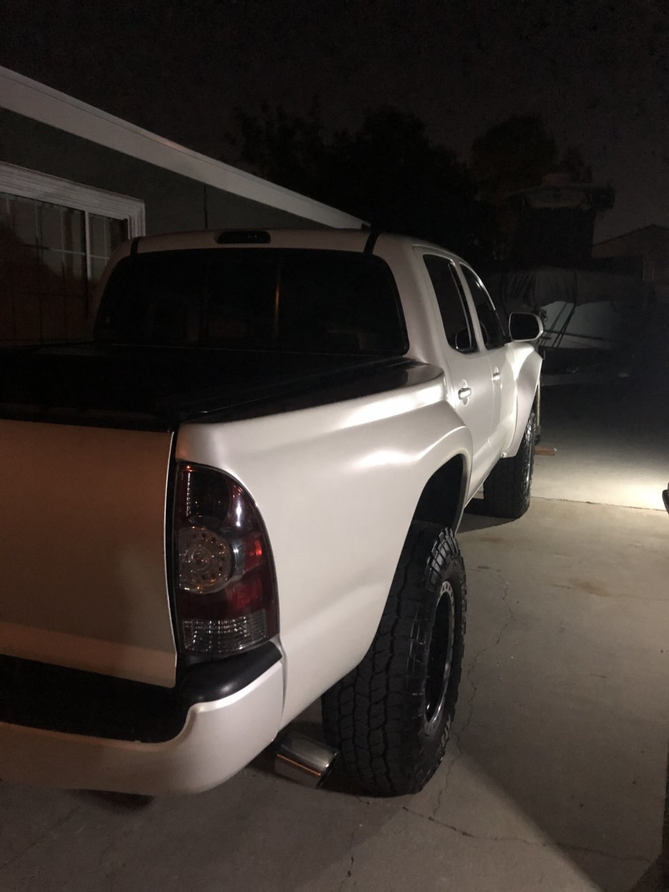

    Finally done and home. Picked it up at night so the lighting conditions are not optimal.
    superman2481 and OneMentalCase like this.
  10. Dec 19, 2020 at 7:27 AM
    #70
    OneMentalCase
    OneMentalCase Well-Known Member
    Dec 25, 2009
    #28132
    295
    South Florida
    10 Pyrite LB
    The pearl white looks great!
    What size tire you running? Spacers?
    Is that black vinyl on top of your bedsides?
  11. Dec 19, 2020 at 9:21 PM
    #71
    13Taco
    Jul 9, 2012
    #82214
    133
    Alex
    Long Beach, CA
    2013 DCSB OFF-ROAD
    285/75/17 and just put 1.25” Bora spacers
    no black on top, just the lighting. I do have a roll up bedcover that has some black on top but the picture is misleading
    OneMentalCase[QUOTED] likes this.

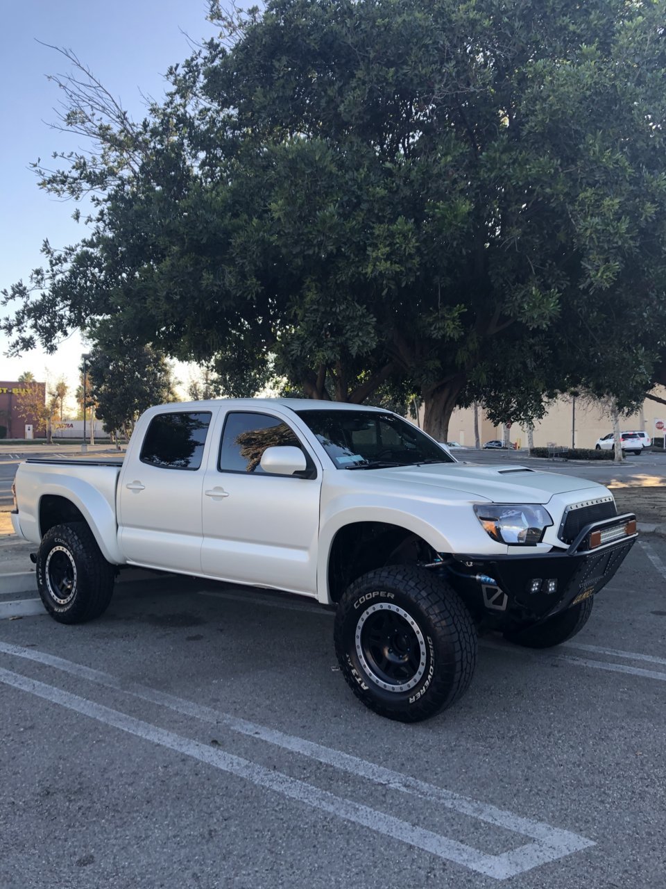

    Better daytime photo with the spacers
