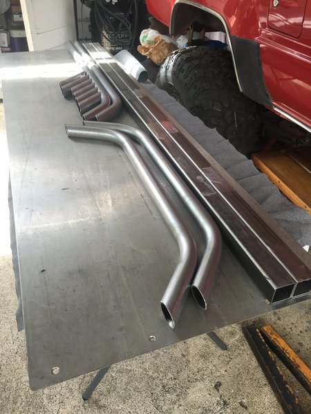

    Called mc knight steel
    Square 1.75 .12 wall $4.39/ft
    Square 2" .12 wall $4.43/ft
    Round 2" .12 wall welded $4.07/ft

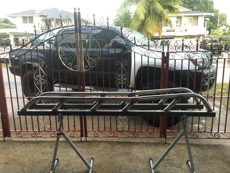

    wisDOMination
    wisDOMination Well-Known Member
    Aug 11, 2009
    #20996
    109
    Marc
    Hawaii
    2009 DCSB Tacoma
    Big thanks to 1 bored clerk for the file!
    Really saved me a lot of time from having to make my own template.
    Tryna figure out if I should add one more leg out back for a little more support. Then gonna drop it off to get powdercoated and hopefully get them on the truck

    1 Bored Clerk
    1 Bored Clerk [OP] Well-Known Member
    Sep 18, 2013
    #112786
    1,999
    Vancouver, WA
    '13 4x4 AC TRD OR
    Nice shots of the build! Love it. Nice design too.

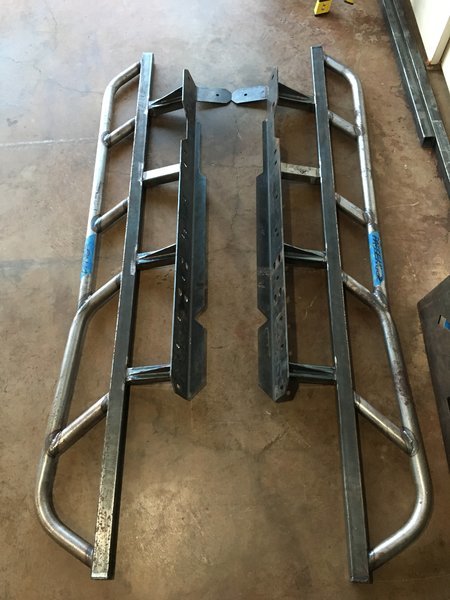

    Radioactiv
    Radioactiv Well-Known Member
    Feb 20, 2014
    #123567
    401
    Georgia
    2015 DCLB 4X4
    Cut mine today on our 20yr old plasma table. I didn't have any 3/16 scrap long enough for the DCLB so I used 1/4".
    Just got to go get the press brake setup when I get time. Also cut my friend some plates since we will be fabbing these up as a weekend project.
