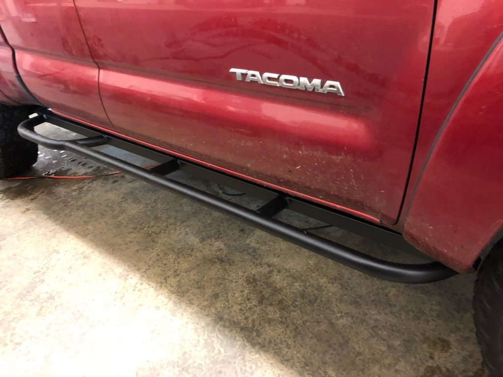

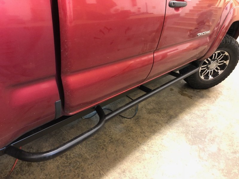

    Finally got them installed! Pretty stoked.

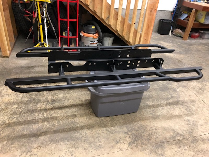

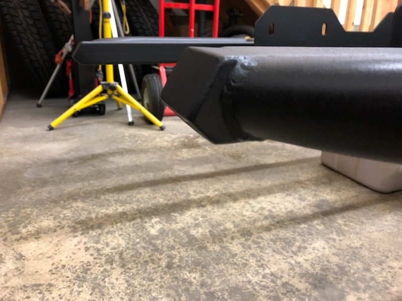

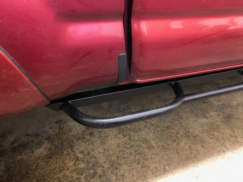

    I got mine back from powdercoat.
    They're a little flimsy, as the supports deflect a bit when I'm standing on them and bounce, but the frame plates are great. I also wish I made them stick out a little farther from the doors, but oh well. Hopefully they work ok.
