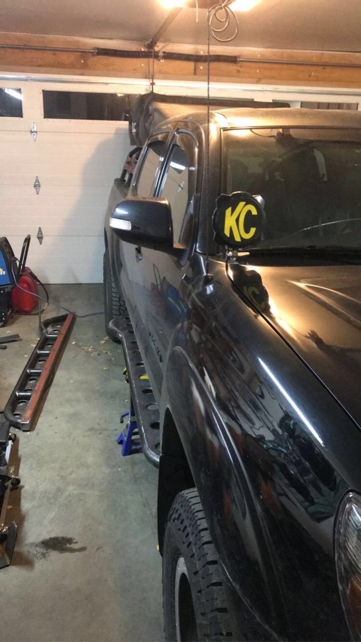

    I feel yah on that. I was just curious I couldn’t make up my mind haha. I just got it all bent right now actually. Very happy with it. I’ll post pictures of my progress soon

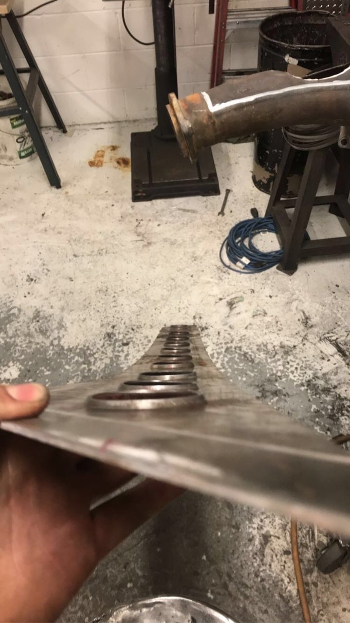

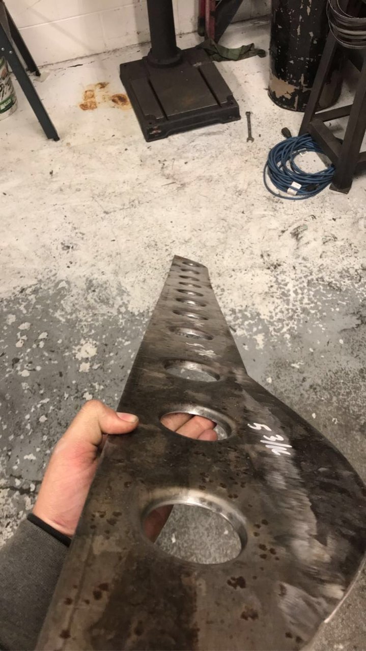

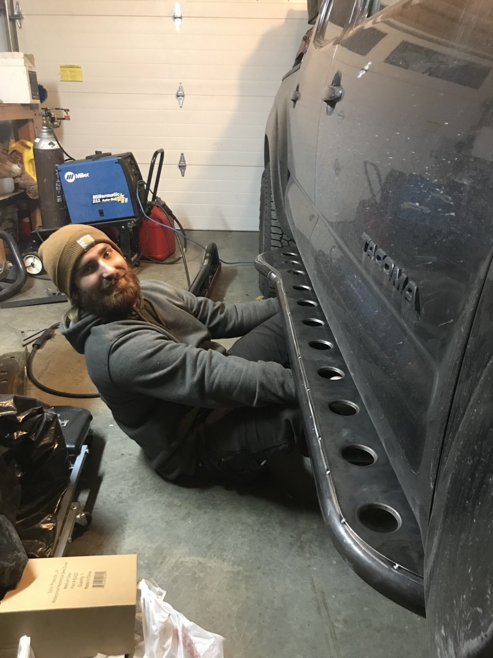

    I’ve been slacking lately. Been busy with work and life. They are almost done. Should actually finish them tonight. But I’ll share what I’ve got done now!
    Stryker420[QUOTED] likes this.
  10. Nov 10, 2019 at 4:27 PM
    #490
    Ak-Alex
    Ak-Alex 2015 TRD PRO
    Sep 20, 2015
    #164772
    50
    Alex Kiely
    Fairbanks, AK
    2015 tacoma Trd pro
    Trd pro package

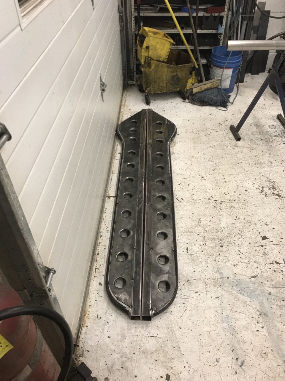

    this is where I’m at so far. Just need to do the other side.

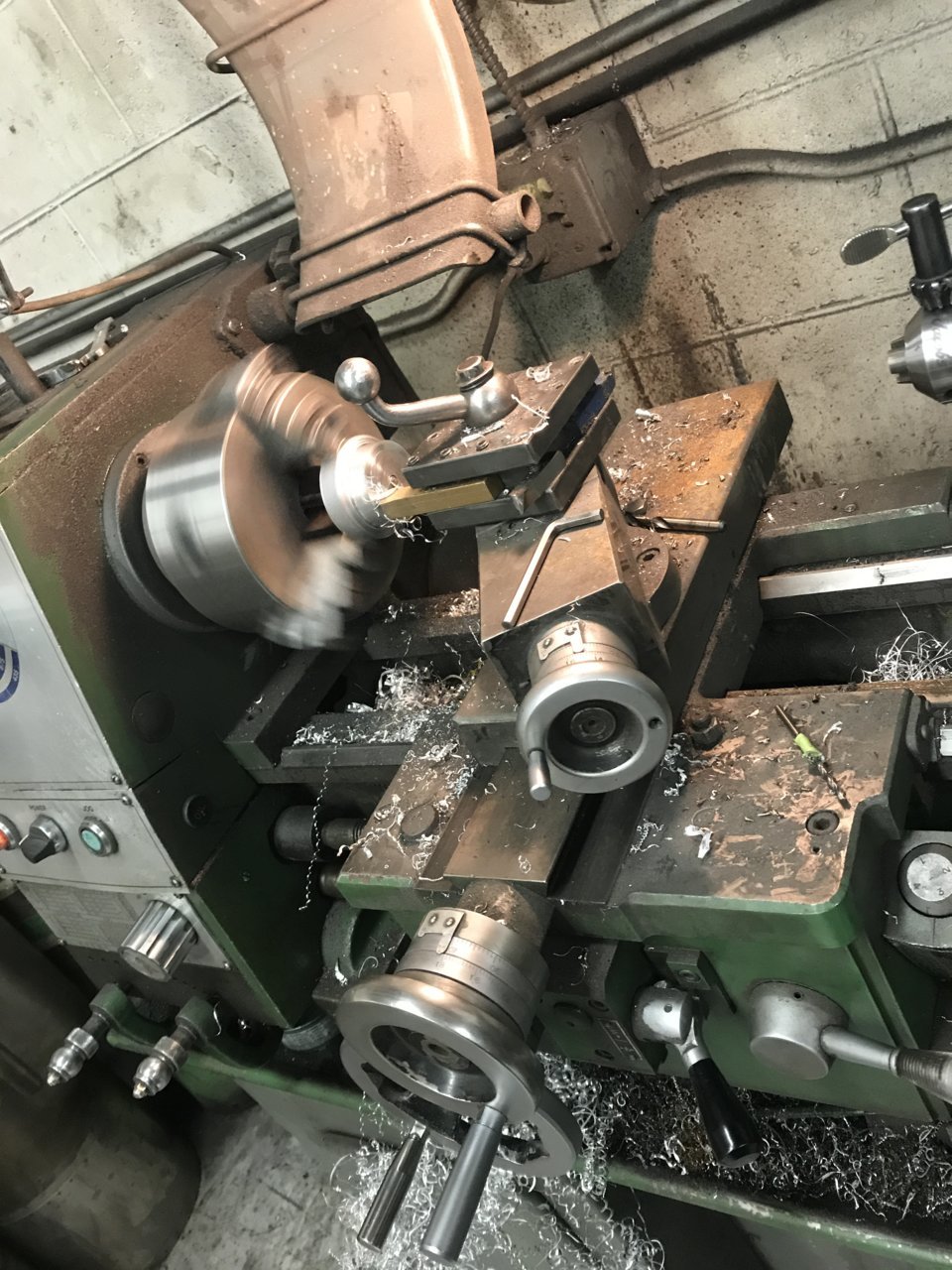

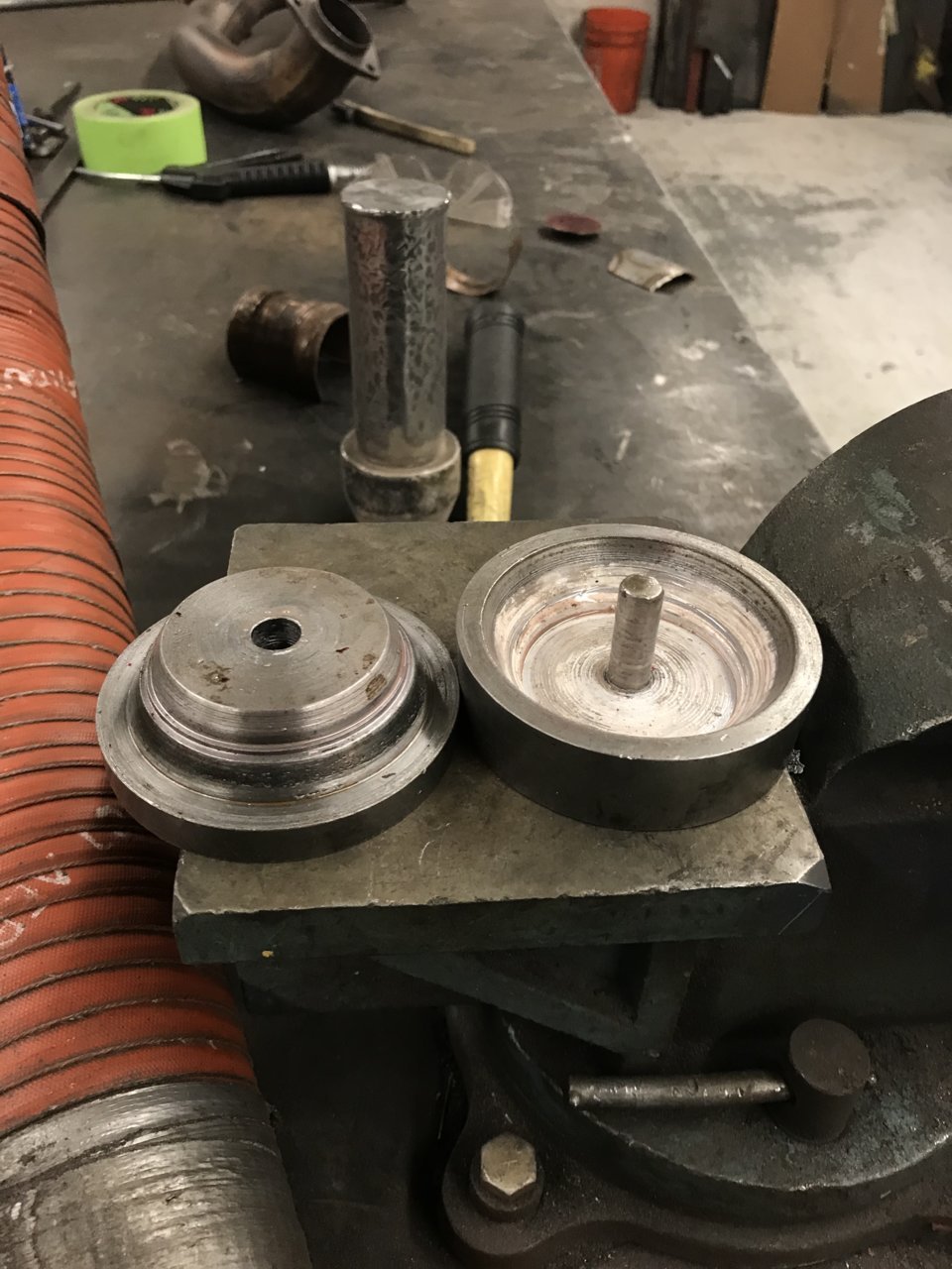

    I made my own dimple die set. Because someone bumped there head and wants an arm and leg for them.

    Those look awesome! I dig the design a lot.

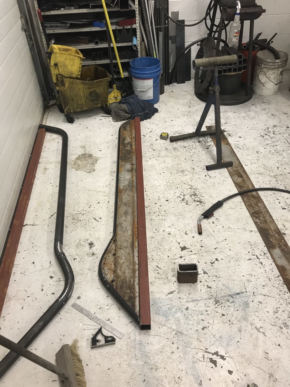

    Thanks man! It was pretty easy to modify the plates to fit. I made my kick outs a tad big but I’m happy with it. I’m welding everything as we speak and doing some modifications. How did you guys truss yours?

    Not quite. I’m going to ad some triangles to the square tube on the frame plates. So that when using a high jack the sliders don’t flex at all. I built them pretty tight tolerance

    Oh, yeah, those. I did something like 2" triangles. There's not a ton of clearance above the arms for trusses but you should definitely add some.

    I did 2”x4” triangles on the tops of the square tube

    Dimpling makes them lighter and stronger. Cutting lightening holes make the plate oil can like... Good job!
