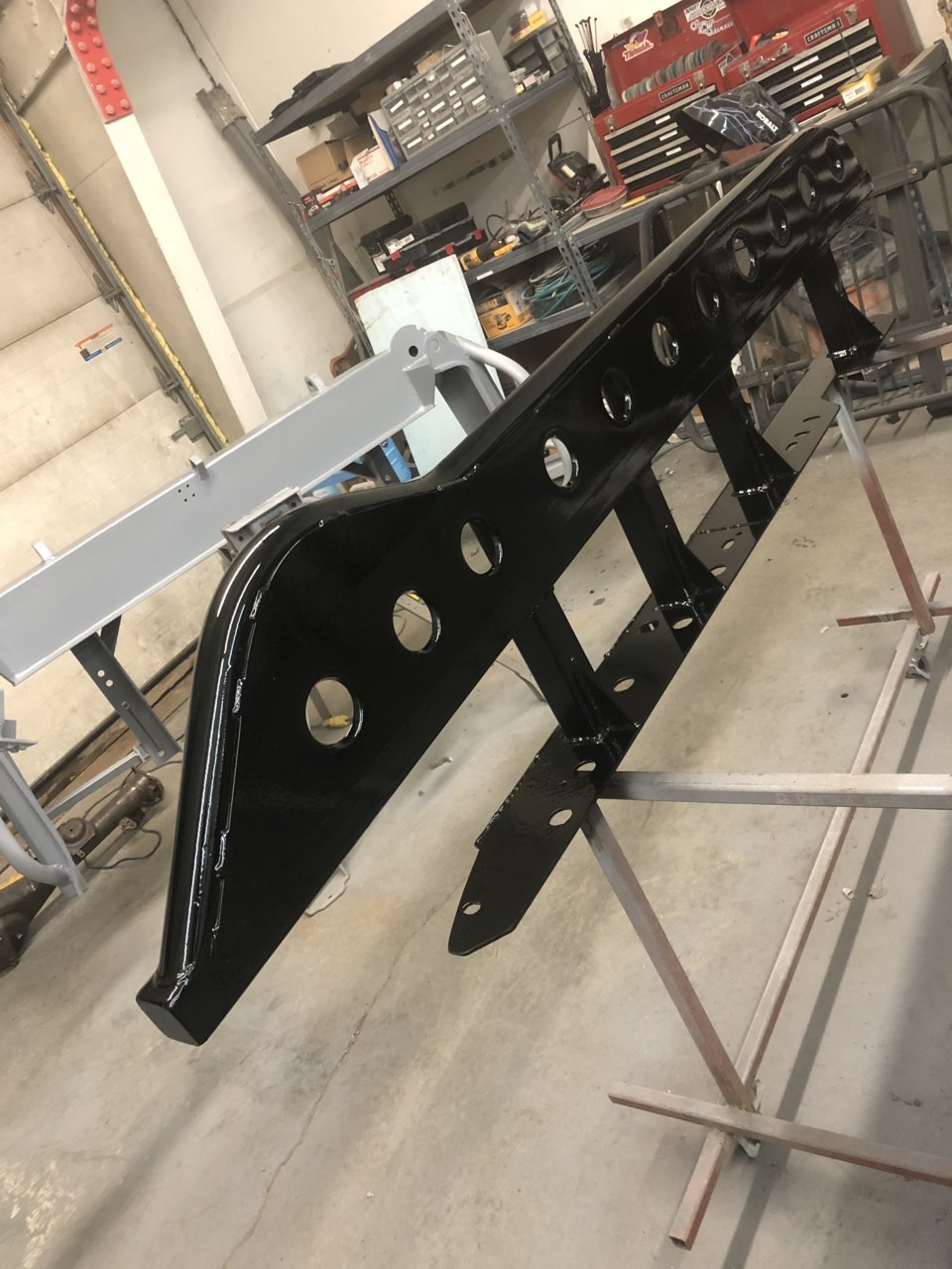

    hope you can see this picture?
    I could be wrong I might have more gap then I remember it’s been a few months since I built them. Worse comes to worse just fold the pinch seam.

    Sounds like a solid plan. Let me know how it works out. The sliders look good and your homemade dimple die was cool.
