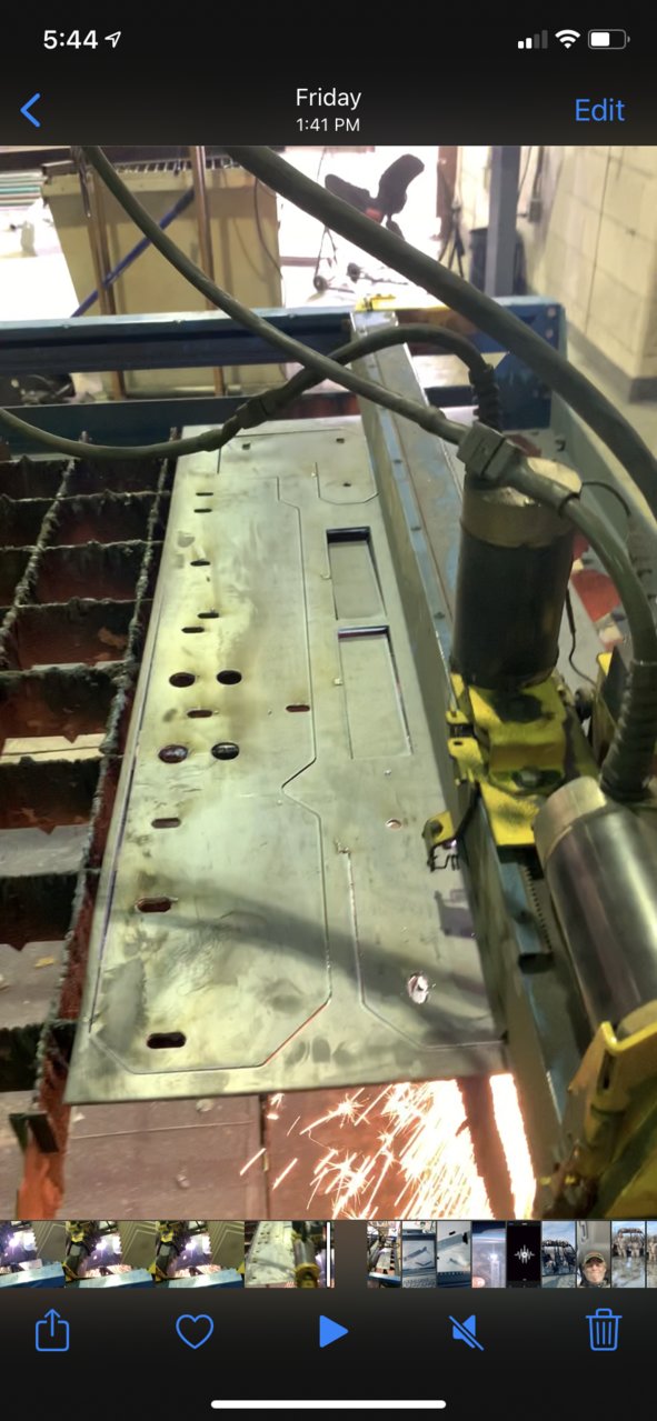

    I have a CNC plasma table at my work shop I can use for free. I was debating on outsourcing this to a water jet or laser. For those that have had them plasma cut have you had any issues? While my plasma is great for signs I don’t know if it has the tolerances for something this precise.
    Second question: I did some measuring and it seems the file does not fit my 19’ access cab. I’m going to print out a life size paper version glued to cardboard with the holes cut out to actually see if the design works, before I cut the metal.

    Already modified for the 3rd gen. DCSB should have the same frame as your ACLB. Plasma should be more than sufficient if you have enough power to cut 3/16 plate cleanly. these are not super tight tolerance.

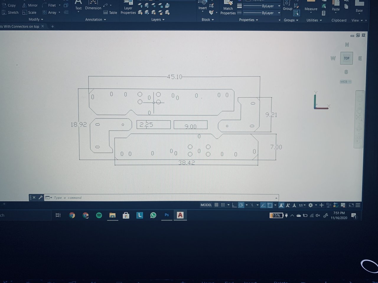

  13. Nov 16, 2020 at 3:45 PM

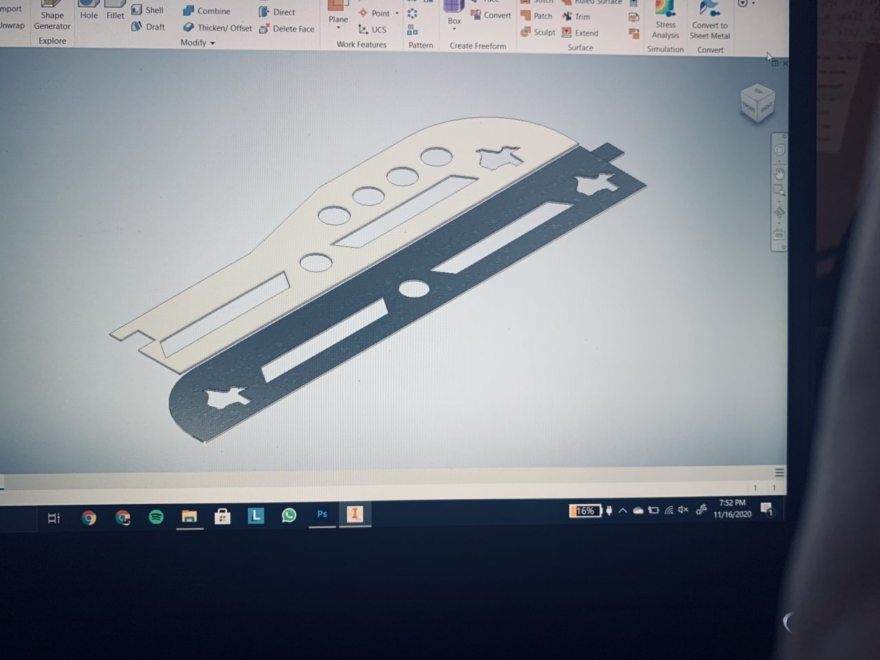

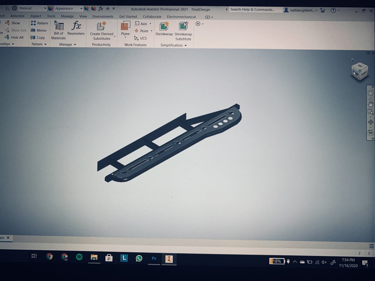

  14. Nov 16, 2020 at 5:45 PM

    I'd love to hear about the mods. I can see a few things in the photo but it doesn't explain why.

    The answers pretty short, my high schools plasma cnc can only cut to 48” so I had to shorten the ~53”. I took out a ~6” section in between the 90 and 115 degree bends and separated them and adding a crossmember to weld the two together. I’ll include images of my plans to aid my terrible explanation.

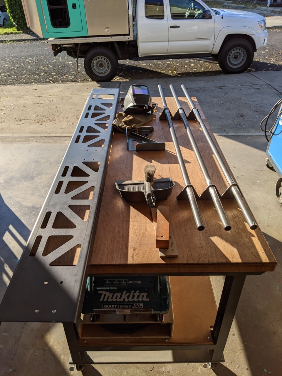

    Here's my awning mount.
    The piece on the left is my awning mount. 1/8" steel. Laser cut, two 90 degree bends the full length. 85" long. $80 including material. I've never had frame plates cut and bent at this shop. I switched to my new shop just after my first sliders were done. The thing I worry about with frame plates at my new shop is that they don't like any holes within 7/8" of the bend. It can scratch their tooling. I'll find out next year if they'll do it. If not, I'll have to cut the one hole on the bottom myself by hand.
    I would offer to be a vendor and get a bunch of these cut but shipping would SUUUUCK as they are big and heavy. I just assumed they'd be cheaper for most people to source locally. I guess I'm spoiled here in the Portland area.
    And before anyone says anything: Yes this should be aluminum and I may re do it next year in aluminum for weight savings. I have already cut a couple pounds of material off of this that wasn't really needed. The stuff you go through to prototype or one-off something.
