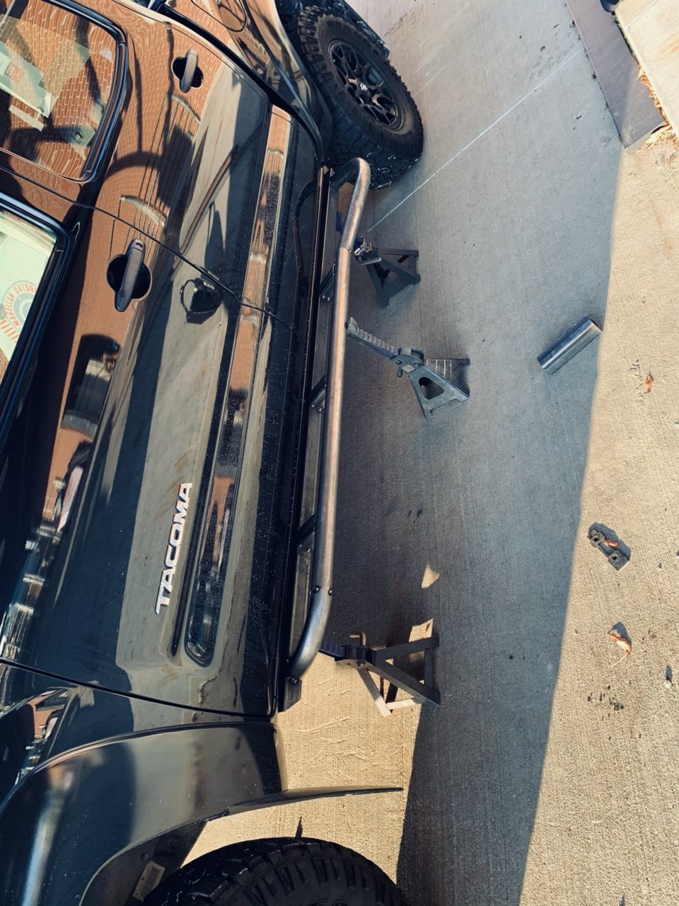

  9. Dec 16, 2020 at 7:47 PM
    #549
    NathanG223
    NathanG223 Well-Known Member
    Aug 8, 2020
    #337027
    173
    Nathan
    TX
    2007 Black Tacoma SR5 PreRunner
    Bruh Horn - Redneck Bed Drawers - Custom Rock Sliders - Head Unit Swap - DD Ditch Lights - Blacked Out
    865DFAA6-D220-4D8B-B59D-BCD626E50788.jpgWe’re getting there

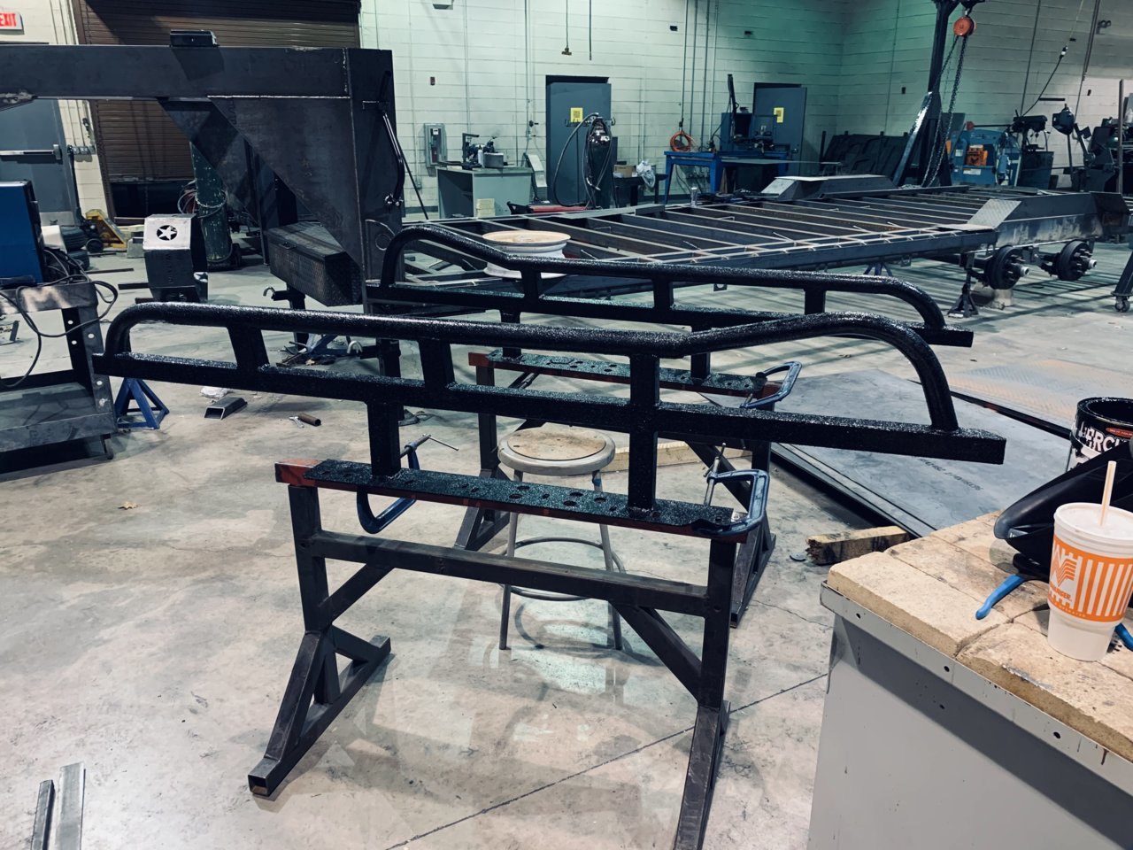

  10. Dec 23, 2020 at 5:55 PM
    #550
    NathanG223
    Aug 8, 2020
    #337027
    173
    Nathan
    TX
    97D0043B-3089-476C-81D0-267316B69F13.jpg Thank you so much op!
