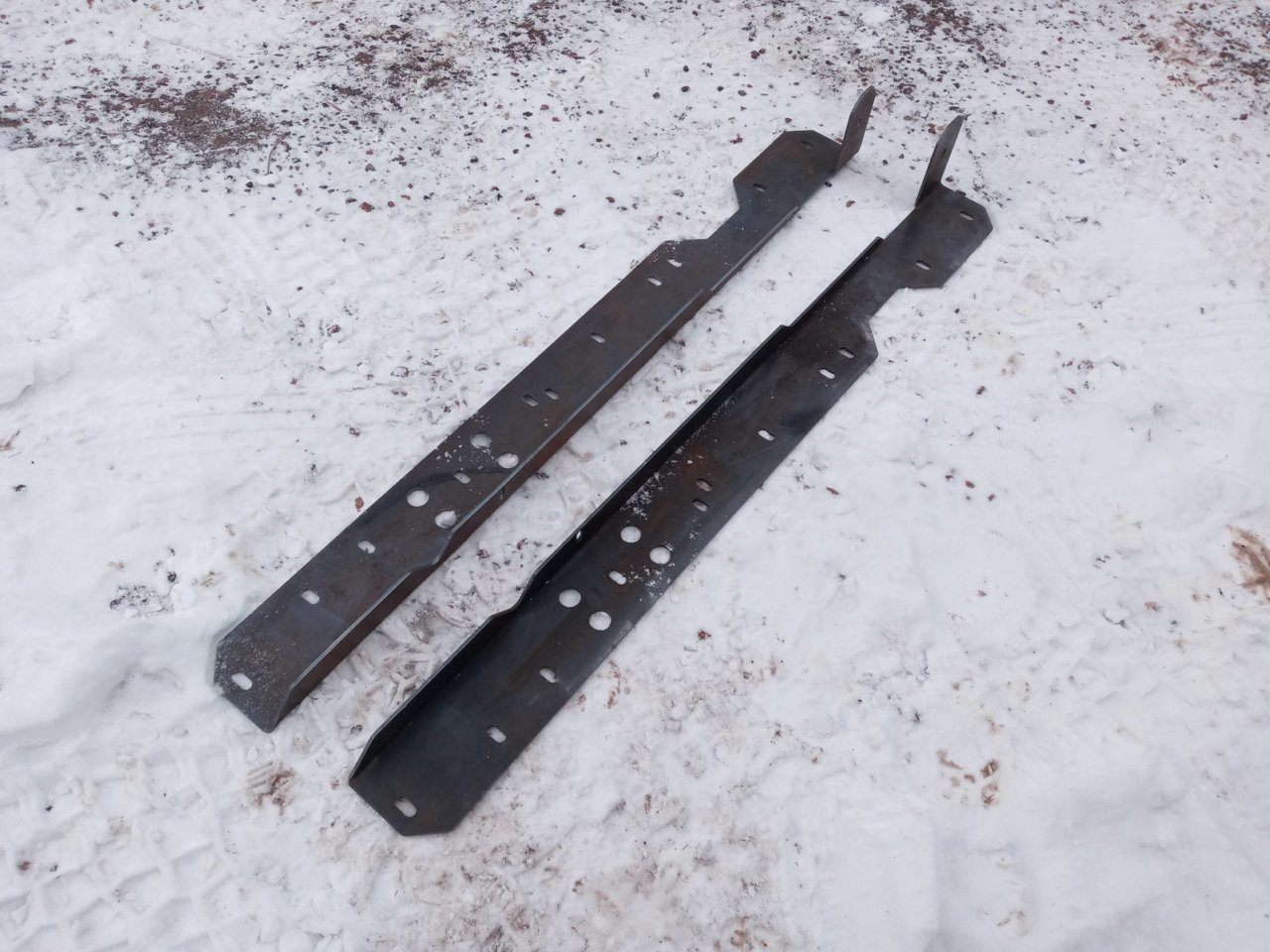

    Plates are cut and bent... now the fun begins!

    Okay-got the plates cut and bent; however, I don't know if I have ever seen a set of these things for real. That out in the open, it seems that there are as many designs as people running sliders... so what is "most" important to incorporate into my set? O degree, 15, or 25? three or four post. Kickout or straight? Does anyone have measurements or is that the top-secret part of this? How do I measure for stickout past the body pinch weld? From the door handle, the rocker plus some or some other point? Is there more of this data somewhere that I have missed? Thanks, as always in advance.
    William H. Bonney likes this.
  8. Dec 24, 2021 at 5:13 PM
    #588
    GHOST SHIP
    GHOST SHIP hates you.
    Mar 9, 2015
    #150537
    22,399
    GHOST
    That forward tab isn’t supposed to be bent to 90 degrees. You’re going to have to bend that back some.
  9. Dec 24, 2021 at 5:38 PM
    #589
    pearing
    pearing Well-Known Member
    Aug 4, 2018
    #261610
    5,251
    Wisconsin
    2015 SR5 quadcab
    Yea, I saw that as well. Vice will make short work of it.

    When I got my mobtown sliders 2nd hand I had to bend those tabs a bit and it wasn't exactly easy. Might be easier to get those in a vice since you don't have tubing yet, but I had to use giant slide clamps for leverage and a torch to soften up the bend.

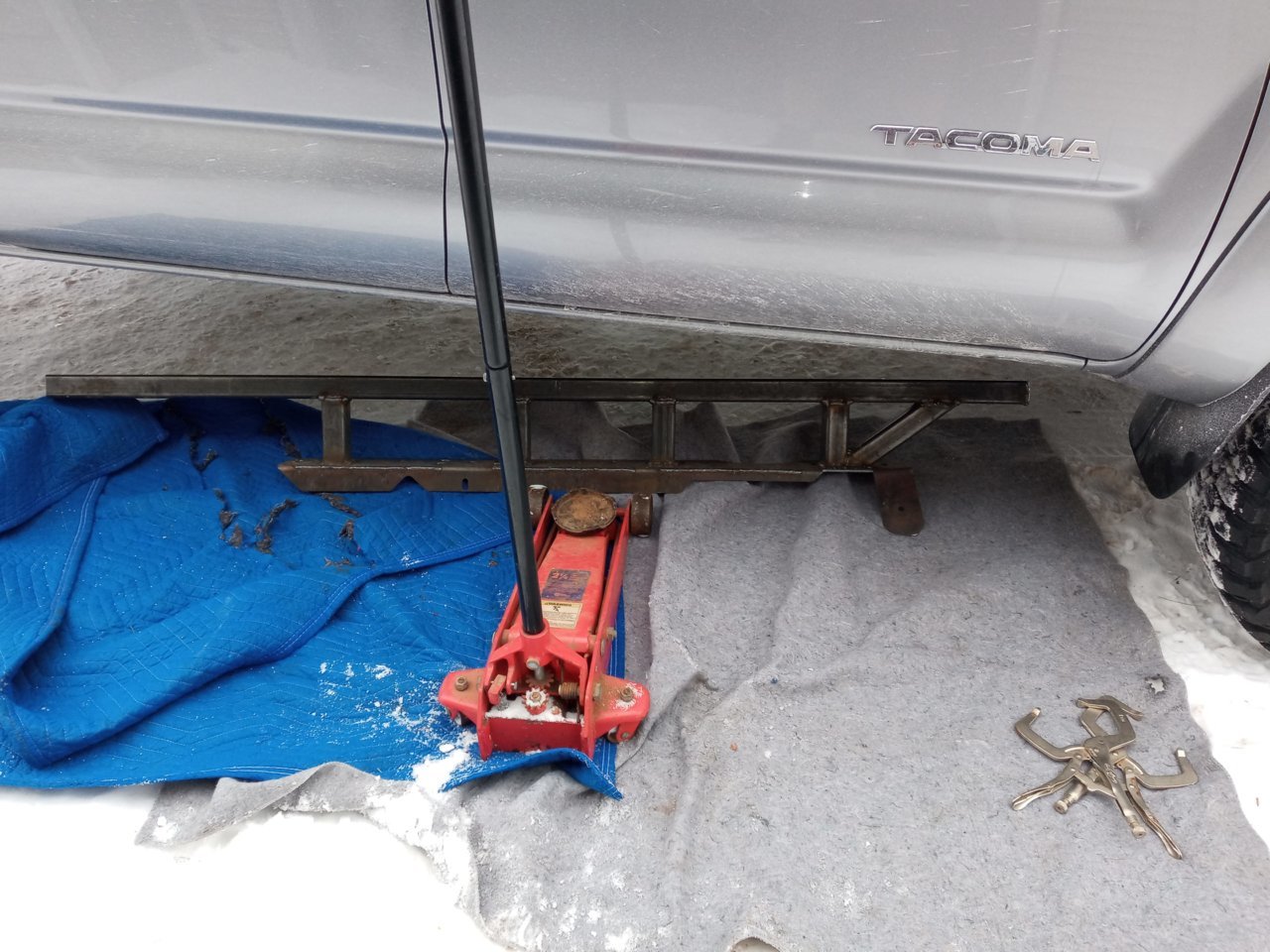

    Depends what you want to use them for.
    I have DOM steel (wasn't a choice), 4 post, 0 degree, straight, no top.
    I use them mainly as a running board but have the added protection when wheeling. I don't "rock crawl" lol
    Here is a good video:
    https://youtu.be/AgOCduqHwAI
    I also found this a long time ago for reference if I wanted to build them myself. That's how I also followed this thread. I ended up just buying some because I got a great deal.
    Not sure how well this design would work... lol
    IMG_3706a_zpspwl5egxq.jpgoriginal_zpsfje_99f2c1060b51e4ba3f9c4df650c95c6e072de424.jpg

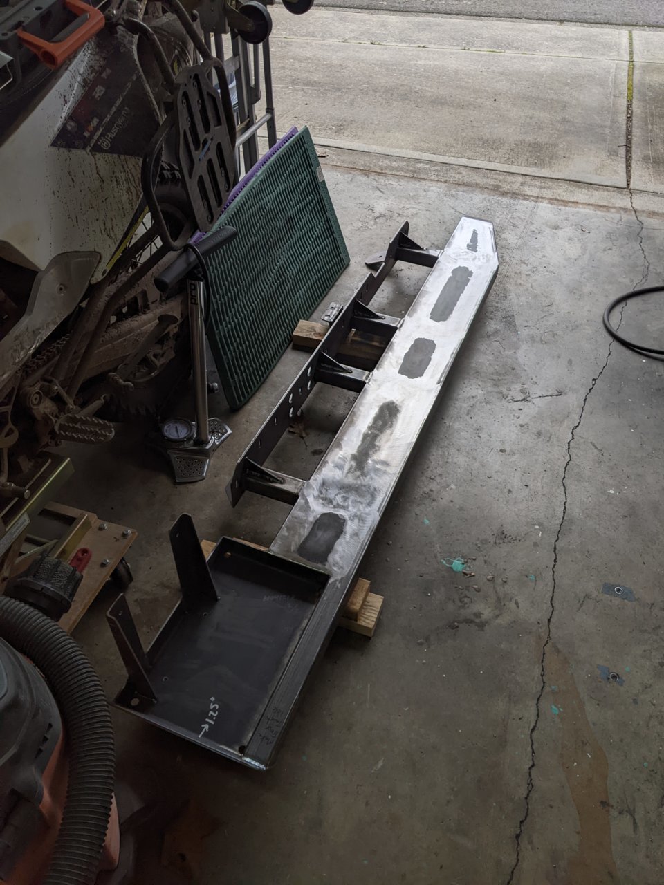

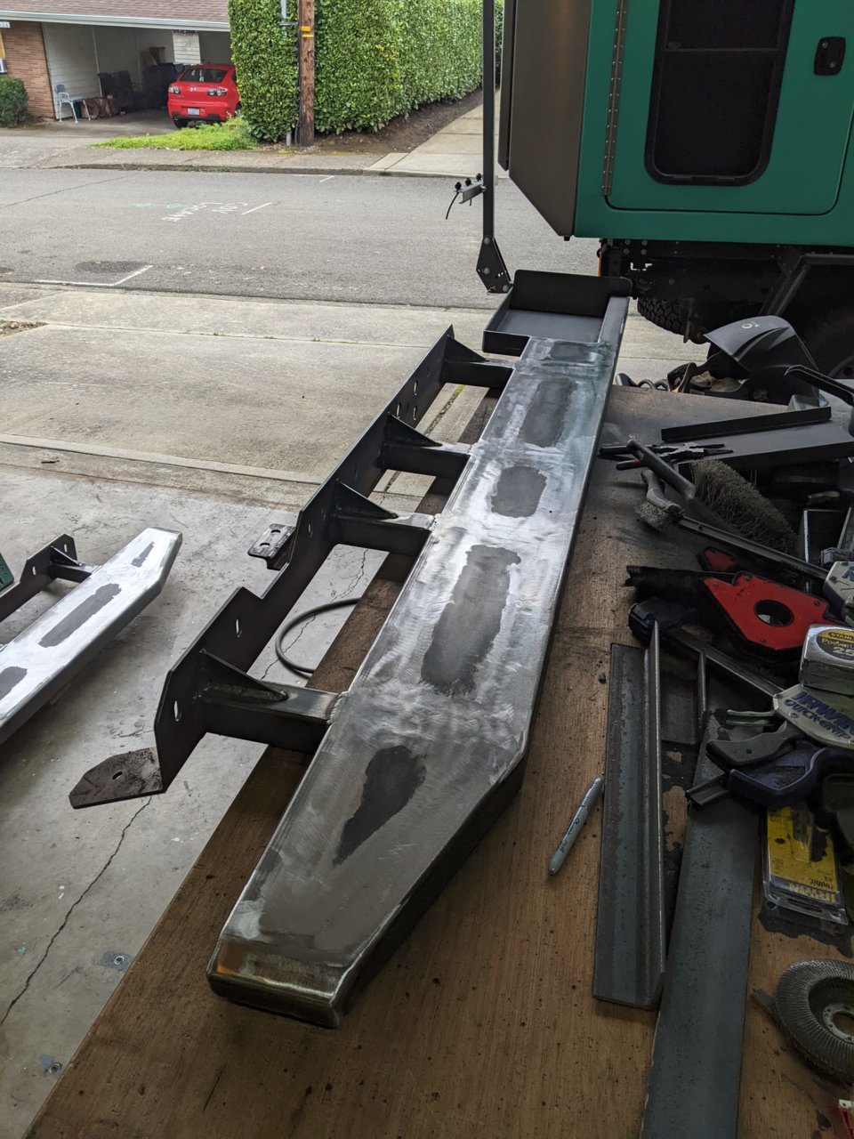

  14. Jan 31, 2022 at 3:14 PM
    #594
    pearing
    Aug 4, 2018
    #261610
    5,251
    Wisconsin
    2015 SR5 quadcab
    made some progress today:
    1 Bored Clerk[OP] and FastEddy59 like this.

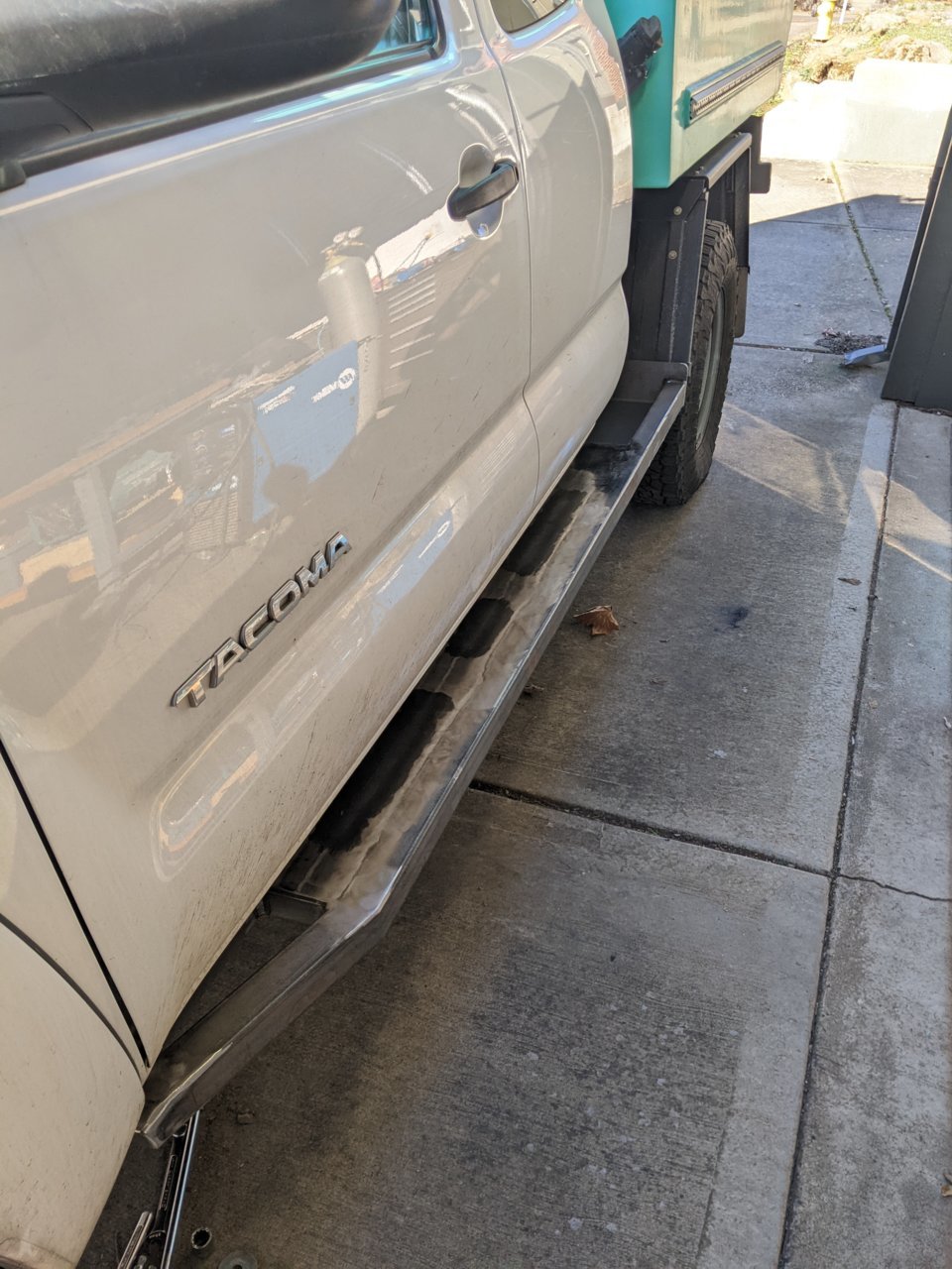

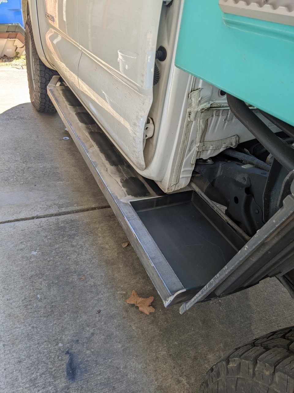

  15. Feb 19, 2022 at 3:07 PM
    #595
    1 Bored Clerk
    1 Bored Clerk [OP] Well-Known Member
    Sep 18, 2013
    #112786
    1,999
    Vancouver, WA
    '13 4x4 AC TRD OR
    Finally got these things done. I didn't post much because I was procrastinating a ton...for months...per usual for me. Not my best work but probably not my worst either. I don't really care at this point. I just want them powder coated and back on the truck!
    Just a few shots to get an idea of overall fitment.
    Here are the finish welded sliders with storage trays. Note the wavy surface. It's not great but it's going to have to do. I know from experience that that stuff sort of fades away as noise when you see the whole vehicle. It'll drive me nuts but whatever.
    Off to powder coat Monday.

  16. Feb 19, 2022 at 3:10 PM
    #596
    FastEddy59
    FastEddy59 TTC #0061
    Jan 20, 2017
    #208155
    27,141
    Eddie
    '13 Barc. Red Tacoma SR5 4X4
    Did you remember a drain hole for the pans. :notsure:
  17. Feb 19, 2022 at 3:23 PM
    #597
    1 Bored Clerk
    Sep 18, 2013
    #112786
    1,999
    Vancouver, WA
    '13 4x4 AC TRD OR
    Yes, 1/2" holes in all four corners.
    FastEddy59[QUOTED] likes this.

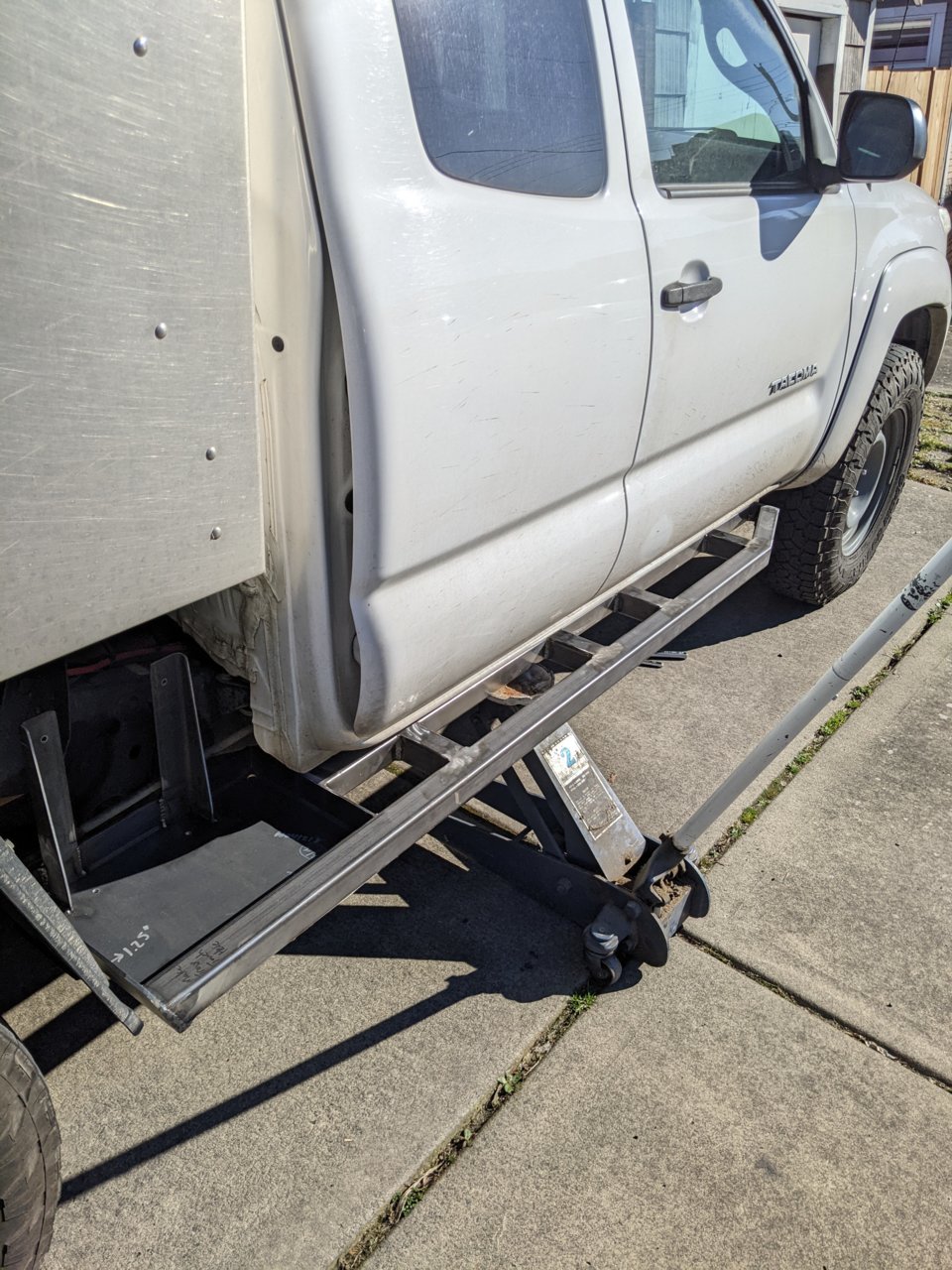

  20. Feb 20, 2022 at 2:38 PM
    #600
    pearing
    Aug 4, 2018
    #261610
    5,251
    Wisconsin
    2015 SR5 quadcab

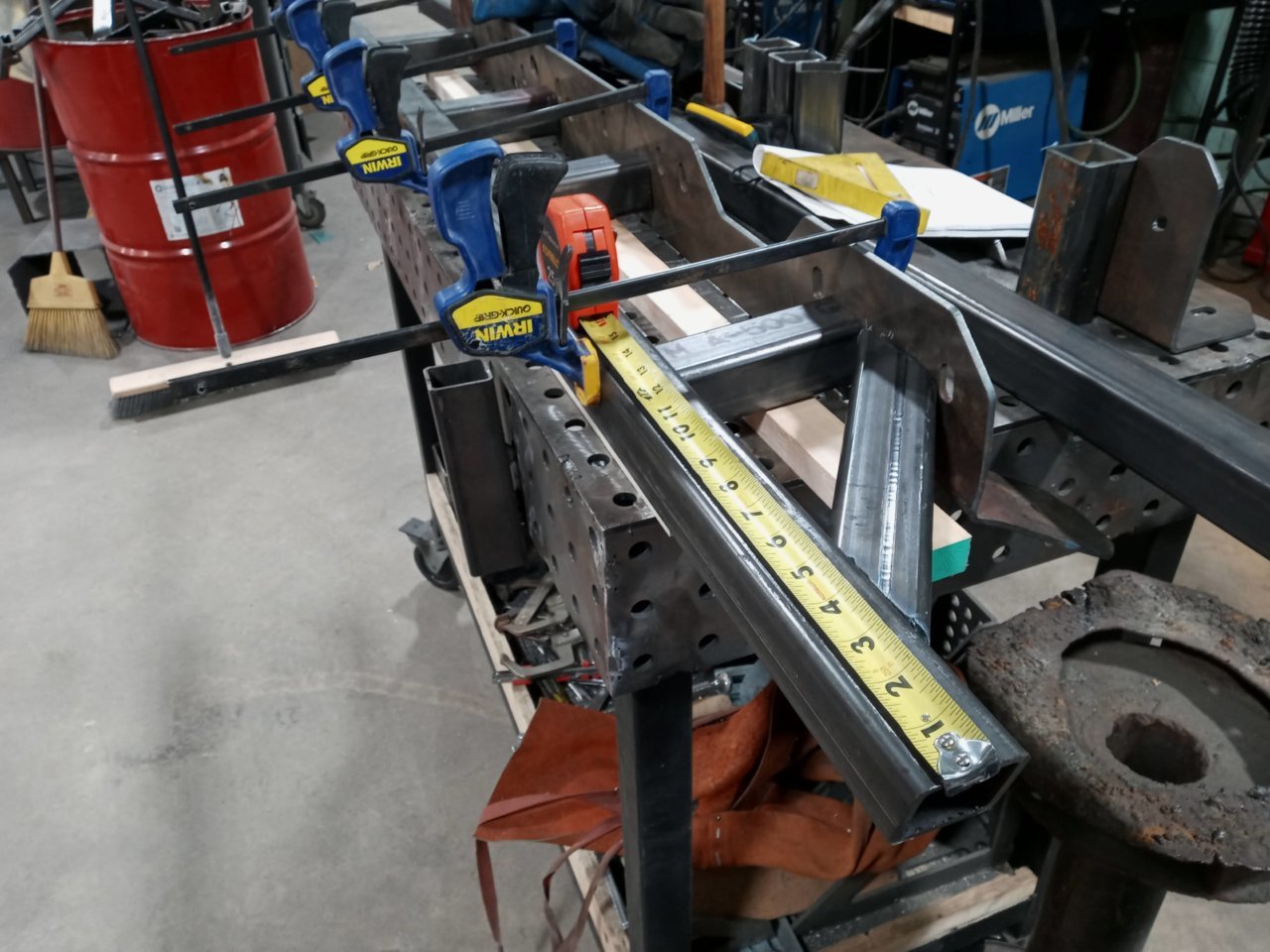

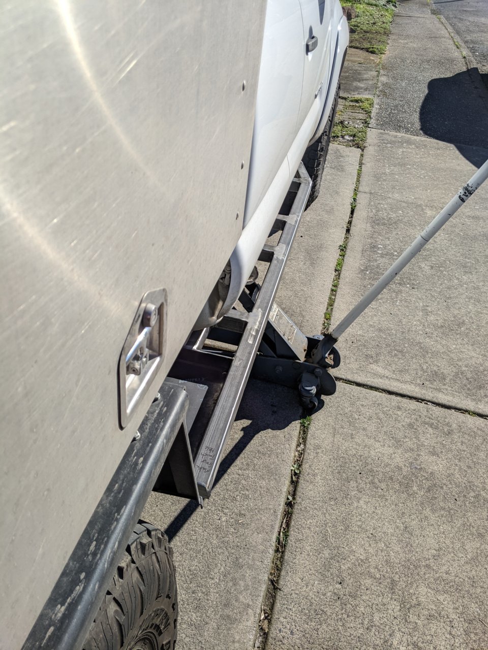

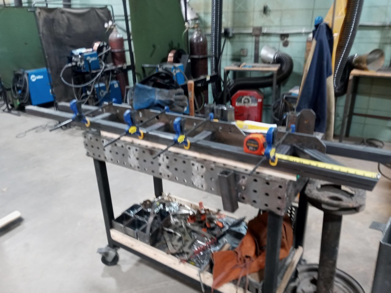

    I am probably going to get flamed some for asking, but what size bolts are you guys mounting these up with. I swear I could find nothing definitive looking through the whole string of posts. Also, did drawings/dimensions ever come for the bolt plates that people were making for up in the boxed part of the frame? Getting ready to mount mine so I can bend the tubing...
    1 Bored Clerk[OP] likes this.
