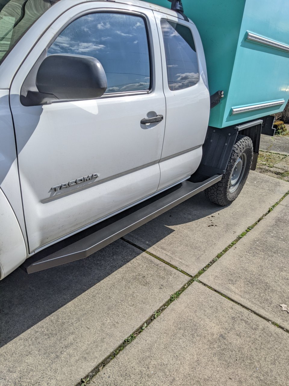

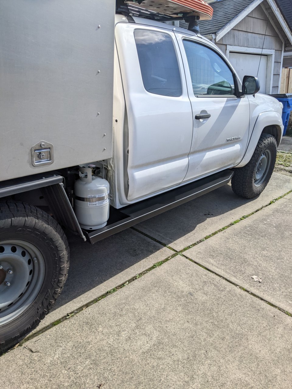

    Picked up the new sliders from powdercoat last week and got them installed today. Cleaned the frame, coated the frame with fluid film to prevent rust (works awesome) and bolted everything up. Got my powertank propane mount installed and my 11lb tank. Still need to get some sort of storage box installed/built for the drivers side. But one less thing on the list for now!

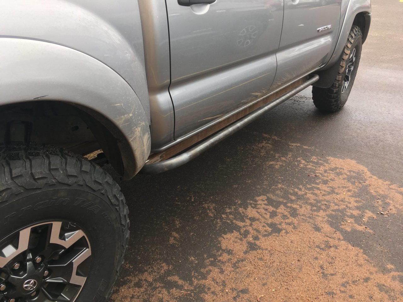

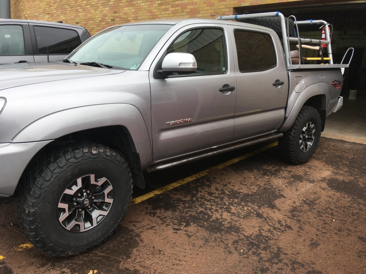

    Made some progress finally... 1 3/4 DOM tubing 3/16 thick-had to get that bent because I had no way to make it happen. Mitered to 15 degrees and hard tacked to structure. Remove add some cross tubes and weld up solid. Still have to make internal bracket bolt thingies for the front plate holes.
