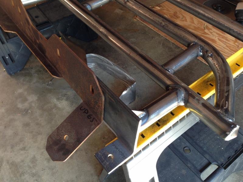

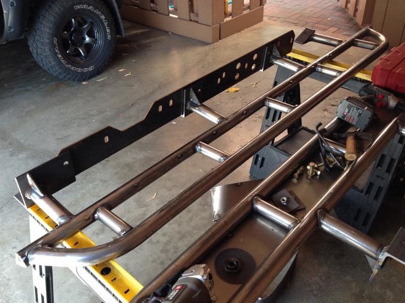

    That's what I had planned for my beefed sliders, but the legs are pretty far apart, and the plate is a bit too short. I guess it depends on the slider. I might cut the first L bracket to fit, and butt weld the frame plate to the bracket, and just bolt the last leg on. All the other L brackets will be cut off.
