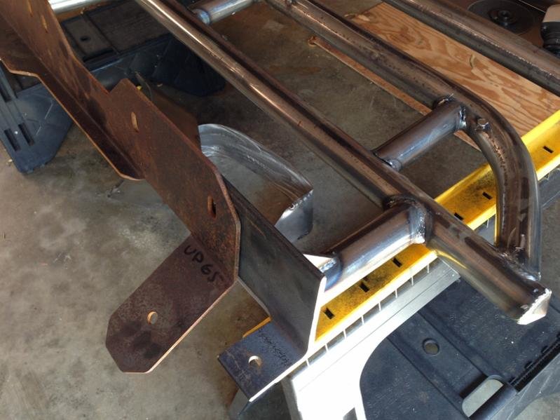

    Yeah, I think I'm gonna butt weld the brackets together and remove his bolting point and use yours on the cross member. The one all the way in the back by the rear spring needs to be drilled. I can live with one hole. Either that or I relocate the legs...
    Not sure yet. Relocating the first leg wouldn't be too bad. And with the rear mount utilized and drilled into the frame, it should be super solid. Or just bring the legs in closer together and weld them all to the frame plate like the Slee sliders

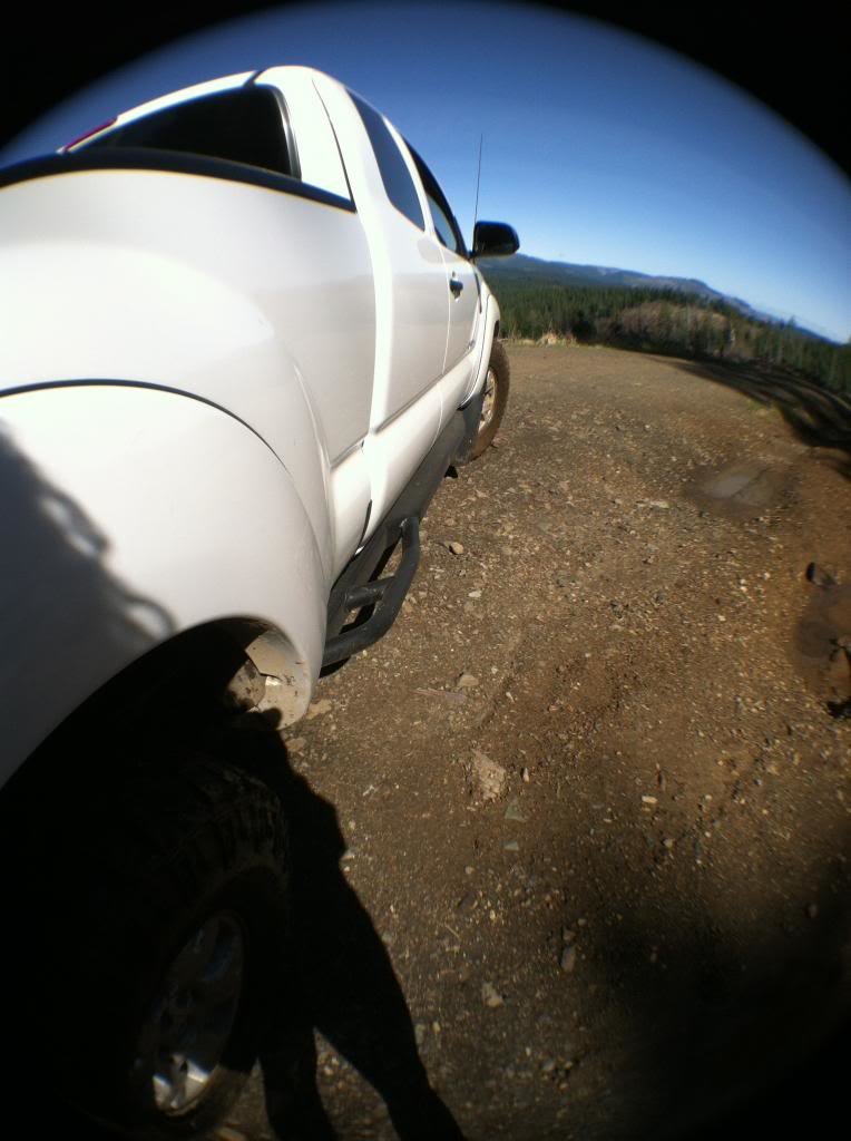

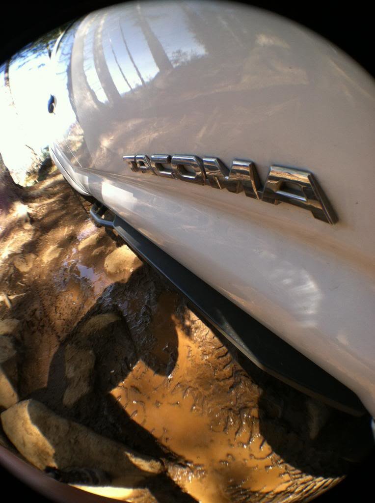

    Well, I finally took my truck out for a little light wheeling. My fiance and I went out to Tillamook State Forest for a little Friday morning fun. :D
    Yup, just got done peeing. Don't worry about it.
    My awesome and goofy fiance having a little fun.
    Stock truck with a couple hundred pounds of armor means you REALLY NEED armor. :D We rubbed or banged every piece of armor off of something. The low-hanging exhaust crossover cover took the brunt of the abuse but nothing was exempt...including the rear bumper, trailer hitch, trailer towing harness, and, of course, the much maligned factory mud flaps. No damage to anything but a lift would have made the ride a little smoother. Oh well, it was a good time and I was really happy to find that the Tacoma didn't feel too long on the trails compared to my old FJC. Anyway, it was awesome to put all my hard work, time, and money to use on the trail. Felt good. :cool: I had been mostly avoiding off-roading because of the lack of armor...but it's on now!! :burnrubber:
    FYI. The trails in TSF were University Firepower and Cedar Tree. Conditions were great! Lots of puddles, a little mud, rocks and roots but nothing that felt sketchy or like you were tearing anything up needlessly. All pics were taken by my Fiance with her trusty iPhone 4 with OlloClip.

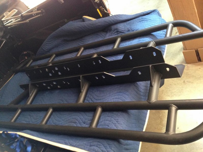

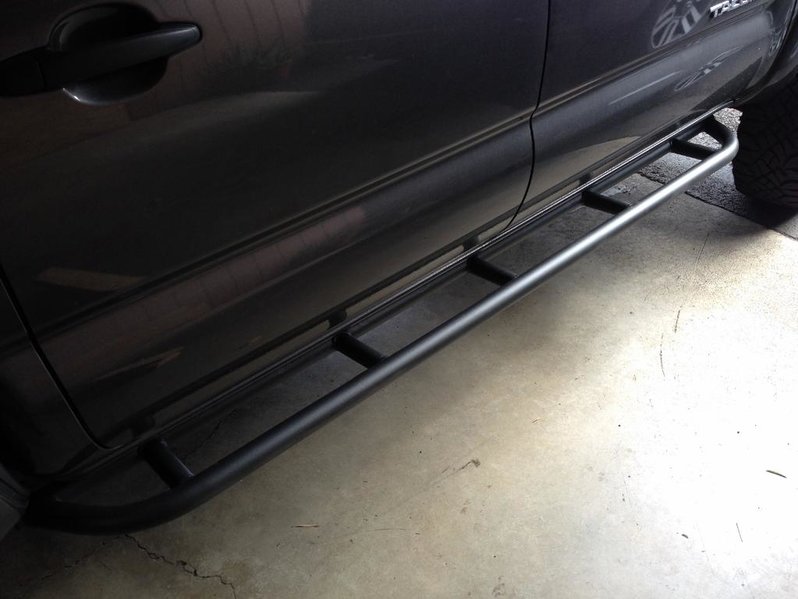

    I finally got mine all welded up and back from sandblast/powdercoat :cool:
    I was hoping the textured powdercoat would hide my ugly welds better...
    All the holes line up great. Not as fancy as 1boredclerks, but he did a great job on his sliders and on these frameplates.
    Again, thank you so much Patrick! :)

    Awesome!! Those look great! It's been such a long process for you...it's got to feel good to be D O N E with that.
    I feel your pain on the textured powdercoat. In my case I've learned, any paint, no matter how textured, just makes my crappy welds look crappier! Haha...

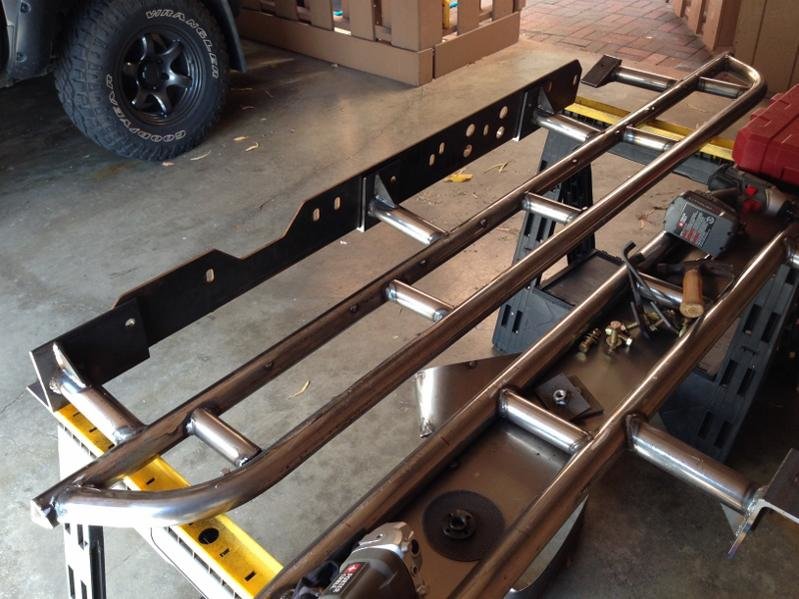

    Actually, you don't. I made 2"x3" plates with a nut welded to it. It will just slide inside of the hole in the angled portion sideways. Then you twist is 90 degrees to bridge the hole and you can hold it in place with you finger through the oval hole in the back side of the trans crossmember support that's welded to the frame.
    I'm sure that wasn't clear at all, but you can bolt these up without dropping the crossmember. It all depends on the design of the backing plate you choose to make, and how flexible your fingers are. Bullaculla's fancy aluminum job is certainly top notch though!

    Actually, that was CrMo steel :D
    And I thought about cutting it to fit into the rectangle hole, but was too lazy :)
