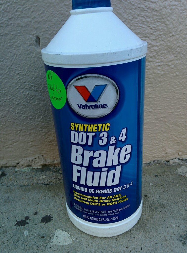

    It took me exactly 31 minutes to flush in this new 32oz bottle of high quality brake fluid, all by myself! Not bad for my second time ever!
