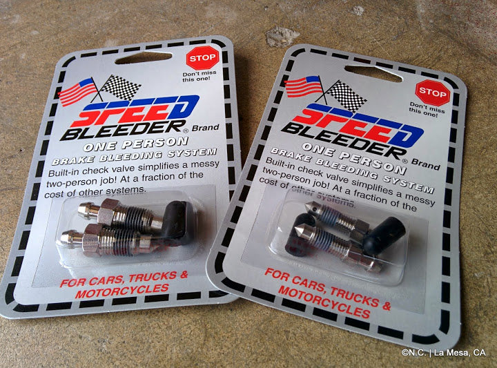

    When I ordered mine, they were one per pack...

    When I placed my order from Speedbleeder.com she asked me make an model and sent out the same part #s as what is listed here. Give them a call and let them know what make/model you have and they will make sure you get the correct ones.

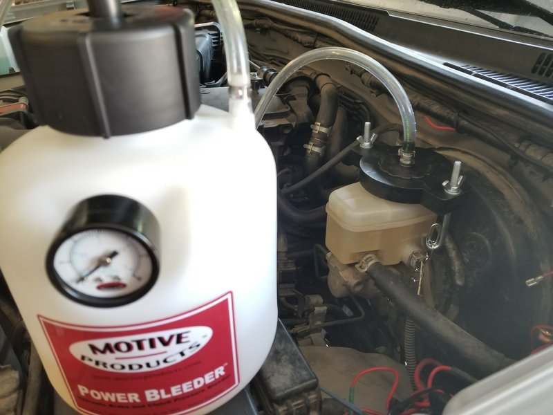

    Personally, I prefer the Power Bleeder.
