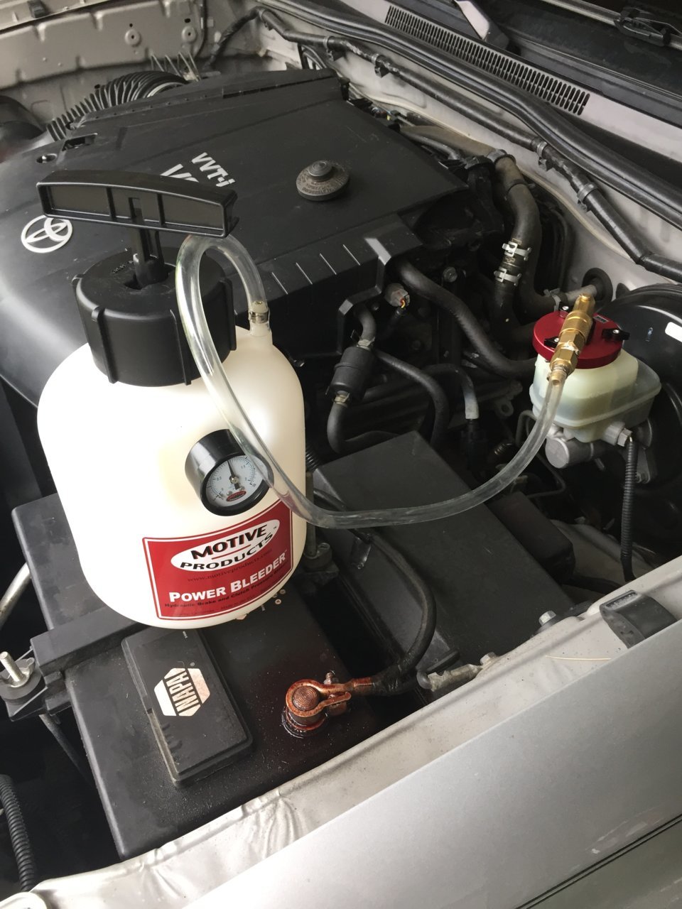

    I use a Motive products tank. Easy as pie to bleed the brakes by yo’ self.
