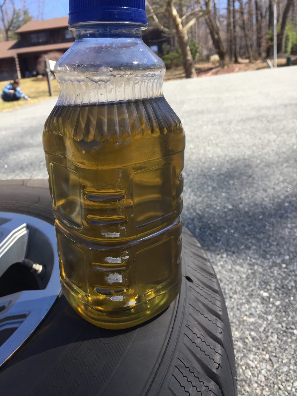

    My bleeders came last week, quick shipping from Speed Bleeders and I just got to the job today. What a easy job bleeding brakes is now. Only small non issue is although my truck is a ‘10 with original fluid, is was still clean so I had to guess as to how much to run through. My method was to fill the master to the top and run it down just below the min line and call it good. Did that for each corner and used all of a 32oz btl. While I was in there I took a file and descaled the vanes on my front rotors. I don’t put a lot of miles on so pads and rotors can wait until fall. Pics are of my pile of rust scale and how clean the old fluid was.

    8,654
    bill
    2014 SR5
    great job, do the brakes feel firmer since you Sped bled them?

    Toy4me Well-Known Member
    Aug 19, 2012
    #85061
    3,738
    Tom
    NNJ
    '10 DCLB TRD Sport MGM
    Nope. Just took it out for a test drive. Feel exactly the same as before, which was honestly fine. I did it because this thread motivated me to do maintenance that should be done, and as stated, the speed bleeders make this an easy one man job. But I do feel better knowing that there’s all new fresh fluid in there.
