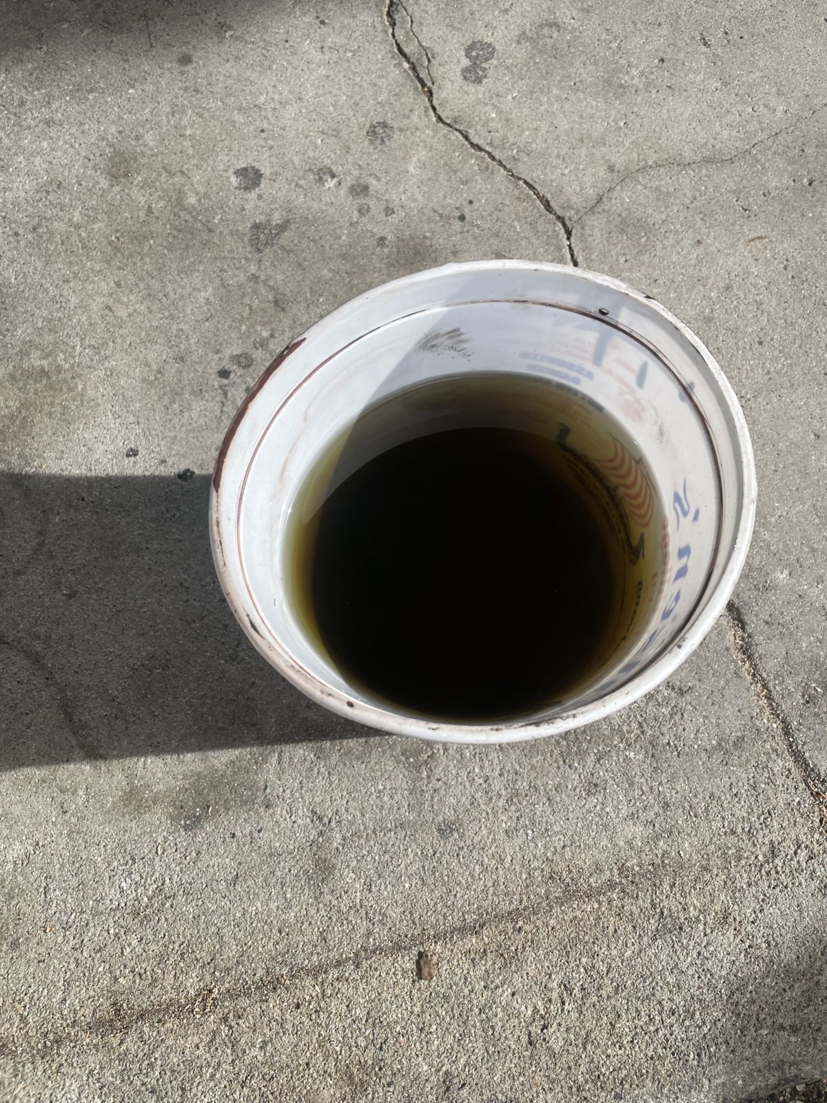

    Thread revival. Finally did mine this weekend. Brake fluid was in desperate need of replacement.

    That would be 120k. Original fluid from the factory.

    Beyond overdue Nick. I remember saving this thread amongst several others that you authored and I’ve had the speedbleeders in my parts bin for a couple years now. Took a hiatus from TW due to some changes at work and finally had some time for myself. I may even get to install the energy suspension radiator support bushings that we talked about many years ago.
