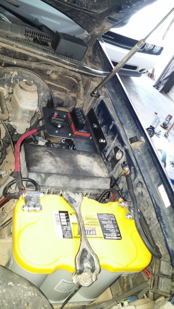

    Just finished up the panel in my FJ thanks to the most detailed instructions I've ever seen in my life! Starting to throw in the accessories as they come. Already got 2 sets of light pods and my CB running through it now

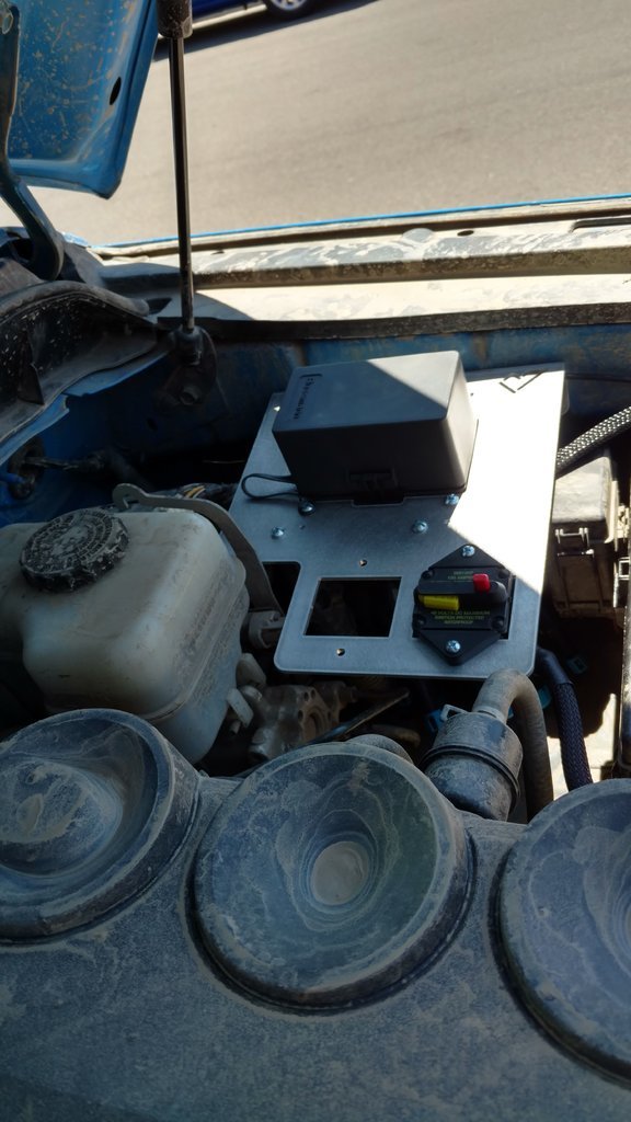

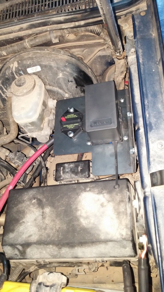

    Installed mine today. Word to the wise, buy a premade mounting plate. Almost lost my shit trying to hand fab a plate in 105 degrees after a graveyard shift. Also, the hydraulic lug crimper is amazing.

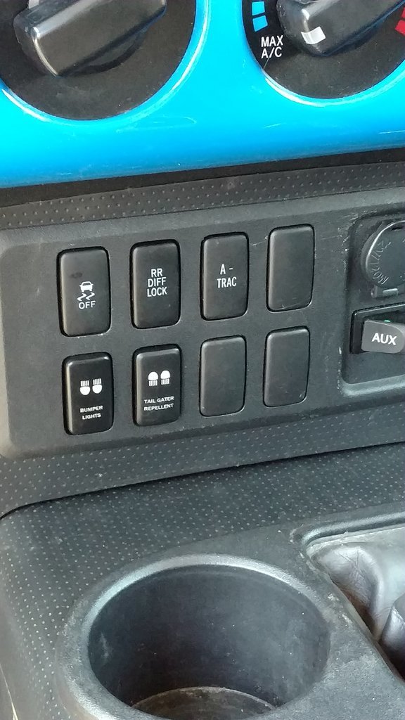

    Anyone put their switches in the sun glass holder in a second gen? Also, did you use the OTRATTW switch backings that allow you to disconnect the switches easily and move them? Need to know if the switch backings fit up in the sun glass holder.

    Read the first page

    ^This. The first page goes over exactly what you are looking to do and has the most detailed instructions that I have ever seen.

    The answer is no, switchbacks dont fit, but the op does describe in minute detail how to DIY exactly how to get around that.
