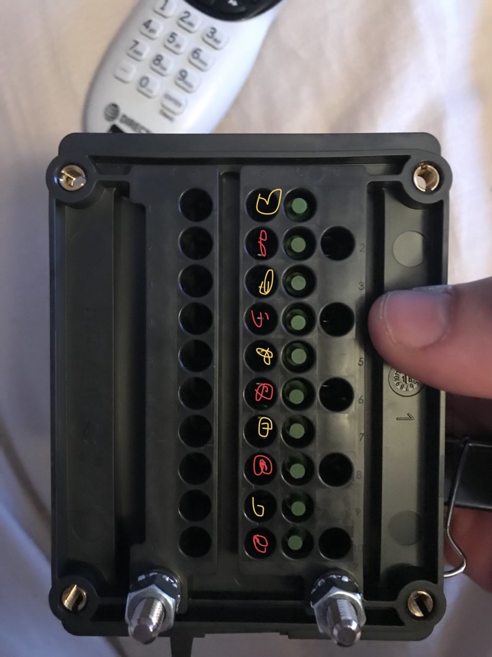

    It’s a little difficult to tell from the photos but the wires for the accesories go in the bottom cavities correct?(red)

    If you're copying tacozord that's the switch wire hole for the relay. The top hole(yellow)goes to accessory. Jumpers from fuses go to solo holes far right. Blank is where the relay plugs into the buss for grounding the switch side of the relay.

    So the red hole goes to the switch and the yellow one goes to the accessory?

    Yes.
    On a 4-pin relay the connections for the switch side and accessory side run diagonally so when you turn on your switch it energizes the red pin passing through the relay to the grounded bussbar via the hidden pin. Accesory power then can pass through the fuse, across a jumper to the far right bottom pin, then through the relay diagonally to the upper left yellow pin and out to the accessory. It's all covered in section 4(post #4) by the op. It does seem to take a few reads for it all to soak in so I hope this helps. There are other ways to wire it since relays are not polarity sensitive but the way the op does it works and seems to be tidy with the wires.
