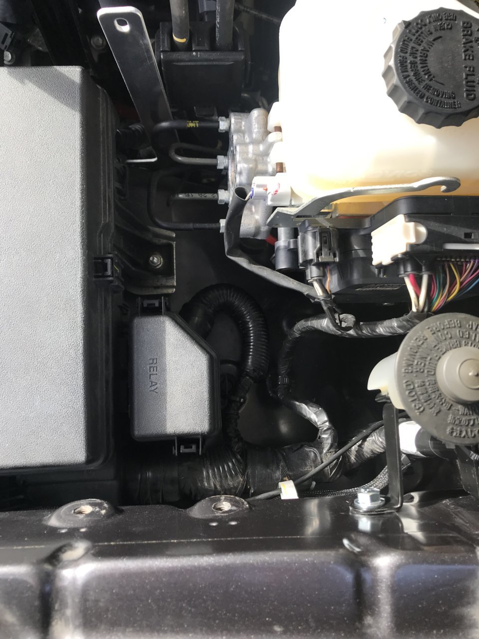

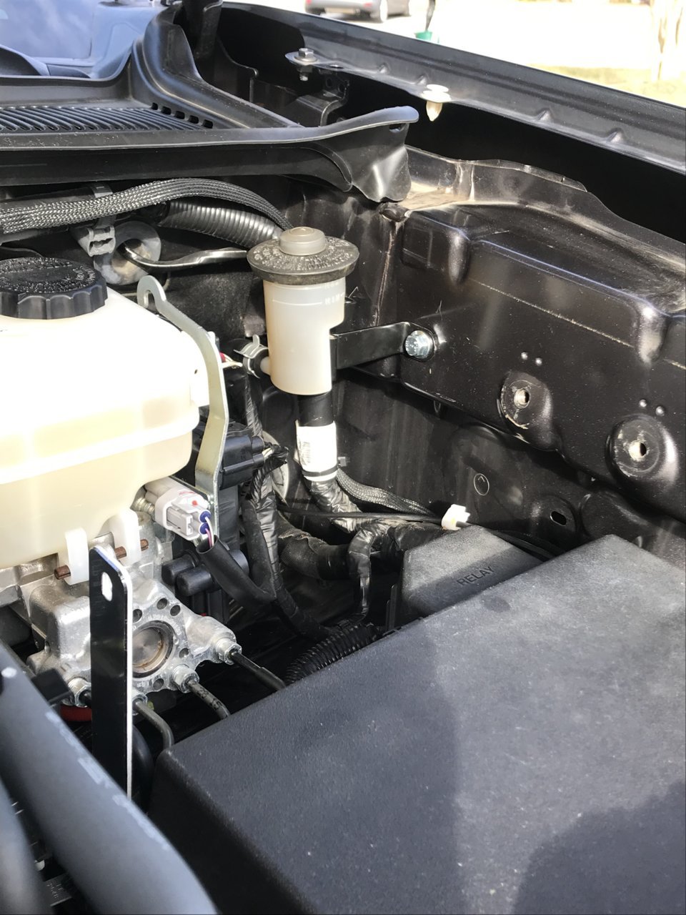

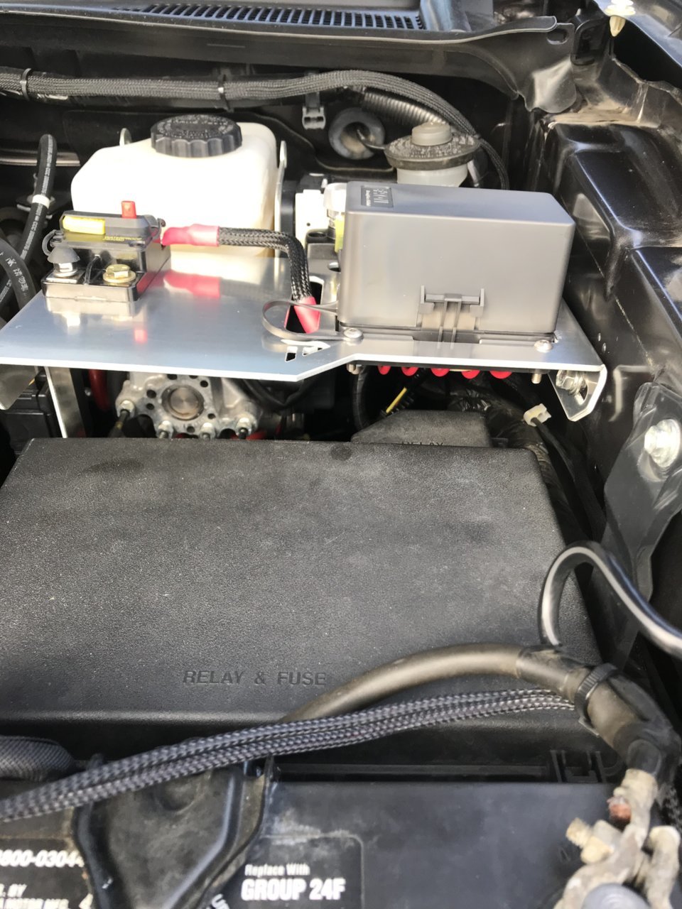

    For those that are having trouble finding a tray for the Manual, check out what I did:
    - bought a stock tray for the 3RD gen auto from Powertrays.
    - on the clutch reservoir, I cut the straight part of the hose that goes from the reservoir to the firewall down by 5” and moved the reservoir back towards the firewall.
    - there’s a large bundle of wires mounted to the fender wall, I removed that grey plastic wire holder and reamed out the hole it was in (it was a rectangular hole) and then inserted an 8mm rivnut in there, then installed a second one and was able to use the stock reservoir mount, keeping a stock look. However, you’ll notice the stock holes are angled, probably to compensate for the built in factory Taco lean , repositioned reservoir is a bit off, but you’ll never notice.
    - powertrays mounted up with plenty of room to get the stock fuse box lid out.
    Viola!!!
