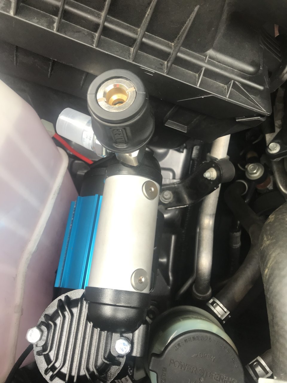

    CAG Gonzo Ascendant Spaghetti
    Oct 25, 2018
    #270558
    1,688
    2018 OR DCLB BarRed
    Thanks for that. Looking at the datasheet of the 100A (Marine rated, purchasing via Connector Concepts) here (https://lib.store.yahoo.net/lib/yhst-142618731068637/187Circuitbreakers.pdf), I see at 100% load (100A), the trip time is in excess of 100 seconds. As the % of rated load increases, the trip time window decreases (makes sense). But even at 100% load, it can still be over a minute before the breaker trips, exposing the RFMR and whatnot to the excessive current. Am I understanding that correctly?
  3. Mar 27, 2019 at 4:03 PM
    #743
    Sandman614
    Oct 26, 2010
    #45273
    35,876
    Tim
    Garner, NC/Boone, NC
    '06 SR5 Off Road
    Correct so in that case the correctly rated breaker would be the best option.

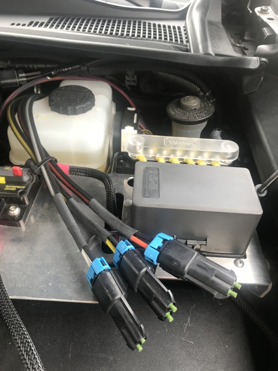

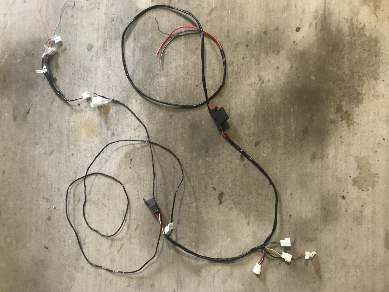

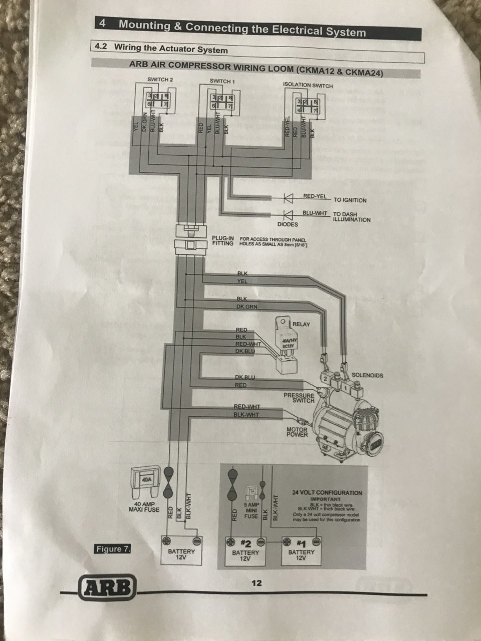

  16. Apr 18, 2019 at 12:26 PM
    #756
    bikesinmud
    bikesinmud Well-Known Member
    Mar 2, 2016
    #180050
    133
    Washington
    Couldn’t find my answer in the air compressor or electrical section.
    Need some advice on interpreting what I’ve got going on. Bussmann and AOB switches mounted, everything is ready to begin adding accessories.
    First up is an ARB CKMA12, then a front ARB locker.
    Am I correct in assuming Arb’s wiring harness is more than I need? Since The switches, relays, fuses are already in place?
    I should be able to hack into the Arb harness by eliminating the wires for the ARB switch and connect the ARB harness directly to the dedicated wires I’ve labeled for the compressor (orange/black) that comes off the bussmann, is this correct?
    Another question, since they include a relay and a 40a fuse, I should be able to use a ‘non relayed’ fuse from the bussmann? If it weren’t for the pressure switch It looks like I could hook power/ground directly to the bussmann but the pressure switch has me scratching my head.
    Slashaar likes this.
  17. Apr 18, 2019 at 12:40 PM
    #757
    JdevTac
    JdevTac Well-Known Member
    Jan 8, 2012
    #70234
    6,265
    Josh
    GA/WA
    2nd gen
    So just speaking to the 40amp fuse requirement, Bussmann circuits are rated at 30amp max for each circuit (80a for whole shibang)
    I haven’t wired an ARB tho
  18. Apr 18, 2019 at 1:22 PM
    #758
    BlackPearl
    BlackPearl Well-Known Member
    Apr 17, 2017
    #216527
    1,361
    Alex
    Toyota Tacoma TRD
    3” lift. Sway a ways 2.5 on 285 75 16 and much more
    I have the same set up, well except my relay box is different. You'd want to run the pressure switch threw the bussmann and the compressor itself directly to the battery. The locker you would wire the solenoid threw the bussmann as well. basically you run power to the pressure switch, it powers the compressor. Once it reaches the psi limit the compressor will shut off, then you would activate the locker.
    bikesinmud[QUOTED] likes this.
