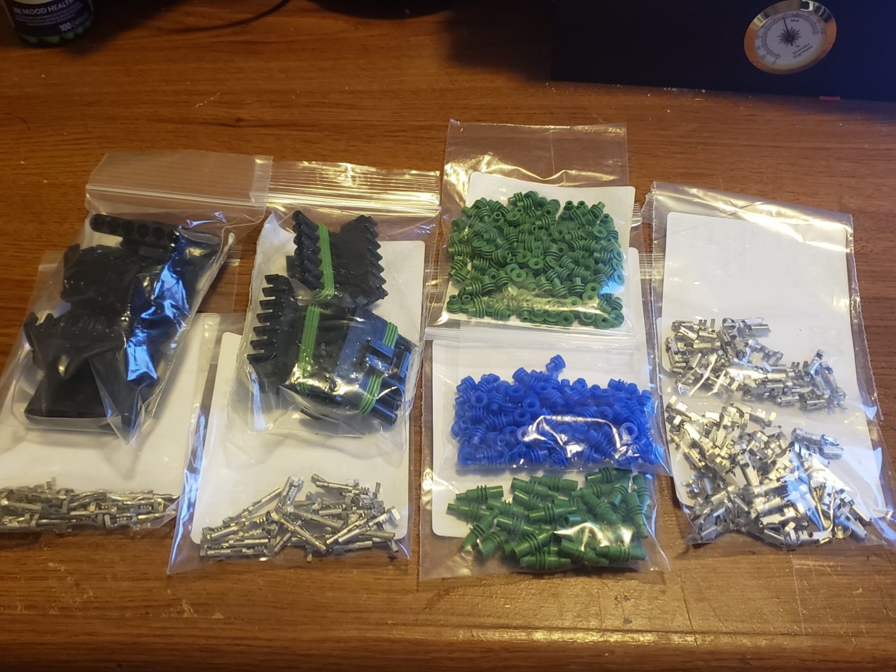

    I'm thinking about burning some money and ordering a normal one from Eaton. Since I purchased all of the plugs and needed terminals for somewhere around the tune of $50 or so, I figure I should stick with the general idea.

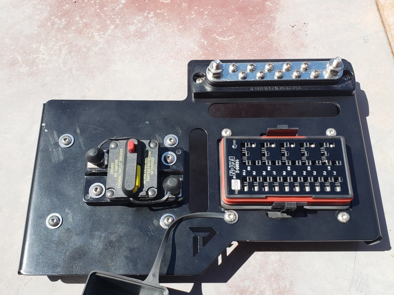

    The Power Distribution Center (PDC) closer to being finished.
    <previous work completed>
    I am expecting the wire and a few other little items to get the main panel finished up.

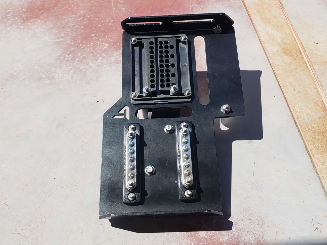

    Labor intensive project.. but highly rewarding.
    Some pictures of the progress. Got most of it finished. Still need to make the jumper to tie the bus bars togather, the cab switch harness and the battery cables.

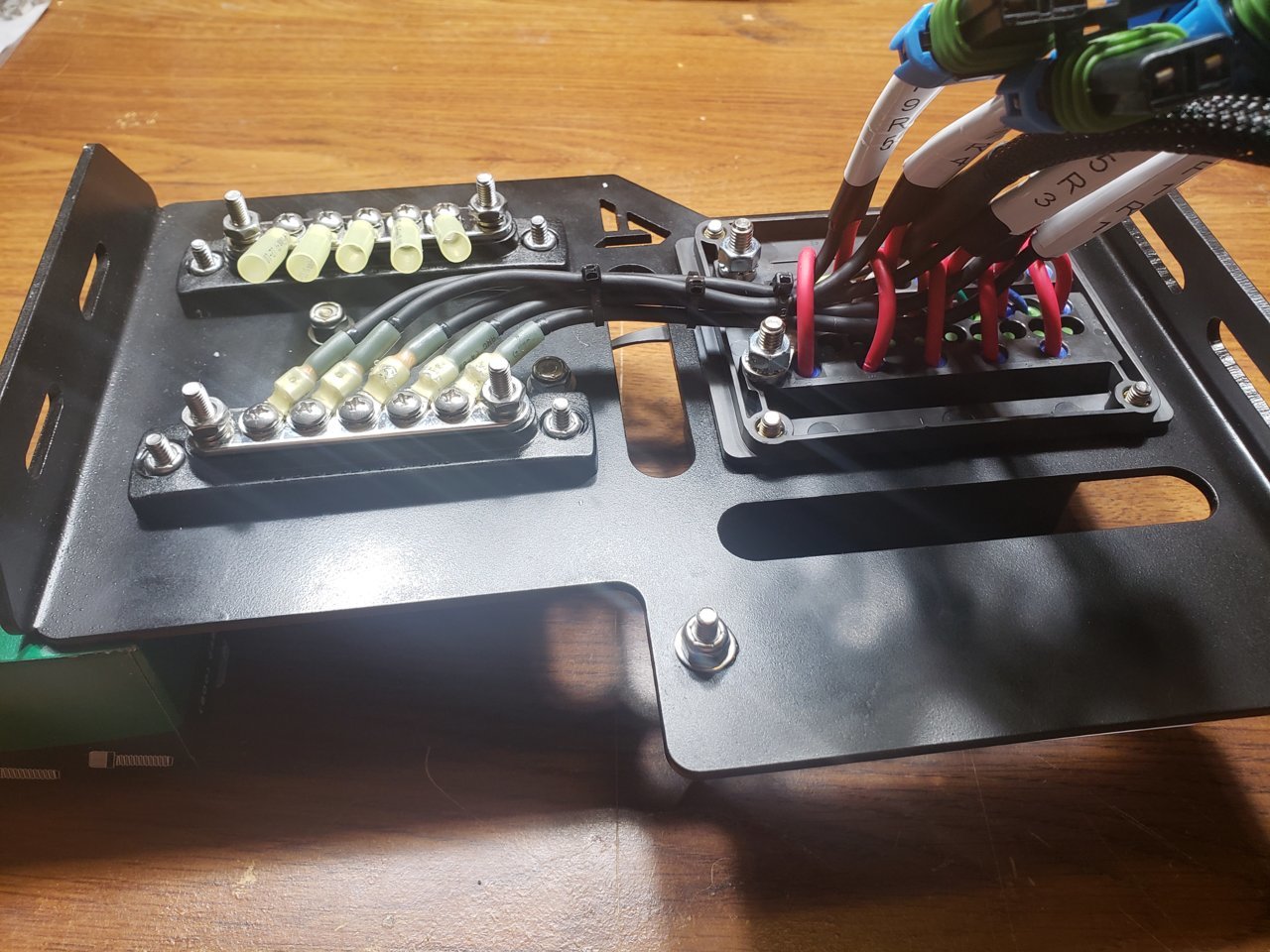

    First time wiring but I just got done with my Bussmann relay box. I hand only a single buss so I had to tweak the set up. Also changed the connectors on fused lines.

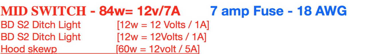

    I see the OP runs 10 GA wire from the RTMR to the accessory connector. I have different amperage for different switches ranging from 20 amps to 5 amps.
    Do I need to change my wire gauge from the RTMR to the accessory connector, or will 10GA work safely with no degradation of power to the accessory for that short 6" section?

    The op does that to maximize options so that down the road a change of accessory doesn't require reworking the rtmr since every connector and fuse/relay slot is capable of the full amperage and only the fuse needs to be chosen to match the rest of the accessory circuit wiring. Basically you don't have to plan every circuit going in, just add what's needed going from the connector out.

    Cool, I just wanted to make sure I don’t have to buy 5 different gauge wire since each of the 5 relays have different amps running to them.
