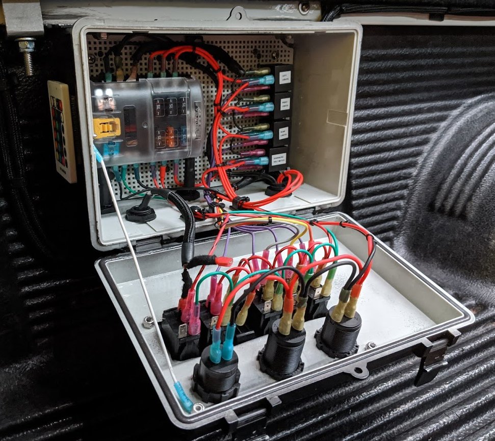

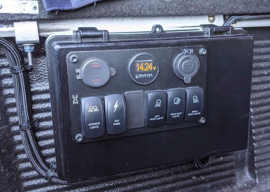

    Just saw your post. This is exactly what I did. I actually ended up doing it at the same time I put together the RTMR. @bagleboy was an awesome source of input. I still owe that guy a case of his fave brew. Basically, I have a 6 switch panel in the cab which controls Ditch Lights, x2 20w 3"x2" pods on the ARB Bumper, x2 20w 3"x2" pods on the Left, Rear and Right sides of my roof rack. There is one extra switch (Zombie Response switch) spot available for the next item.
    Ran Positive and Negative AWG 4 welding cable from a 100A BlueSea Breaker (this is separate from the 80A breaker for the RTMR) at the battery to the Bed of the truck where its hooked into a BlueSea 6 circuit fuse block enclosed inside of:
    https://www.amazon.com/gp/product/B07TMQRVVG

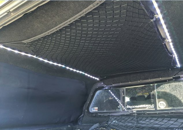

    Have Sylvania Mosaic LED strips which provide light inside the cap. Additionally, x2 Quick Charge 3.0 outlets, a BlueSea Volt Meter and a power adapter plug mounted to the outside of the enclosure. Switches on the outside control everything.
    So the way the rack lighting is wired on the cab switches is the signal/Accessory wire (#3 on the Contura XIV switches) is routed to the bed. Once in the bed, I have it tied into the #3 wire on the Aux Fuse Box switches using something similar to this:
    https://smile.amazon.com/Ancor-230613-Electrical-Male-Female-Adapter/dp/B000NI1G0C/
    For the cab side relays -
    The aux fuse box #3 switch wire is connected to pin #85 on each rack light relay (each relay handles x2 pods per channel - LEFT, REAR, RIGHT).
    Relay pin #86 is routed to the ground bus.
    Relay pin #87 is routed to each rack light + channel
    Relay pin #30 is routed to a fused power slot on the Blue Sea fuse block
    When either switch is activated, both switches will light up. I like this simply for the redundancy visual. Say its daytime and something were to bump the bed switches, the lights come on and the switch in the cab would be illuminated. I'd notice that way before noticing the rack lights on during the day.
    Hope this helps. If you have any q's feel free to shoot me a DM and I'll try to answer/help.
