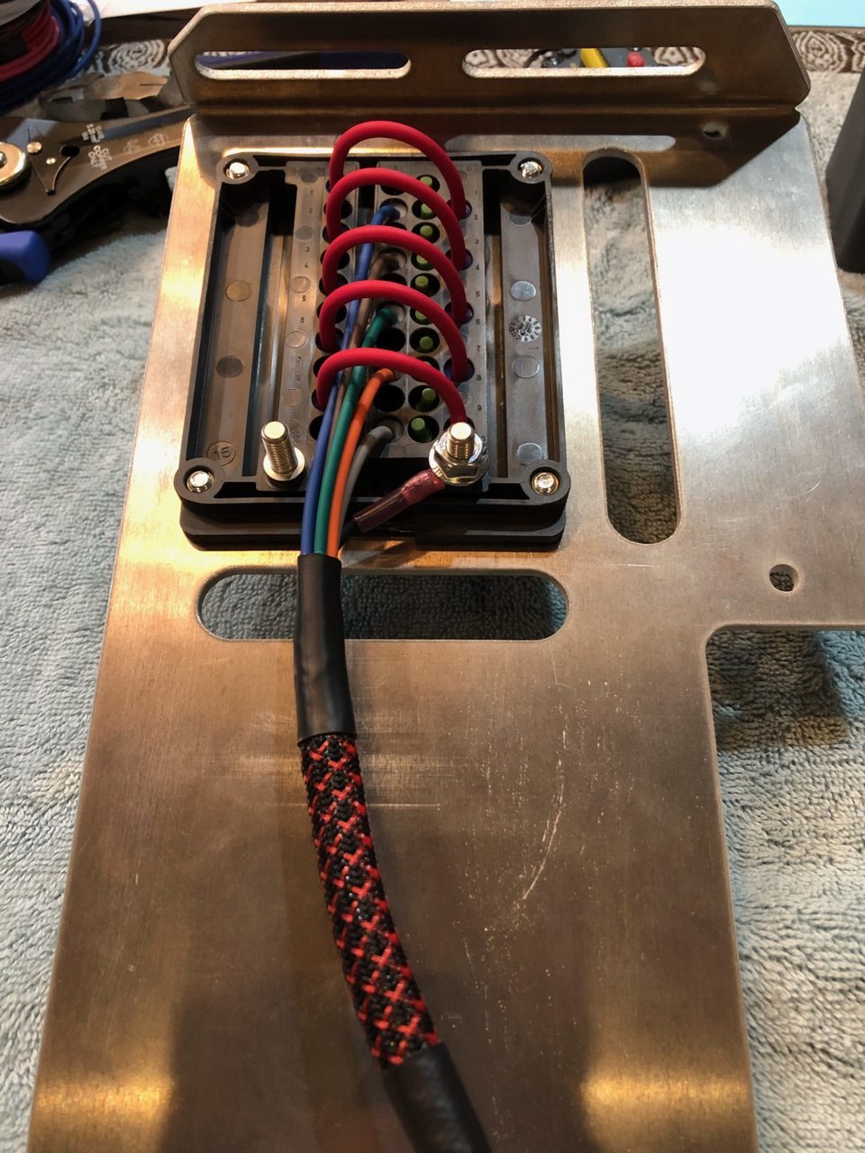

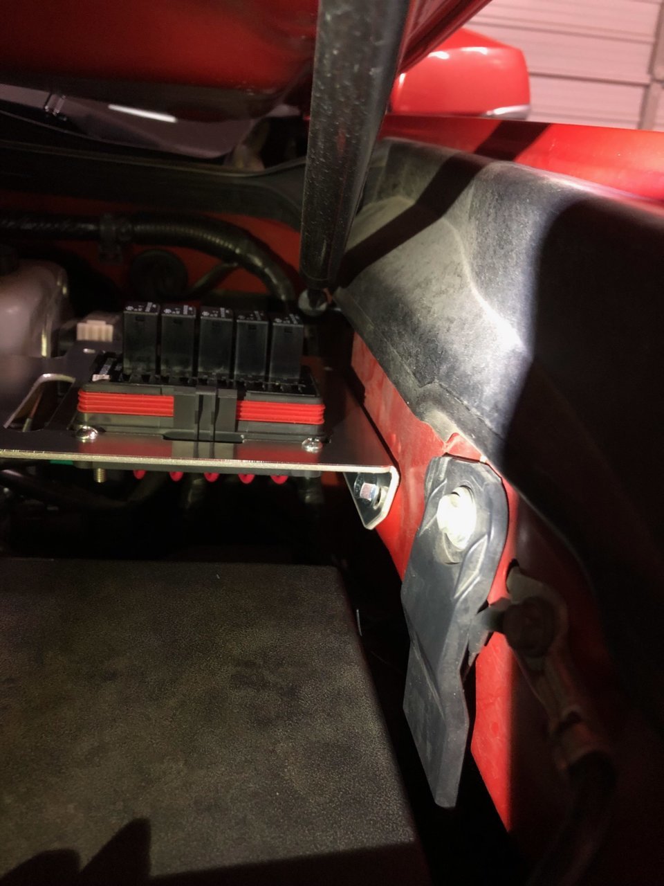

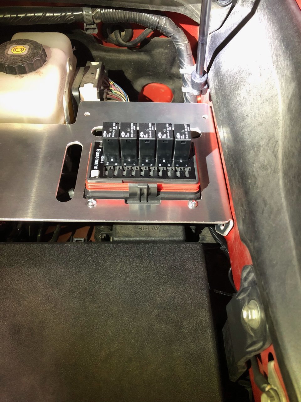

    Been humming along building my wires and harnesses. Decided to do a test fit to the truck to determine which way I wanted to route my accessory connectors before building them. Damn... the Bussmann collides with my hydraulic hood struts. Did anybody have and solve this problem?

    Maybe get yourself some 3/4” x 5/16” id bushings and 8 x 30 mm bolts to space the tray off the sidewall more?

    Hmmm, not a bad idea. I'd have to check and see if that would challenge the support arm and make it not fit. I little bit of Unistrut might do it too. Of course... then it would look like a backyard mechanic did it :)
    But your bushings idea might be the cleaner solution. Can I conclude from your comment, that the thread pattern for the fender wall is 8 x 30?

    Thread pattern is 8 x 1.25 and I figure you’ll need it about 30 mm long. Edit the plate is ~3mm thick plus a 20mm bushing(~3/4”) is 23mm so 25mm would be too short but if a 1/2” x 5/16” id bushing would work then 25 mm bolts would be long enough. Check both that and how much space you have to the reservoir. Might also help to slide the tray closer to the stock fuse box.

    There might be just enough room. Wouldn’t want to be up against the reservoir.

    Truth. You might need to trim that side to get enough clearance. Not even sure that 3/4” bushings would be enough with the Bussman cover installed. One other option is a plate that has both holes for the tray and a second set of holes for the 8 mm bolts. That would allow you to lower the position of the tray.

    Thanks for the offer Bagleboy! I'll look at measurements for that tomorrow. From recollection, the tray slightly overlaps the 3rd gen fuse box so I'm nervous it won't drop much before running out of room. I made some 'variable' spacers with a bunch of 5/16 washers. I ended up with 9/16" before I just cleared the hydraulic strut. But that put me up against the watzamujig handle on the reservoir. So I'm not sure I can make the tray work as is... even with adapters. Powertrays seems like he's willing to help out if a different tray design is needed so that's good to know.

    The plate could also have front to back offset as well but likely you’ll encroach on the front of the reservoir in that direction as well. I’m sure there’s a solution. Nice that Powertrays is willing to help.
