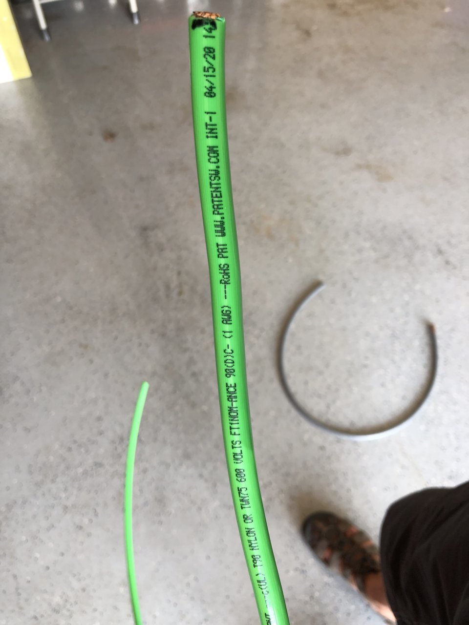

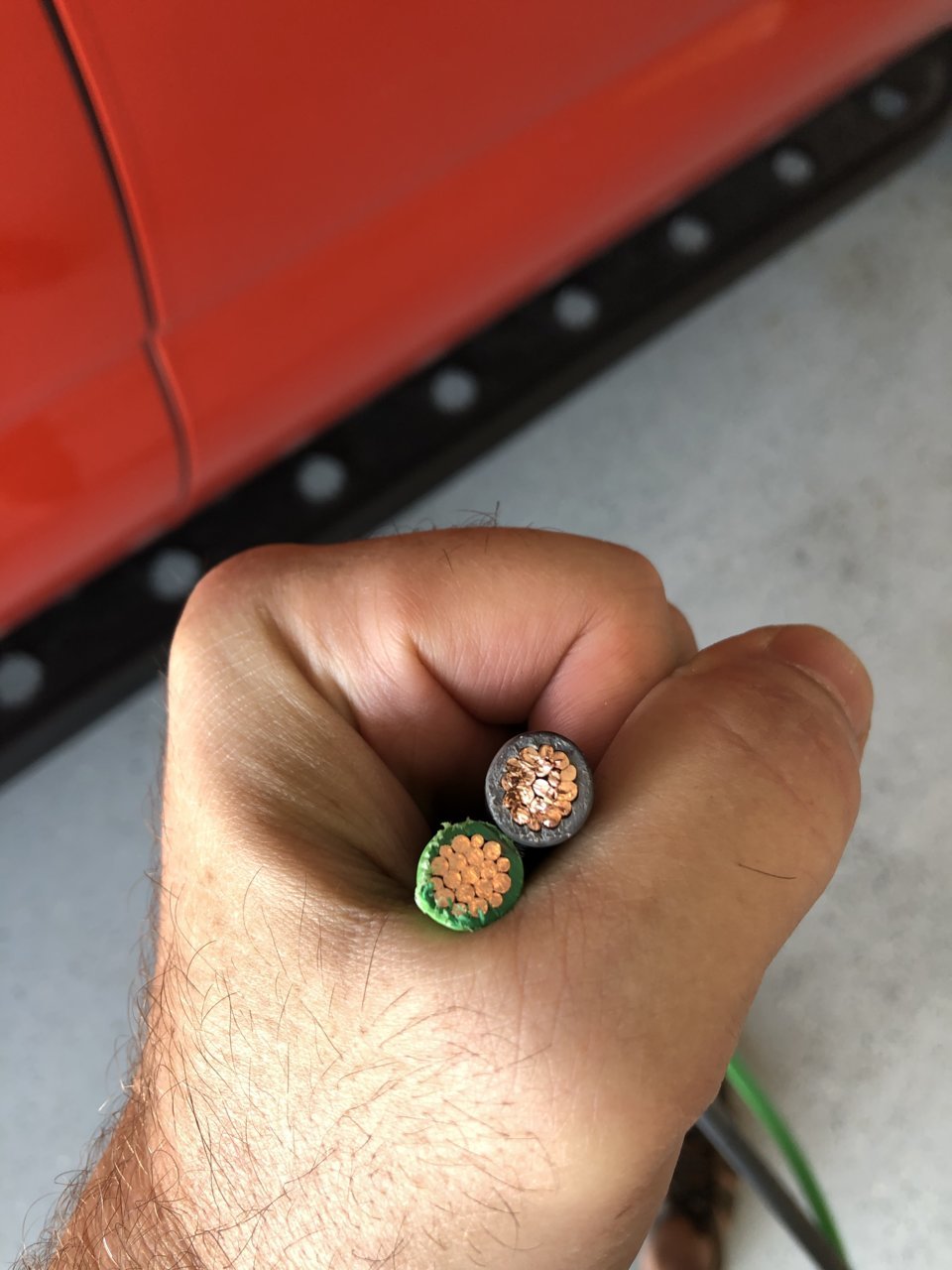

    Hey fellas, now that the weather is cooling down I want to finish this project. My tray is built, but I still need to make my accessory cables and battery connections. I grabbed some scrap wire from a project at work and am wondering if anyone can give me a thumbs up or down on it. This would be in lieu of the welders cable that everyone is using for the 100A breaker and direct connections to the battery. Pics below.
    <edit>. Looks like it’s 1AWG, so that should be plenty of bandwith. :)
    Can anybody speak to whether this is ok for the engine bay? I’m not sure about the temperature resistance of the coating.

    90C seems a bit low. I’m not really comfortable recommending that usage even with high temp wire loom to surround each piece. High current cables with inadequate insulation just strikes me as a recipe for disaster.

    Appreciate it.... that’s what I was looking for. These are from equipment at 125A 480V 3 phase. 90C converts to 194F. I doubt it gets quite that high under the hood, but 150+ for sure. Probably best to order the recommended wires then.

    Exhaust pipes are a lot hotter than the block temp and these installs are usually closer to those than they are to the radiator. https://mechanicbase.com/engine/how-hot-does-an-exhaust-pipe-get/
    Edit- there’s a good reason for using high temp insulation in the engine bay.

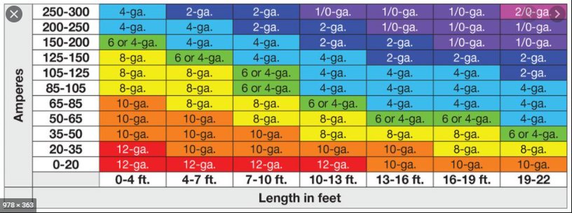

    If I look up ampacity charts for 4awg wire it says 70 amps but everyone on here seems to be using 80 - 100 amp circuit breakers. Wouldn't the breaker have to be less than the amp rating on the wire so it breaks before exceeding the amp rating of the wire?

    I'll take a quick stab at this. I think the primary concern is resistance rather than heat here? Because within the engine bay we'd be using thermally protected cable and subject to external heat anyway so the temperature of the wire itself is a lower concern than it's resistance? I'm sure someone with more working knowledge can step in with a better explanation.
    Based on the charts which take distance into account, a short 12 inch jumper of 4 gauge is well within operational range of any reasonable circuit breaker. Why use 4 gauge instead of 2 or 1/0? Most likely because it's smaller and more flexible, also more easily available and lower cost.
