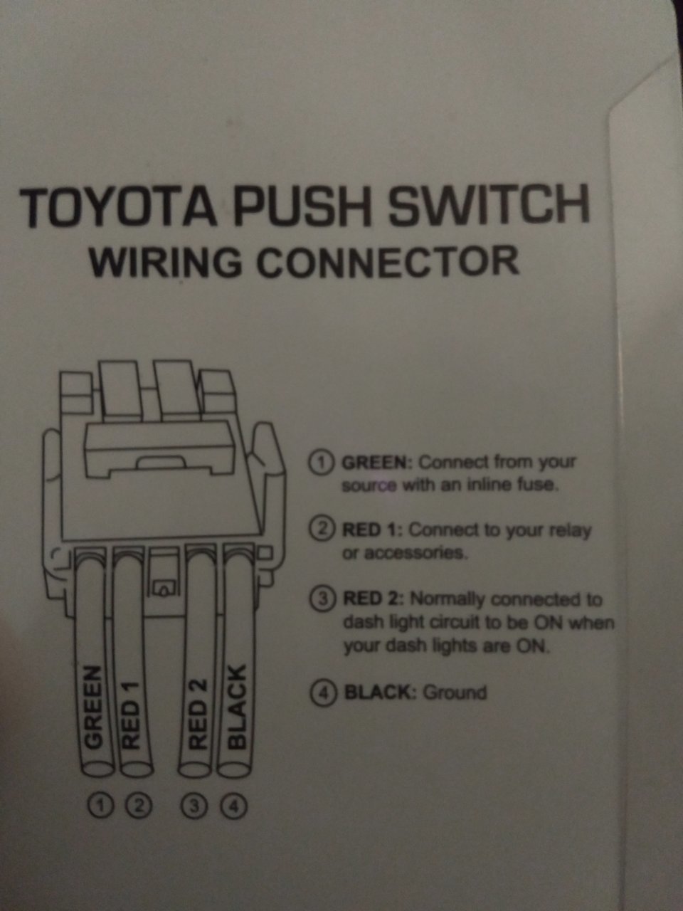

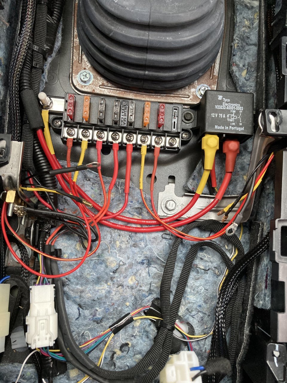

    One add-a-fuse can supply power to all the switches if they’re just for relay activation(~100mA per switch), otherwise you may need independently fused switches and probably better switches since these are typically limited to <3A. The source you choose for the add-a-fuse(s) should reflect whether you need always hot or ignition hot for the accessories. My rear window slider taps the door lock fuse(always hot with switch mounted in door armrest) the center console switches share power from an add-a-fuse that taps a low amp fuse and supplies a small fuse panel in the center console. The slider switch gets illumination power/ground from the window control harness so only two additional wires had to go through the door grommet. All other switches get illumination power/ground(red 2), black) from the dash illumination circuit so they illuminate with headlights on and dim just like the other switches. I bumped the resistor in the slider switch to 20k ohms which makes it a good match for the only other led in the armrest controls which also isn’t on the dimmer circuit.

    Yeah, the bussman is really overkill for what I currently have and what I have planned. However, I wanted to future proof (or at least make it easier) to add things as time goes on. For now, the single switch is what I need, and I'm planning to wire it as you described, just for relay activation and mimic the backlighting piggybacking off the adjacent OEM switch.. I'll maybe add one more switch but after that I would look at a switch panel, but I'll have the harness already in. So adding a switch panel shouldn't be too big of an issue.
    The last couple of days I've been working on building harnesses, swapping out headlights and that harness so I can run the upgraded bulbs, installing a light bar and now finishing up the bussman wiring. I'll be finalizing the bussman wiring tomorrow.
