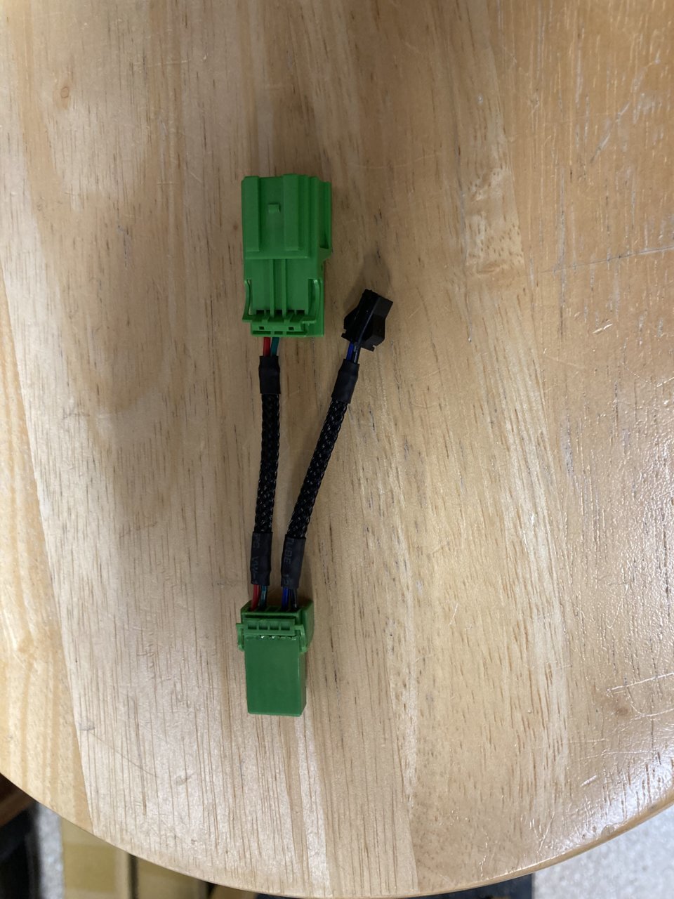

    If all the switches(or almost all) use the green plugs I depin them and remake them with daisy chain for the 3 common wires then use whatever molex can carry those plus the switch output wires. A 3-gang switch bank would have a 6-pin molex, 4-5-gang an 8-pin molex, etc. basically turns the green plugs into switch backs the way the op described.

    I use the time spent on waiting to mull it over but I wish it knew about that Digikey link a few years ago since it definitely organizes better this way. Also read up on dash dismantling, door wiring, or any other areas I need to access to ease the process.

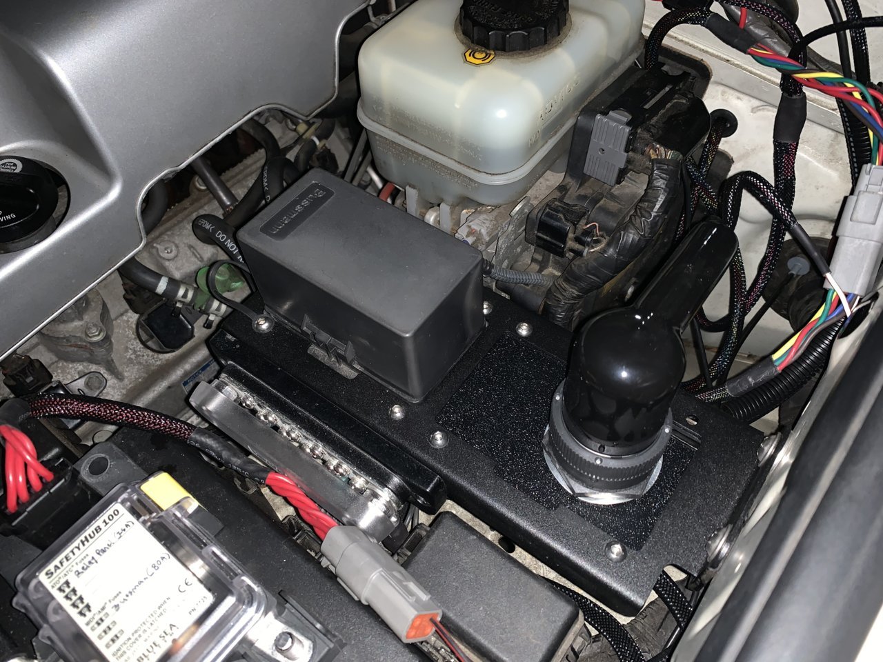

    I recently redid my entire panel work in my current Toyota. This time I wanted to avoid the semi-rats nest look and went with a Deutsch bulkhead 16pin 10-12awg connector and a Shrockworks double rtmr mount. Threw the 2x 5pin weatherpacks in the garbage. About as clean as I have ever made it look. Still need clean up some slag over by the firewall. Got some Deutsch connector mounts to actual affix them rather than let hang.
