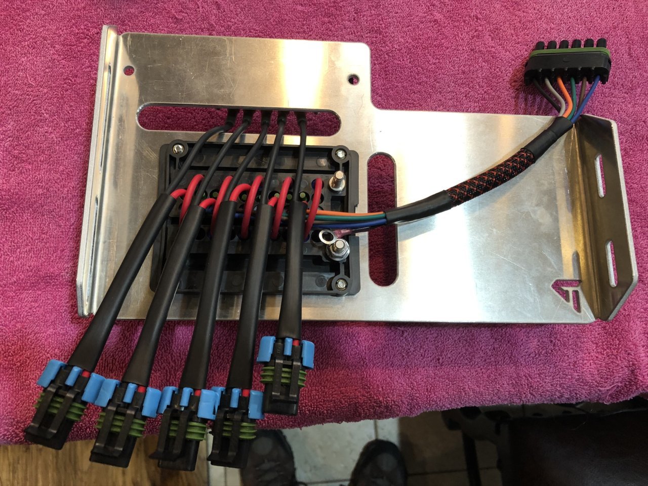

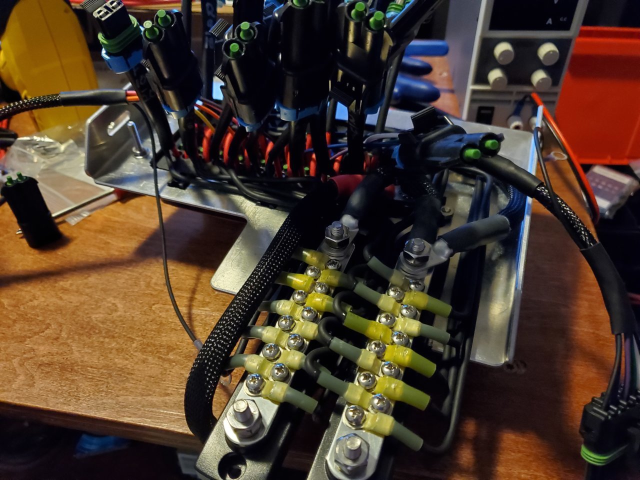

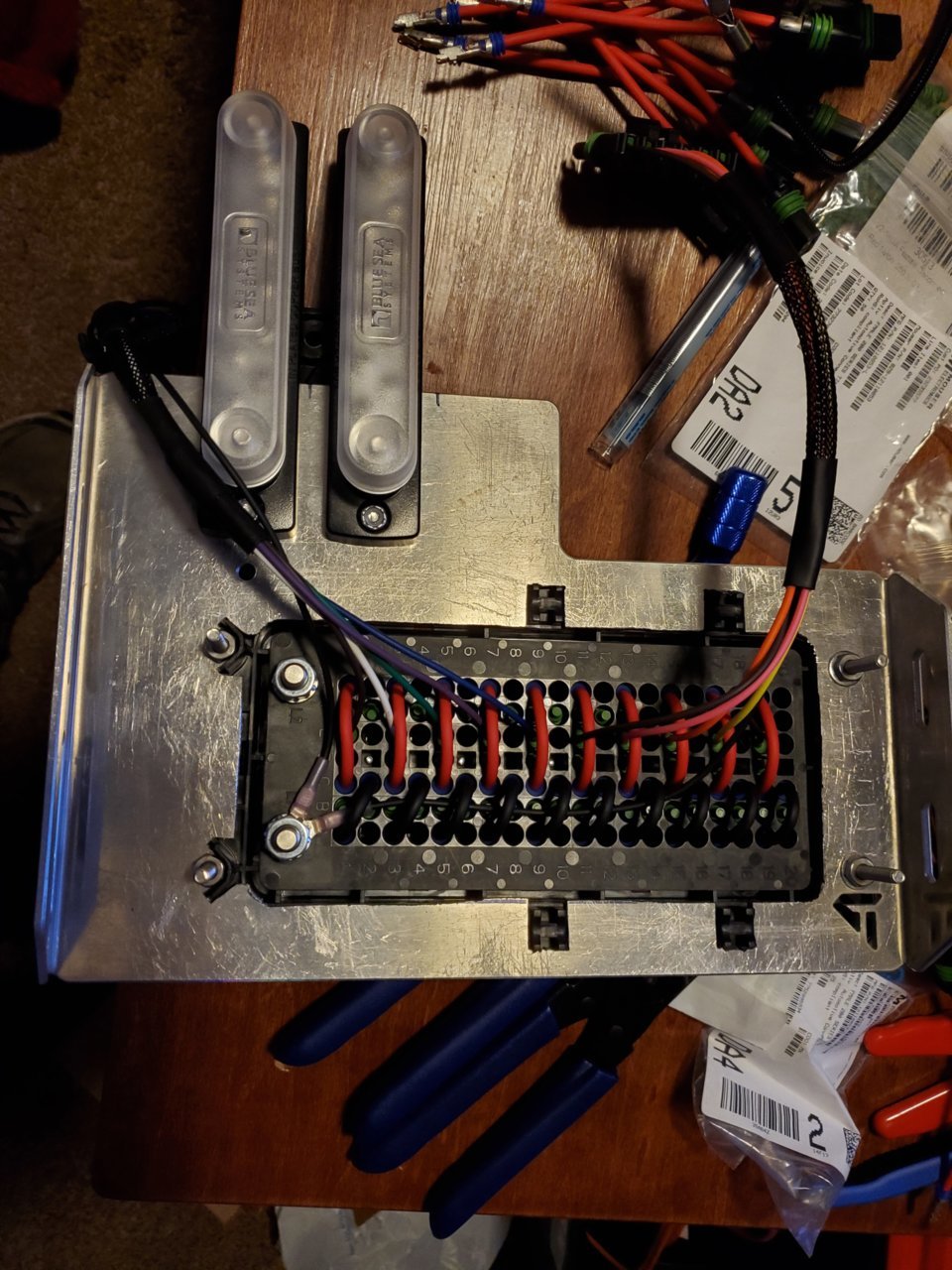

    I could use an extra set of eyes on my setup as it currently stands. The RFRM does have an internal busbar but not one that overlaps with any of the relay pins. So I figured I'd just make jumper wires to get to the other side of the fuse plugs then use a fuse to reach the internal busbar. Same concept as with the power.
    Right now, I've got two 6-way connectors, each with 5 relay circuits and a ground. I've made 10 accessory connections (not shown) for the relay and the fuse side of the house. I'll plug the rest of the cavities.
    On the mounting panel, bottom side, I have the two external busbars. I'm hoping there's enough space to get all of the terminal rings in place without too much tangling. The spacing of the busbars allows me to use a single pair of screws to mount the busbars on the bottom and a 100A circuit breaker on the top. I test fit it all in the truck and it looks good, granted there's still more wires to put in place.
    Aside from the modifications I had to do for mounting and using an RFRM, I'll be following the rest of the guide as is. Have I made any mistakes in wire routing? Or anything else.

    I think it's ready for installation. I tested all the relays and heard satisfying clicks and hooked up my cheap rock lights and turned em on with my power supply. Everything appears to be working. I will be installing SDHQ terminals which will be the attachment points for this unit.
    My wiring is pretty messy given space constraints. I will probably remove a few of the unused fuse accessory leads. Does anyone see anything I've missed with the way I've routed everything?

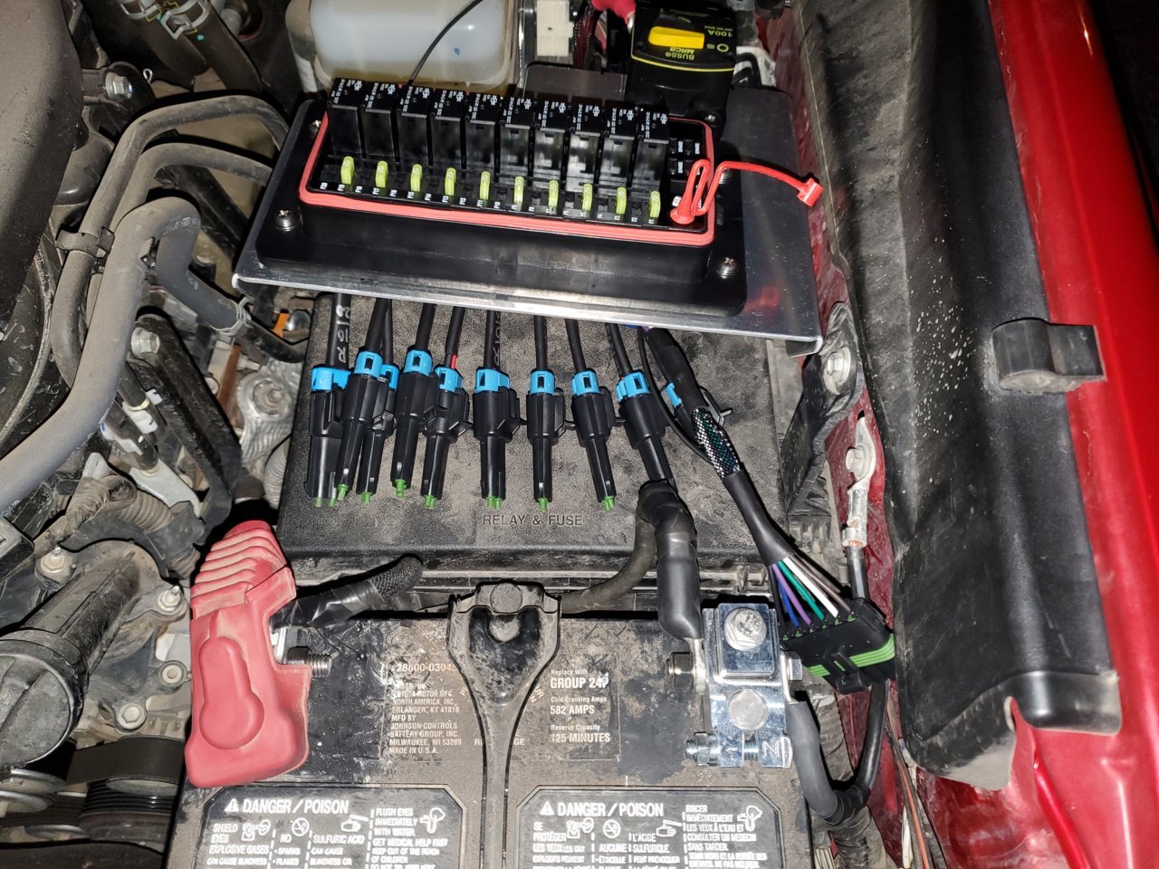

    Well here's something else to see. Not enough space:
    I knew it'd be tight (so to speak) going into this but was hoping I could work some magic. I could probably get things juuust right to have enough space but then reaching the accessory plugs would be near impossible for some of them.
    As of right now, I see two options: remove some of the accessory cables, particularly the fused ones, to free space and hope I can still reach what's left. I got the RFRM because I wanted more relay spots so I'd like to keep all 10 there if I can.
    Or...make new wiring for all the accessory leads and route them to just behind the headlight, between the battery. There's loads of space there. But that means more work, more wire, and a further distance to route accessories.
    I don't think I can swap this setup over to the passenger side without finding anotherounting tray since it pokes forward into the engine air filter box.
