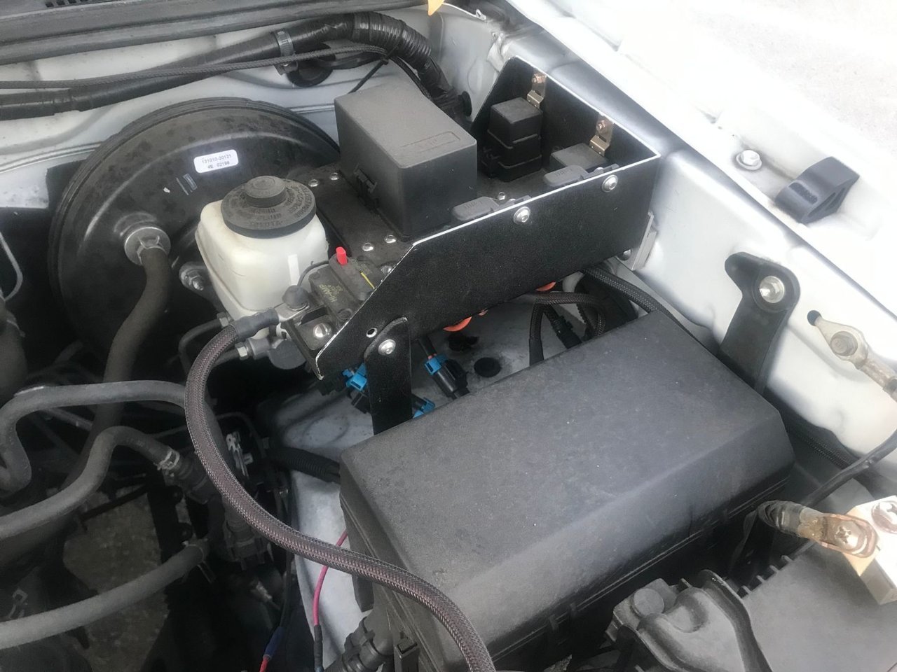

    I sort of hinged the tray so I could more easily get to the connectors. I put in a leg down to the rear oem fuse box mount on the fender and notched my tray holes to be able to slide the fender side up and off. I couldn’t see being able to get under it to plug anything together otherwise. For me it was less about fitting the panel and more about fitting the fan of wires coming from it.

    I'm having a tough time picturing the support leg you mentioned or why the fender side (black plastic piece?) needs to come off. Probably obvious once I have a visual. I didn't see it in your build thread, but I'm guessing you've posted it in this thread (or the aux panel thread) before?

    My tray is 1/16” aluminum so the leg just takes some strain off the fender side. It’s an afterthought as are the slotted holes so they’re not shown anywhere. It lets me flip the tray up and push connectors together then drop the tray back down again.

    See if I can do this.
    I have it mounted so it sits as high as possible. You can see the leg at the left end facing you. There’s a 1/4” thick aluminum plate bolted to the fender with another 1/8” plate attached to it. The 1/8” plate has the slots. Against the fender are my 2-40A relays and peeking over the top of the foreground side are the fuse holders for two 40A fuses. Breaker just left of those and neg buss bars underneath. You can also see how I cut down the oem neg battery clamp to work on the Xscorpion clamp. Still have a couple wires to transfer.

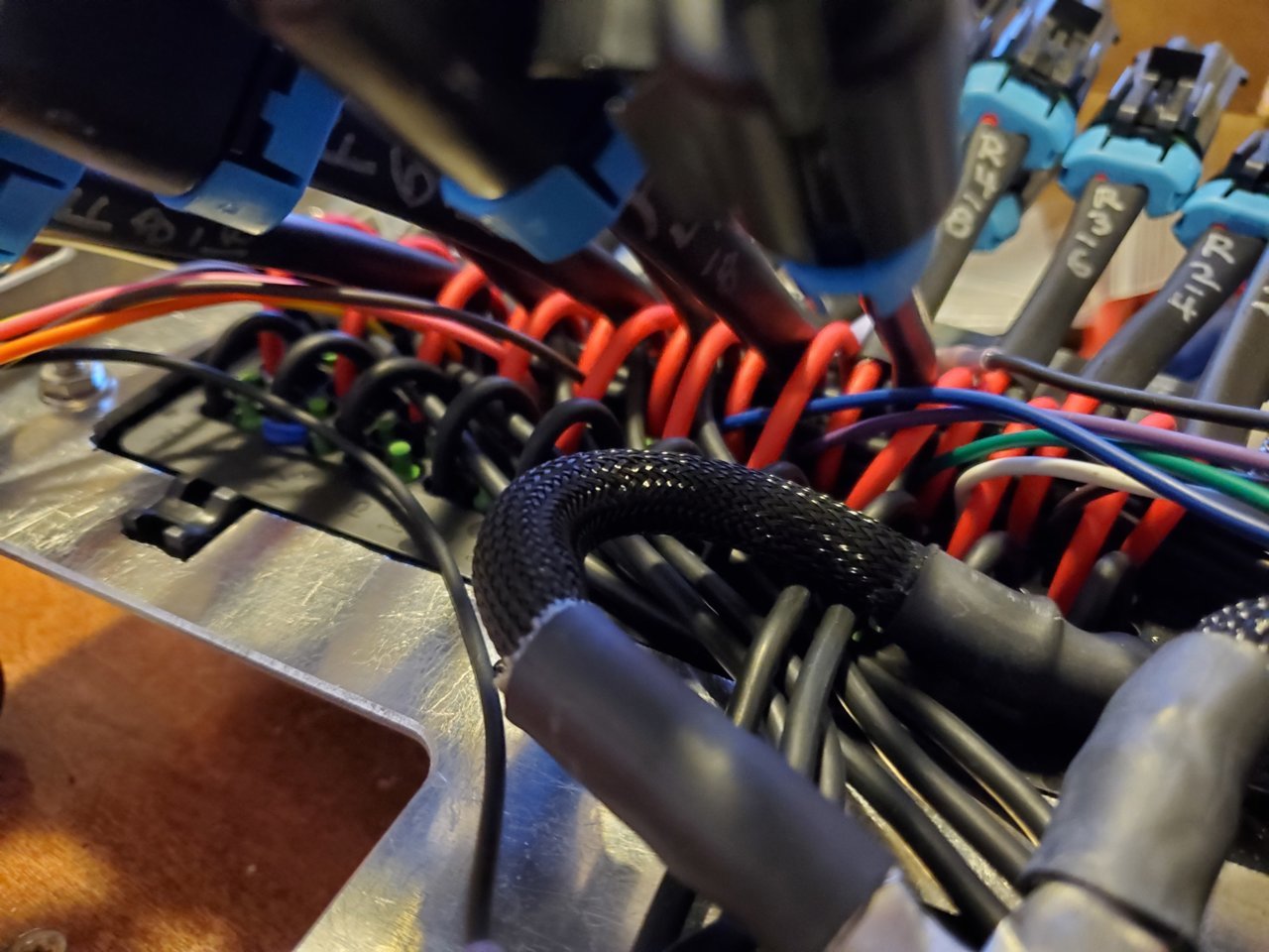

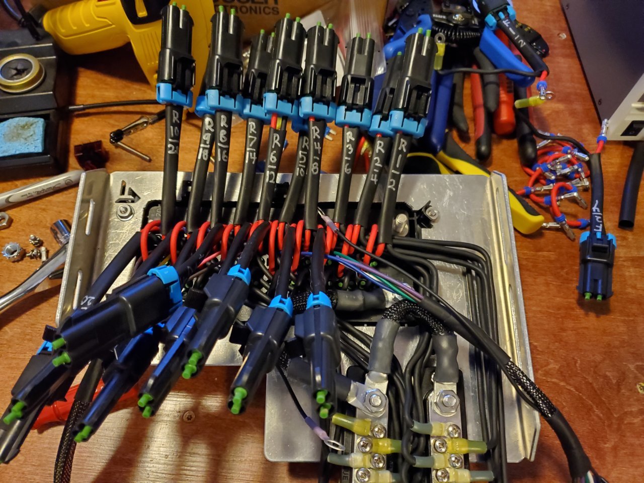

    I never thought of raising the mount itself. Brilliant idea! I appreciate your photos. They are a ray of light poking through the end of the tunnel.
    I removed 2 of the fused accessory leads and then rerouted...everything. I swapped internal busbars for the ground (was on the right, when looking at the bottom, matching OP's guide) because I was nervous about all the ground cables running near the powered busbar post. I used that opportunity to get more creative with routing and spacing. I haven't test fit it yet to see if I actually improved anything but if nothing else, it was a fun puzzle. Also my fingers hurt from pulling and pushing on the wires.
    I think I've alleviated all the concerns I have as an amateur electrical dude. Things like vibrations rubbing cables bare and causing shorts, or routing sucking, or rubbing against something, etc. Do you see anything else that is worth another look?

    No problems per se but two things I did differently were I made my connector wires in different lengths so the connectors themselves aren’t all in the same place. The other is just as tacozord in that the switch trigger wires are routed in the jumper “tunnel” so they’re already gathered as the come out the end. Yours looks super clean. Nice work so I hope you can work with it.
