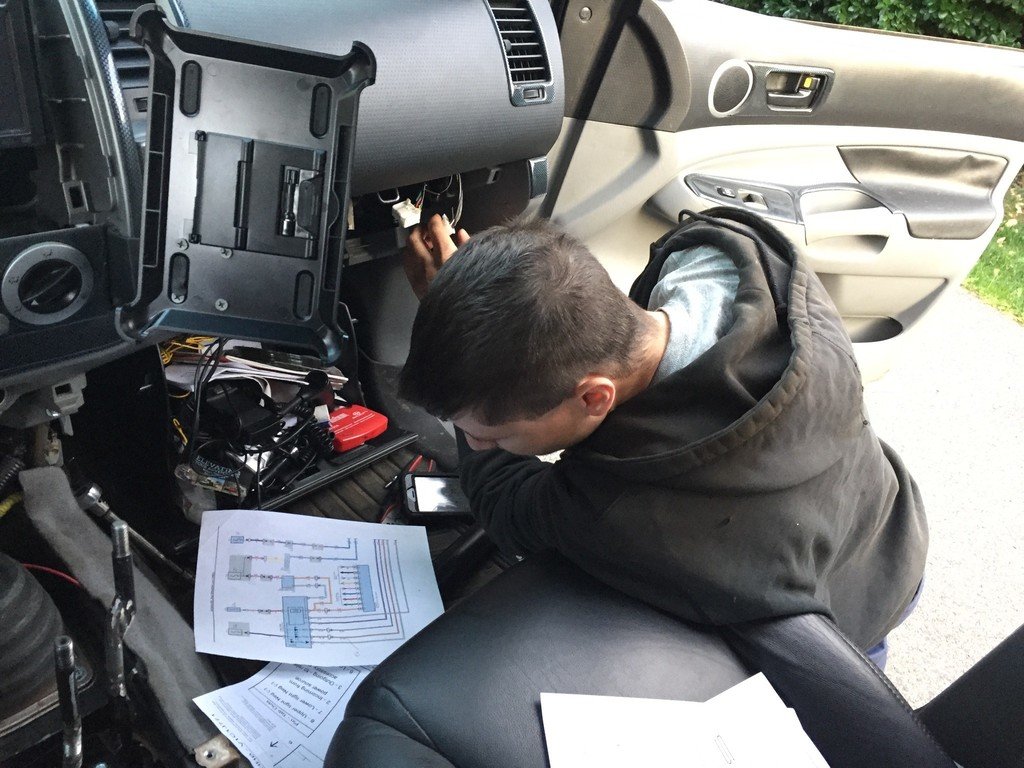

    6B5CADF5-1E3F-4150-A980-B581E8365C02_zps_44eff394c09a7de8a937e75896d0efae81100ecb.jpg
    2F32CAC1-1819-4F72-8047-D13C07C22E01_zps_87ff122ee436472bab73f63b8568d85c36c9d958.jpg
    31FFB1EA-31CE-4513-A4B1-19017C2DD3B3_zps_9a1a6673801ec03b1c3cb8c77842ebc42d175ae9.jpg
    @PSU Taco85 Ant is a fucking wizard. :cool:

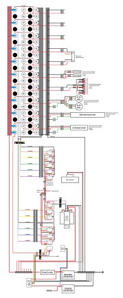

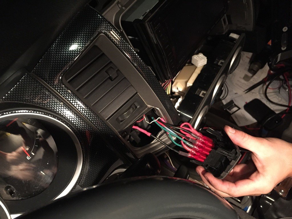

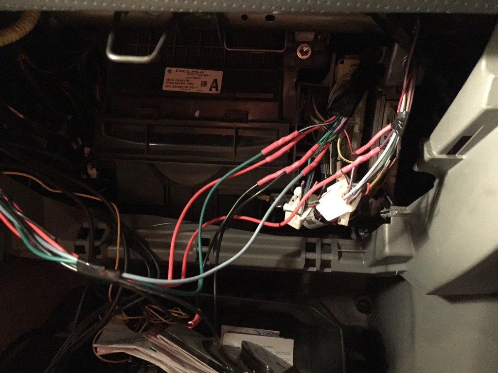

    Here's mine I'm going to be installing eventually, bit of work to do, winch however may need to be separated from the circuit
    Complete with
    10 Relay Switches
    - Switch for ARB Air Locker Manifold Solenoid 1
    - Switch for ARB Air Locker Manifold Solenoid 2
    - Switch for x2 Rear lights
    - Switch for x12 Rock/Wheel Well Lights
    - Switch for x2 Wind-shield Mounted Ditch Lights
    - Switch for Roof Mounted Light Bar
    - Switch for Bumper Mounted Light Bar
    - Space for an additional 3 Switches (Below Climate Controls)
    2 Direct Switches
    - Switch for ARB CKMTA12 Compressor
    - Retains Factory Fog Light Harness wired to after-market Fog Lights (Optional Factory Switch)(Switch Location Moved)
    3 Momentary Switches
    - Ditch Lights Momentary Dimmer
    - Roof Light Bar Momentary Strobe/Dimmer
    - Bumper Light Bar Momentary Strobe/Dimmer
    - Retains all other Factory Switches (Traction Control, Bed Plug(Switch Location Moved), RCSA)
    - All Illuminable switches wired to Ignition
    - All Illuminable switches wired to Dimmer Dial
    - Dual Batteries
    - Dual Battery Automatic Charging Relay & Isolation
    - Manual Control Switch of Battery Linkage
    - Auxiliary & Starter Battery Voltage Indication
    - Winch Wired

    Nice. I wish your pic was a bit bigger so that I can see the details. My eyesight ain't the best the older I get. :eek:
