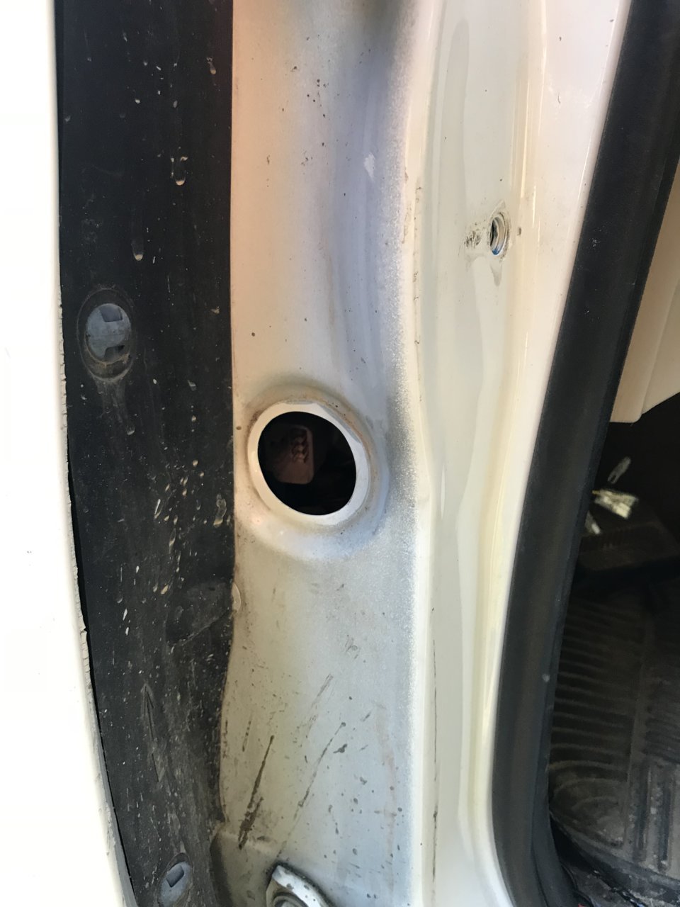

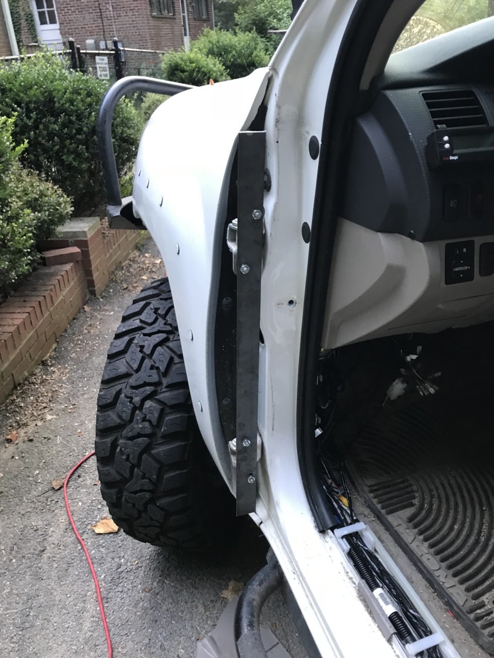

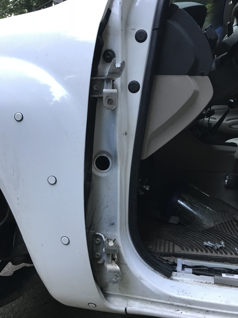

    This was as far as I got for the day. Went and picked up eight M8x1.25 bolts so I can weld them to the flat bar, making install easy and I also notched the hinges for solo install. Without doing this it would be impossible alone.
    Lessons learned:
    1. Whoever said “just remove the kick panel and unplug the wires. It’s soooooo easy.” Is a goddamn fucking liar. I haven’t been that frustrated in awhile trying to unplug and reconnect the wires.
    2. There are two connectors to the door, and they’re taped together. Cutting the tape and allowing each one to move independently is what ultimately let me reconnect them...after fighting them for 10 minutes.
    3. I’ll need to find something to plug this hole when wheeling. That’s where the wires feed into the truck.
    4. Use wider bar stock next time. I have 1.5” and 2” or 2.5” would be better.

    I'm fairly certain you can buy body plugs at parts stores.

    This should plug the hole.
    https://www.amazon.com/OTBBA-Silico...1530578379&sr=8-1-spons&keywords=douche&psc=1

    Thanks! I’m gonna measure it later on and try and find something. Worst case I’ll buy a factory rubber tube wire grommet thing and hack it up.

    So I custom cut my hinge plates to follow fender contour and wait for you to post what size rubber grommet you got to fill the whole.

    I’m mildly confused as to what you’re saying right now. All I gathered is you wanna know what grommet I find to fill the hole.

    Because half of the dialogue was in my head. If I cut the contour and put a lip on it similar to what the door has it would cut down on the gunk.
